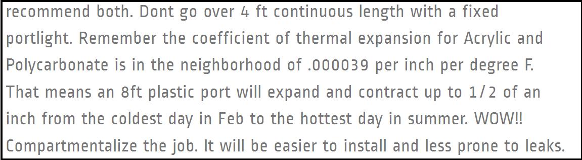

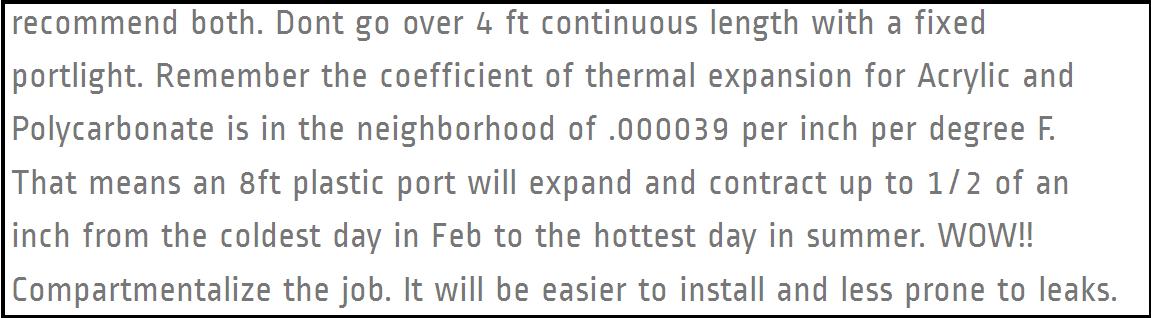

Interesting article (More.) with the reference to maximum portlight size:
I guess that's why I seem to develop a small leak(s) every 3 - 4 years in the front portlight.

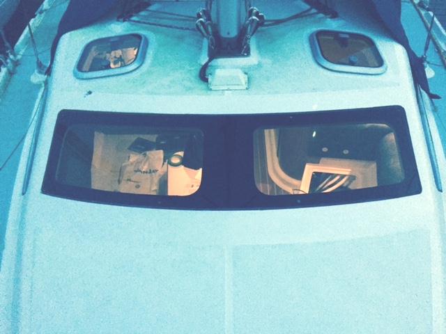

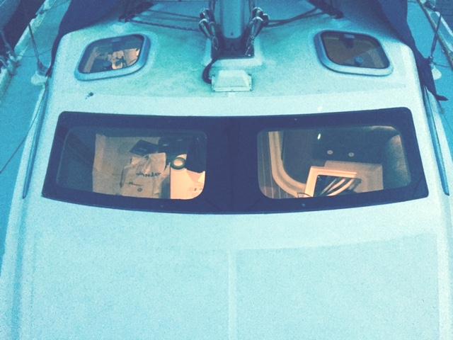

No measurements on hand but that piece of acrylic is about 6-7 ft. long. Got to wonder what the cabin dimensions are doing during that time but just not a good idea at all. Aw, crap :cuss:.

Yes, but cast acrylic has a thermal coefficient of expansion of 45 . . . worse than polycarbonate which is 39. Also, this is for clear materials. Put a tint to it and the thermal creep essentially doubles! FRP's COE is 14, about 1/3 of polycarbonate. All the more reason NOT to use fasteners for attachment. VHB tape w/ DOW 795 for fixed lights if possible.

But differential thermal expansion ................... when an unstoppable force meets an immovable object, all bets are off. WAAAAAAAAY OFF.
