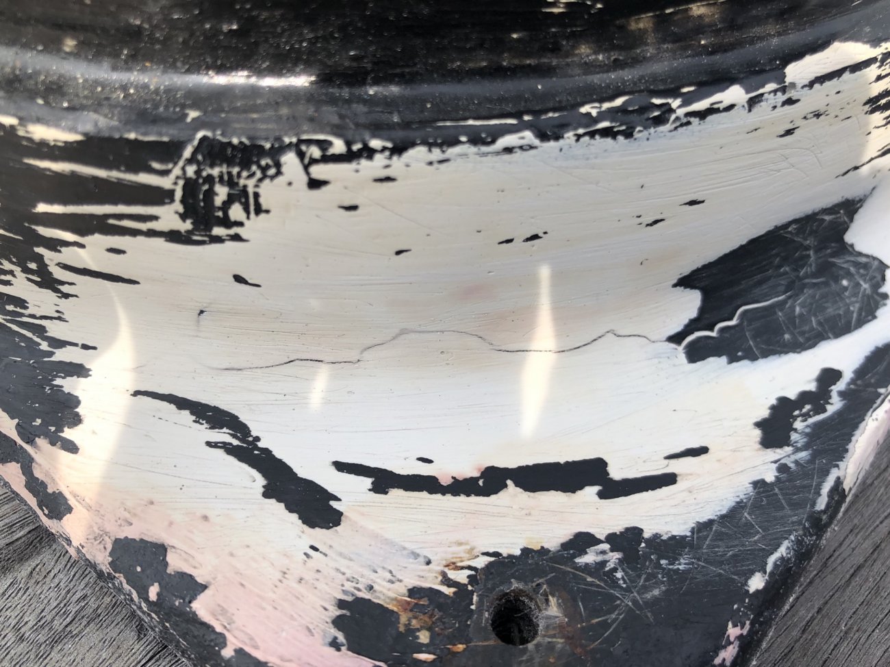

This original 2007 muffler has less than 400 hours on it. It was weeping water just above the mounting screw. After sanding the area, I found this hairline crack. Repaired yesterday with Marine-Tex and will test this weekend. Has anybody seen this before?

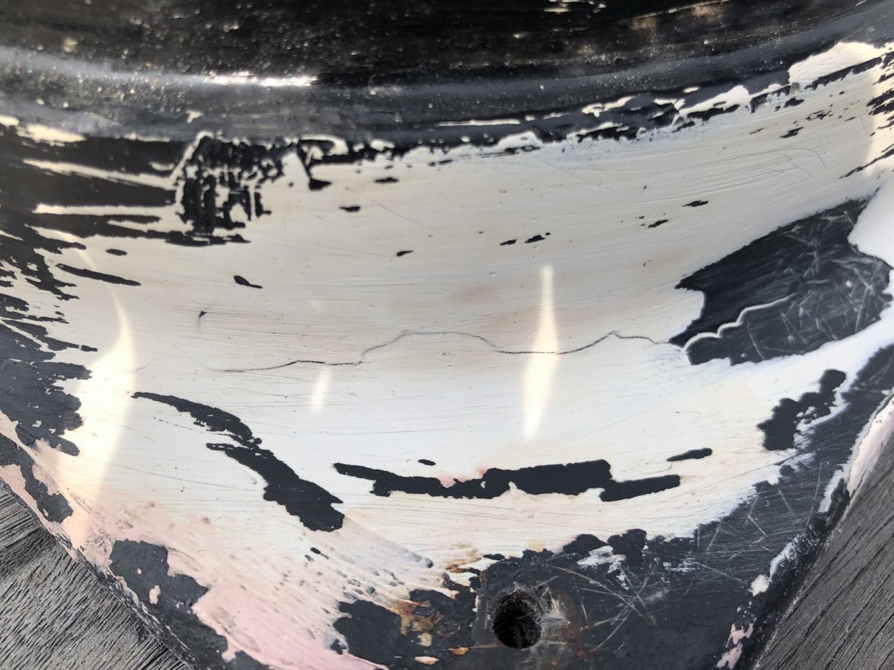

View attachment 165459 This original 2007 muffler has less than 400 hours on it. It was weeping water just above the mounting screw. After sanding the area, I found this hairline crack. Repaired yesterday with Marine-Tex and will test this weekend. Has anybody seen this before?
Updated: Marine-Tex repair failed. Having a pro repairing it this week ...

Cool what was the process and cost compared to new?
Apr 5, 2019
44
Catalina 310 323 Brooklyn, NY
Found a local fiberglass muffler repair guy through the manager at Summit North Marina, DE. $400 which is same cost as new But it was done in two days instead of four to six weeks.

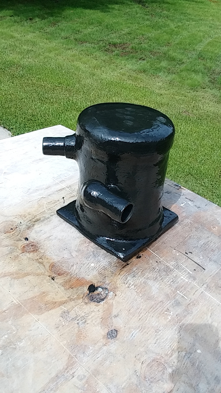

A bit of polyester and FG tape would have been less than 10% of the cost and very easy repair in the boat. Mine cracked around the inlet tube, about a hour job to fix it up.
Looks nice all painted up.
