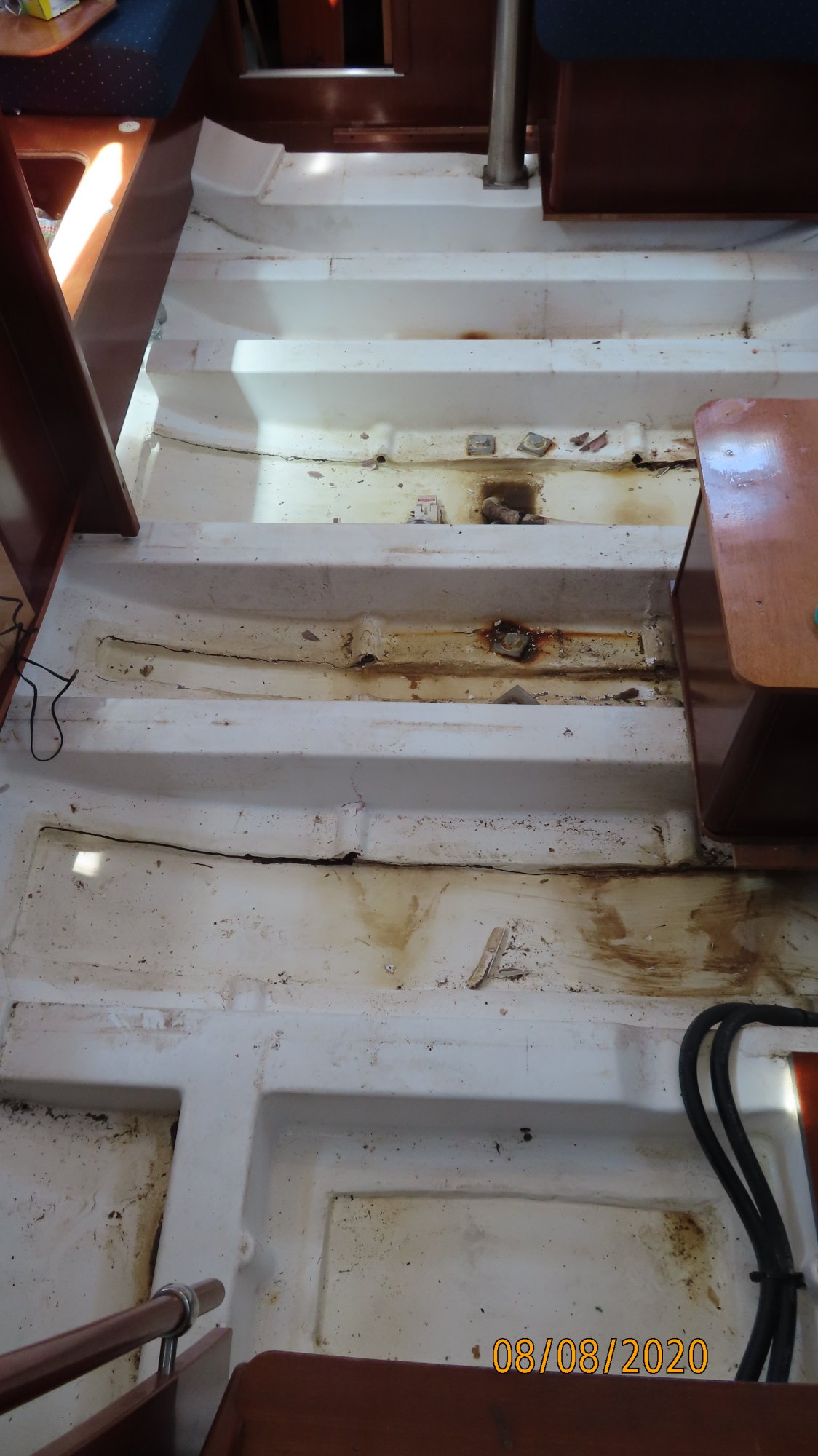

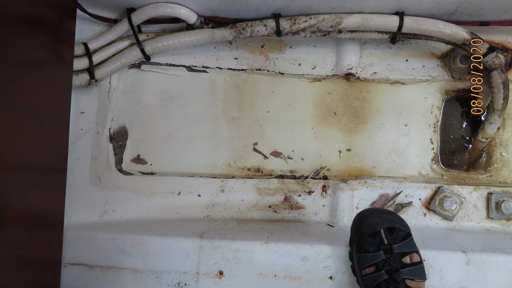

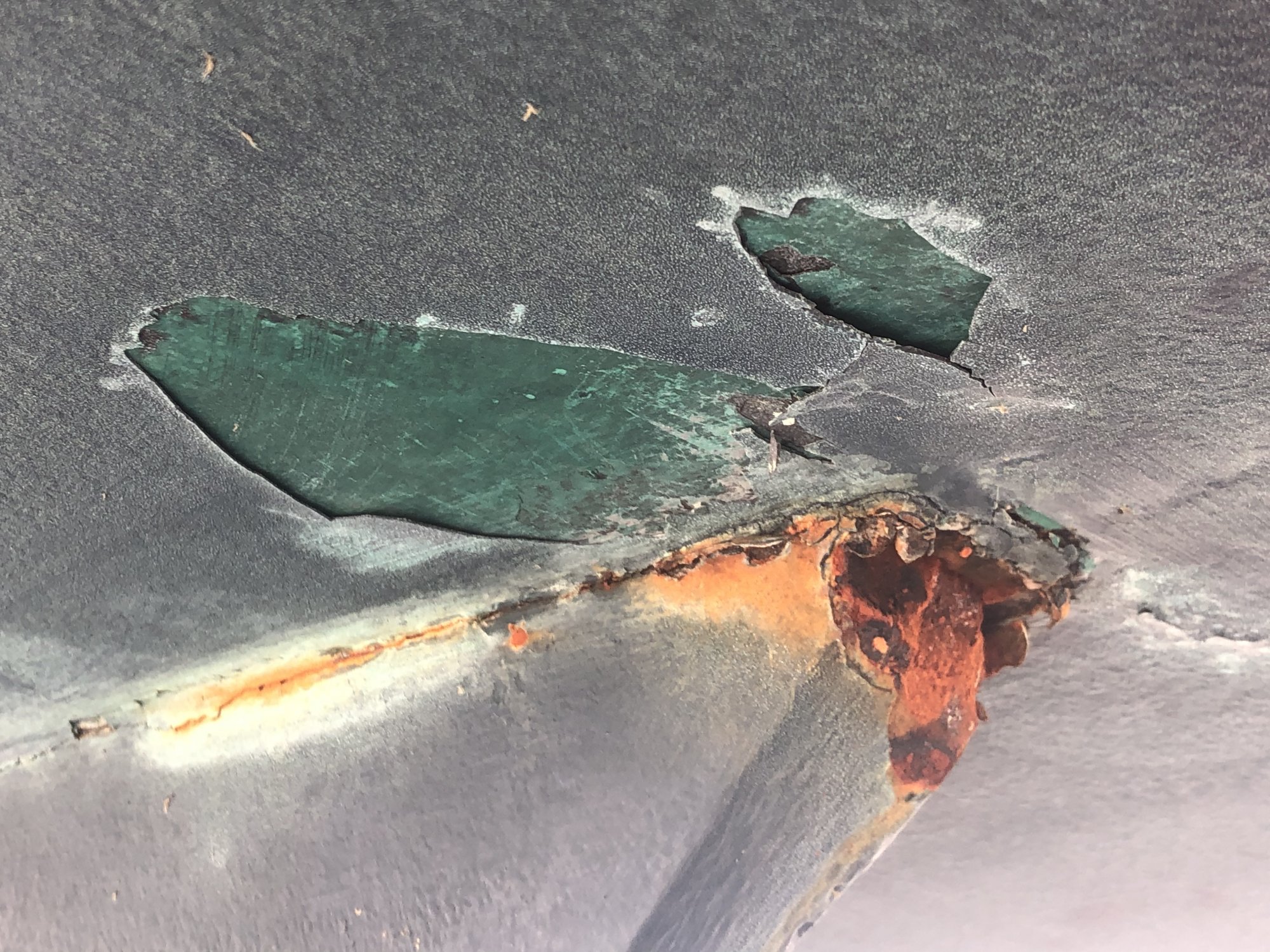

In late July on a passage from Long Beach to Ventura, we struck an underwater object on our Beneteau 423 just north of Point Dume. (Rock, sunken boat, whale? We never saw the object before we struck it or after. We were in 25 feet of water at the time.) Although no water entered, there were obvious cracks, both between port and starboard and along the edge of the port and starboard sides. The cracks are both vertical and horizontal and are along the raised stringers that run from port to starboard in a section of the liner just ahead of the Volvo engine and just behind the most forward keel bolts.
We put in to the first available harbor, Channel Islands, and hauled out the boat two days later, where it has been since.
The boatyard that hauled the boat is unsure of how or if it can make the repairs and the insurance company, Progressive, is considering a constructive total loss as the boatyard is suggesting that the entire hull liner will have to be removed just to determine the extent of the damage and undertake repairs.
Although the boat is from 2004, we had only just purchased it in June and had already put another $18k into new rigging, paint, engine upgrades, etc.
We are hearing different messages from boatyards and marine surveyors as to whether repairs are possible so I would appreciate hearing from the Beneteau community about this. We have agreed value insurance so if the boat is totaled we'll get back what we paid for the boat, but probably not the additional amount we spent on repairs and upgrades. We searched for a long time for the right Beneteau for us and we're heartsick at the possible loss of a boat we love and the need to start all over again in searching for the right boat.
I've attached some internal and external photos of the damage. Is a repair possible that will make the boat seaworthy? Does the entire liner and, hence, all internal structures of the cabin, need to be removed to even assess the damage? Are there yards, say in San Diego, that might be better equipped to carry out such repairs? If repairs are possible, but the boat is totaled by insurance, should we consider buying back the boat and undertaking repairs at a qualified yard to try to recoup as much of our expenditures to upgrade the boat as possible?
Thanks in advance for any advice.

Totally repairable and will actually make the boat stronger than when it left the factory. Mine was done as well as others on this site . The pans of the matrix are cut out , then 1708 is glassed where the pan was and up the sides of the stringer 6 layers . The stringer now becomes 1/2 thicker each side . When I say pans I mean all of the pans some that showed no damaged were not attached to the hull. The pan is then gel coated. The boat also becomes a lot quieter .The boat was hung in slings for a month for this repair . Most of the pans when cut out the glue never touched the hull and the pans were about 3/16 to 1/4 thick ,now 1/2 thick and totally attached to the hull with west epoxy. Total cost 20,000 5 years ago ,your more likely around 30,000 far from a write off.

Unfortunately your keel struck whatever it was in the worst spot - the front knuckle. Yes that does drive the aft of the keel up cracking the fiberglass bottom and causing a good deal of damage with the tabbing around the keel, evidently with the stringers and you can't be surprised if tabbing around bulkheads have separated or partially separated. The damage could be substantial worse than it looks.
You correctly took the boat to the nearest place to have to hauled. That doesn't mean that is the best place to do the repair. If the yard management even scratches their collective heads about what to do, you need to go somewhere else. Find out who is experienced at this type of repair, and has a great fiberglass guy and go there if you want to do the repair.
If the INSC wants to total the boat I would give it serious thought. Do not buy it back.

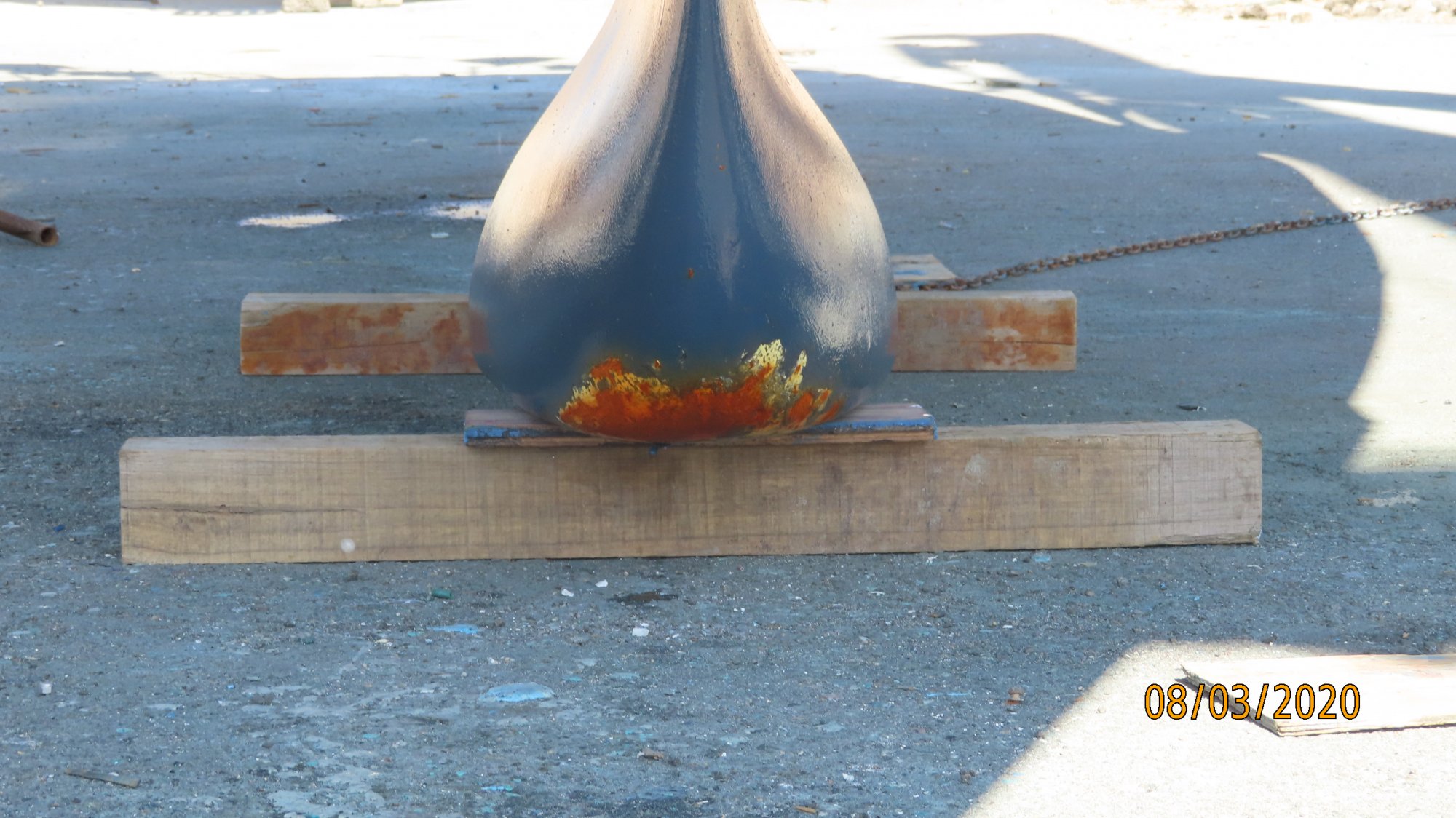

Some questions: How fast were you going? Did the boat stop dead? Were people thrown up as well as forward? I noted the keel doesn't seem dented. Is it lead or steel? Lead would have deformed. Steel maybe not.

Sad to hear and sorry for the position that you are in. If I were a betting man.... I'd say you struck a submerged container.. The leading keel edge looks like it rode up and over..

Beneteau uses cast iron keels, which is why it is scraped and not dented. We were motor sailing in terrible seas with a small craft advisory at the time and strong winds right on our bow. We had just ridden up a wave and were descending when we struck whatever the object was. It made a cracking sound, as evidenced by the broken area under the boards, and was violent enough that one of the boards popped out of its position; presumably hit by a piece of fiberglass. The boat shuddered, but did not stop dead in the water. It's not in the photos, but there was no visible damage to the prop or rudder. No water entered the bilge. We were probably motoring about 4-5 knots at the time. None of us were thrown off our feet and were thrown forward rather than up, though not very forcefully. We motored another 4 hours or so until we reached the first available safe harbor.

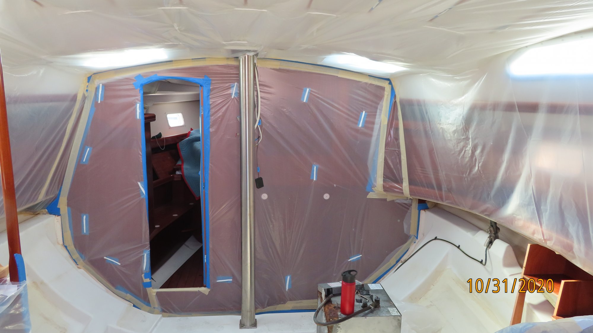

Thanks everyone for the helpful replies and sympathy. We identified a yard in San Diego, Shelter Island BY, that has experience in this type of grid/structural repair and our insurance will cover shipping the boat by truck there beginning next week. In case there are others, like Expedition Evans, that are dealing with this type of damage, I'll post some pictures and information as the repairs progress. Wish us luck!

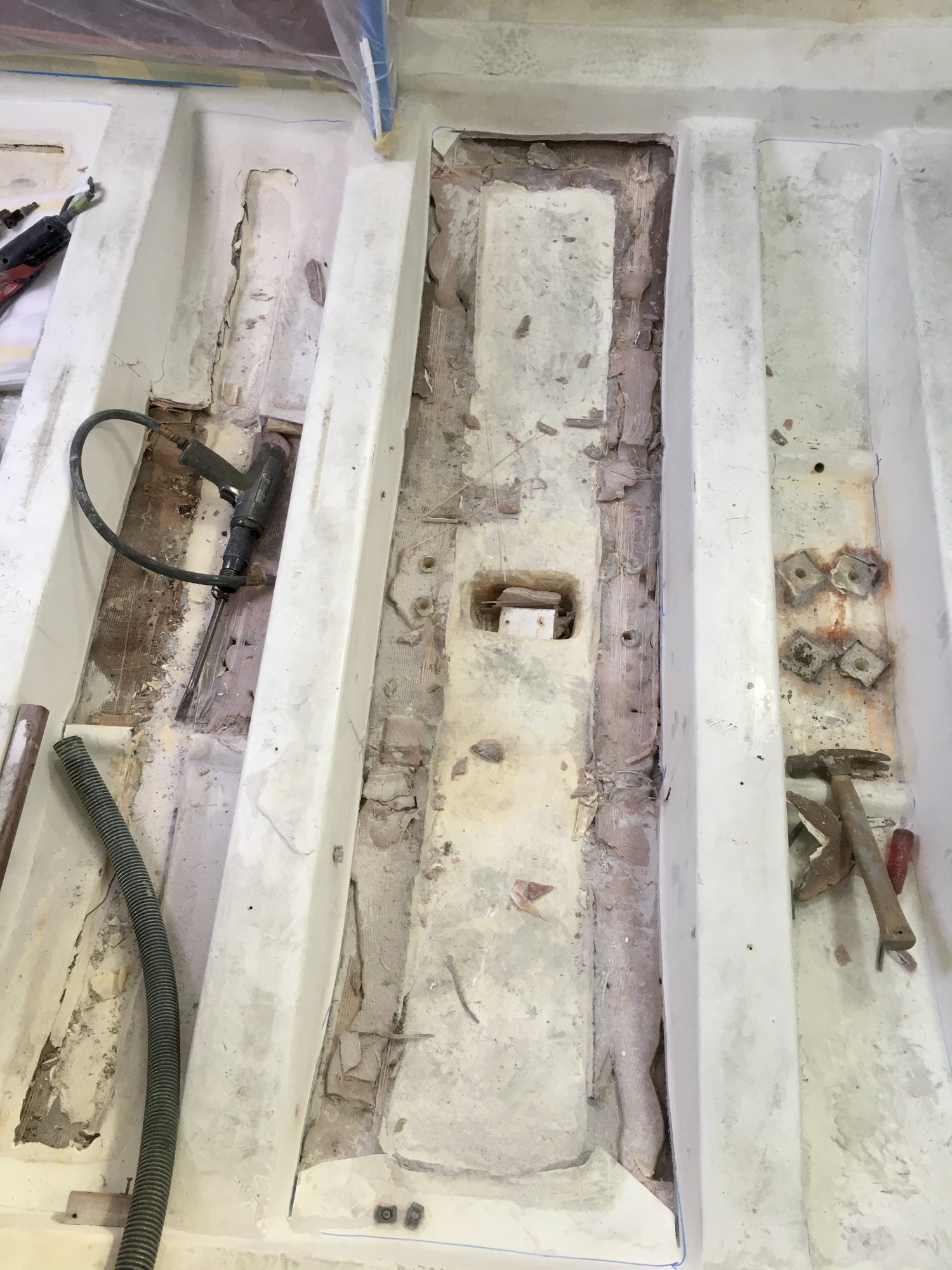

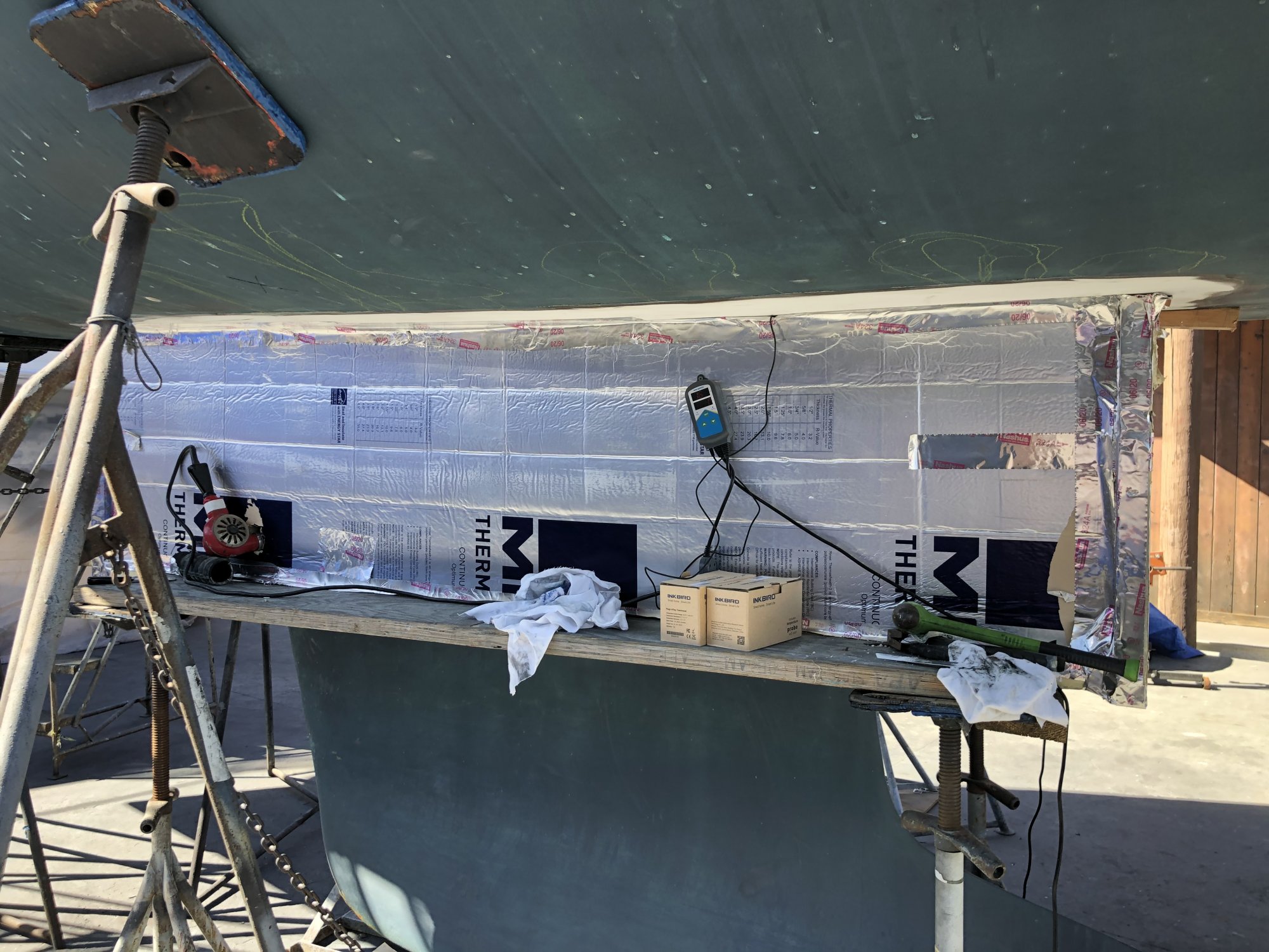

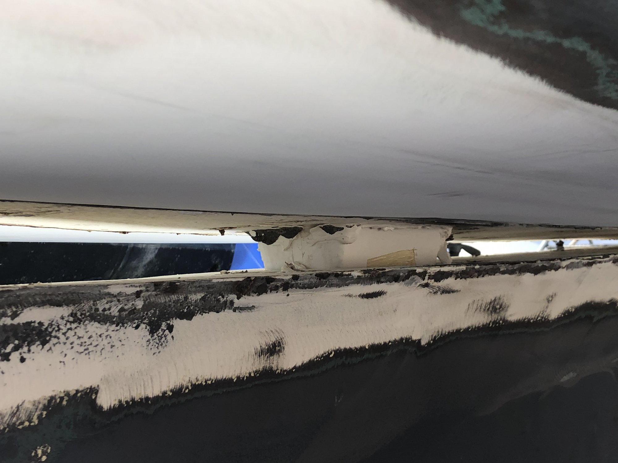

Hi. Yes. The repair is well underway. One of the big worries was removing the keel without doing further damage. The wrong way to do it was illustrated by the yard that ripped the keel off of Expedition Evans, mentioned above. Shelter Island yard consulted experts and created an “oven” around the keel that they heated over a day or so. The keel separated with no further damage to the hull. Insurance also agreed to perform a thermal imaging of the hull that found no hidden delamination. Unlike the poor couple in Expedition Evans, SIBY created a cocoon in the saloon and created pressure zones in the fore and aft cabins to contain the gel coat dust that would coat everything otherwise. The fiberglass work has begun and is expected to go on for several weeks at least. Some photos are attached.

Hi. Yes. The repair is well underway. One of the big worries was removing the keel without doing further damage. The wrong way to do it was illustrated by the yard that ripped the keel off of Expedition Evans, mentioned above. Shelter Island yard consulted experts and created an “oven” around the keel that they heated over a day or so. The keel separated with no further damage to the hull. Insurance also agreed to perform a thermal imaging of the hull that found no hidden delamination. Unlike the poor couple in Expedition Evans, SIBY created a cocoon in the saloon and created pressure zones in the fore and aft cabins to contain the gel coat dust that would coat everything otherwise. The fiberglass work has begun and is expected to go on for several weeks at least. Some photos are attached. View attachment 187248
Funny I made a comment on youtube that they should have heated the keel with heat guns to release the 5200 Beneteau uses. I have replaced my own and others thru hulls using a heat gun to release 5200. Mention 5200 and everyone goes nuts . It has its uses especially below the water line and it does not let go and leak.
