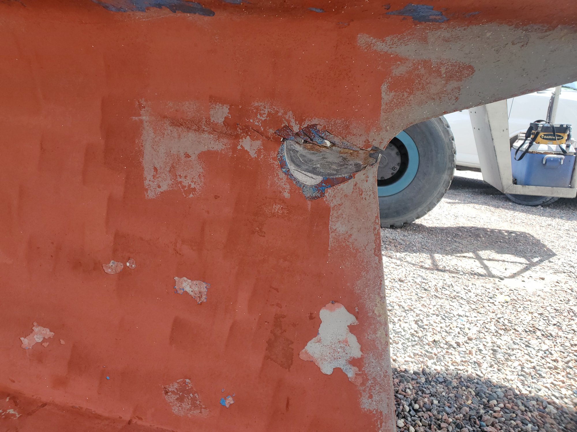

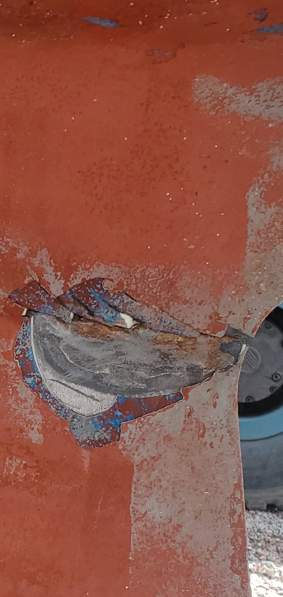

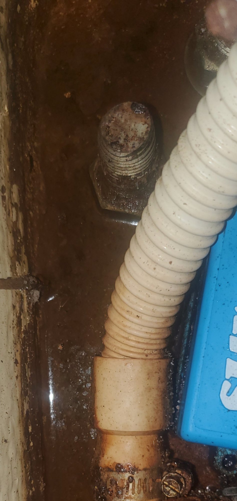

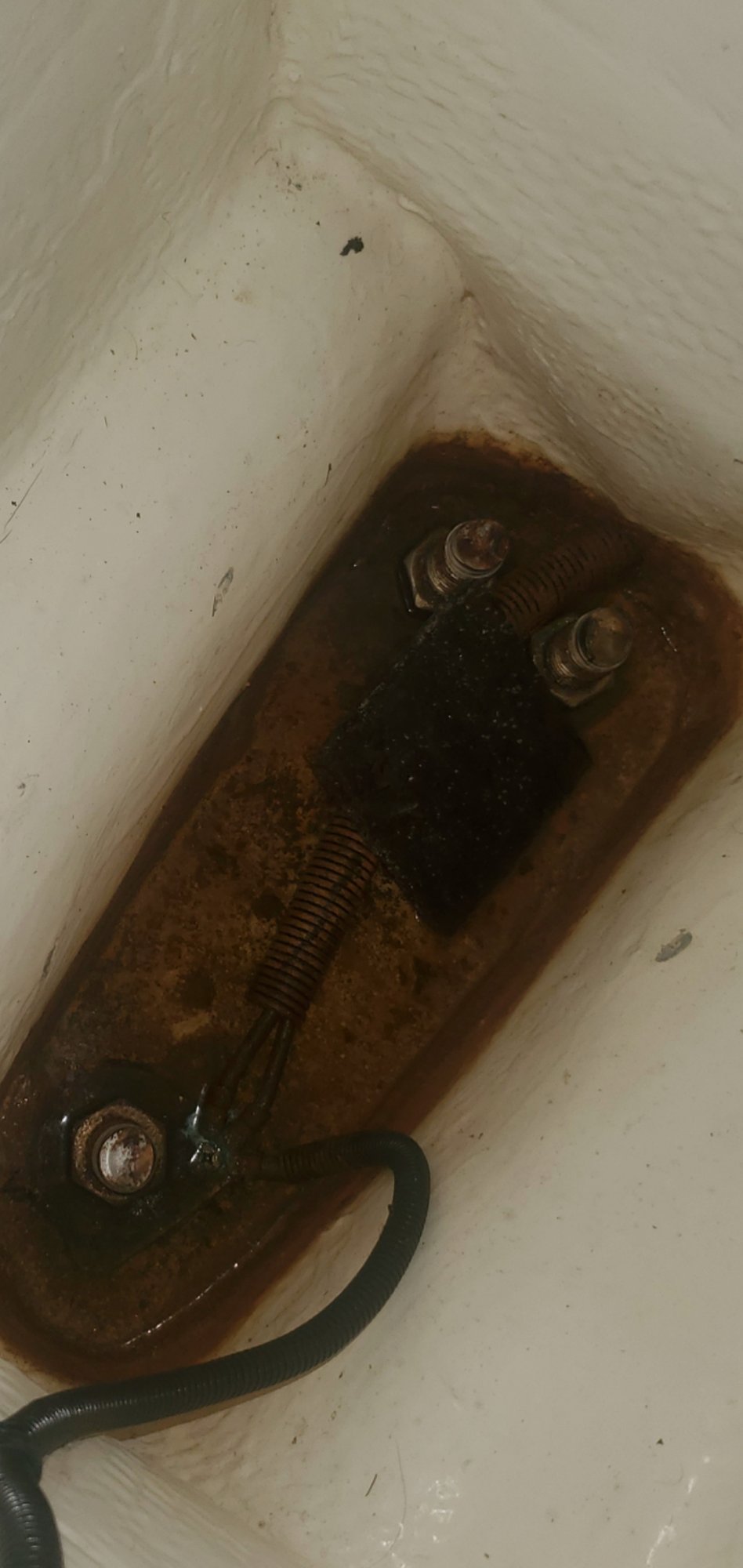

Hi, I am looking to purchase a 1994 hunter legend 375 a d after haulout, found a crack in the keel aft only. Should I be concerned about a major rebedding and bolt replacements? The local glass tech says its cosmetic and its only the fairing compound between the stub and bolt on keel. He never inspected the bolts in the bilge. My surveyor didn't seem to know either way which was disappointing. Please see photo and any advice would be greatly appreciated. Also, some rusty dirty water in the bilge with the bolts.

Although I understand your asking here, diagnosing keel stub issues from a few internet pictures is dubious. While some may offer opinions here, we can’t tell definitively . Before purchasing, find a better surveyor or yard to inspect more thoroughly.

The splayed crazing spreading up from the keel looks like a lot more than a simple keel stub/ballast joint issue. All the cracks need to be ground out. If it's all just filler or fairing material, fine, you can slap some back on to suit. If it's the fiberglass that has cracked, it's structural, and a more careful repair with new layers of 'glass is needed. We had damage like that after hitting a rock at 6 knots. The front end of the keel (lead) we banged back into shape with a hammer. The back end needed to be ground out and replaced.

Thanks for your input, did you have to address the keel bolts as well? There is no damage forward. The rusty water a concern in the bilge? Thanks for your reply.

Looking at your pics, the concern I have is that there seems to be a great deal of "filler"
exposed at the seam. Since the earlier Hunters like mine had a keel stub made of solid, hand laid fiberglass mated to a solid, unsheathed lead keel, I don't understand what the broken 'chunks' of filler/epoxy putty/whatever are about. I'd dig out a piece of that and try to determine what it's made of. It could be a sign of prior, significant damage.
The brown staining is the result of a "wet bilge" that needs a good cleaning.
It's a normal occurrence.

Based only on the pictures I would agree with the local yard guy that it is fairing and not a deal breaker. Surveyor's of today are afraid of their own shadows given the litigious nature of the public. As for the condition of the keel bolts and other issues you're basically on your own.
The only way to really know is to lift the boat off the keel, inspect and replace, and re-mount it. Maybe at the right price point that makes sense. When it comes to deciding to buy a boat you need to ask the question - "Will I be able to sell the boat tomorrow and get my money back?"

If the boat has just been hauled out for your survey......Was all the missing and cracked area missing and cracked when you first saw the damage or is that mess a result of the surveyor and/or the fiberglass guy looking into the damage as part of the survey and further investigation? Does the messy bilge suggest to you a lack of overall care by the present owner? Without being there to see the rest of the boat (such as engine, engine compartment, wiring, head and its plumbing) I might think it does. I would politely walk away.

This isn't something to fool around with. Insist that a surveyor at least look at the bolts. If the surveyor says it looks OK (which is all they can do in a survey) then get a discount for fixing the putty and close the deal. That's probably all it is. Then pay the yard to torque the keel bolts to Hunter specs. This is a good thing to do when you buy any boat with a bolt on keel. If repairs are needed, it's not very expensive. As a cautionary tale, here's the British accident report of the Cheeki Rafiki that was lost with all hands (a professional racing crew) when the keel fell off in mid Atlantic due to bolts that were not repaired after an earlier hard grounding. https://assets.publishing.service.gov.uk/media/55408664e5274a157200005b/MAIBInvReport_8_2015.pdf
