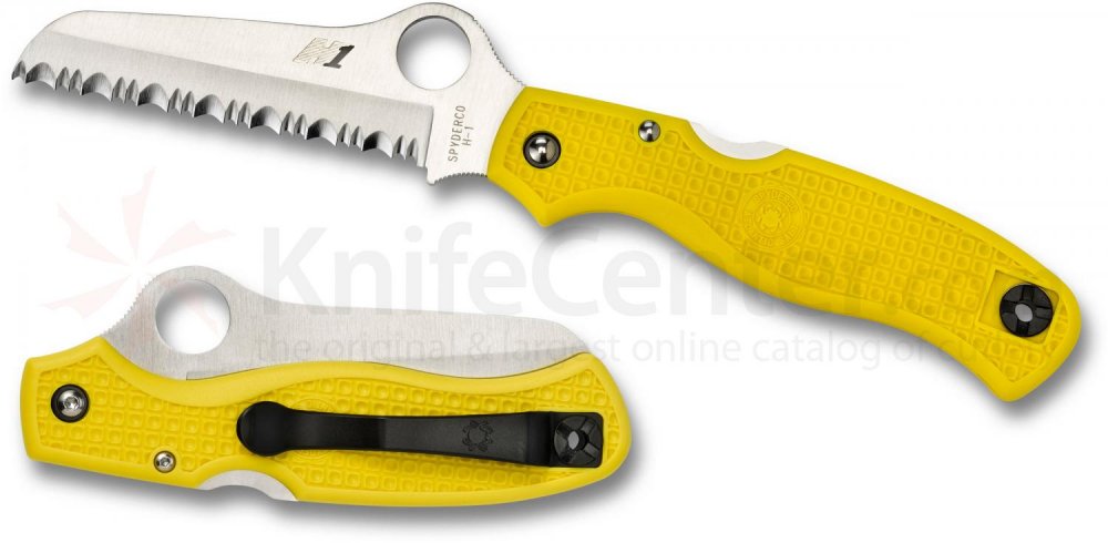

Those are great knives.
My wife bought me one of those for Christmas last year. As is typical for me, I almost immediately lost it.
Five months later, what do I see peeking out of the mud, right in the middle of one of my driveway ruts, but a little spot of yellow plastic! My Spyderco! It had been lying half-buried in the dirt, run over at least six hundred times by my Tundra and the wife's Jeep, based on how long it was lying there.
The plastic handle is now slightly discolored, but otherwise the knife is still 100% good as new. The mechanism is smooth as butter, and the edge will cut you if you look at it funny.

The stuff is hard to cut, even with a good knife. All of BlueJs lines are dyneema cored, so everyone on board carries one of these.
I googled syderco h1 and got a bunch of designs. Is this a particular model? They look kinda pricey, but, the yellow ones appear to be marine quality. Blunt tip is probably best.
