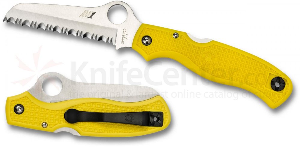

I just don't like the idea that I can't take a sheet off if something goes wrong. I had a sheet jam hard under the edge of a hatch once, and was able to untie it from the clew and yank it out, then put it back. I also end-for-end my jib sheets annually.

Not sure how to reply to the suggestion that a soft shackle might be "resistant to cutting". o_O
By nodding in agreement :). You might be used to working with diy soft shackles from home depot clothline braid. With dyneema like fibers the blades dull super fast and witj a large diameter shackle it takes longer than cutting yatch braid.
Apr 16, 2017
841
Federation NCC-1701 Riverside
Or, you might need a better knife. ;)
Lol. I do need better knives.

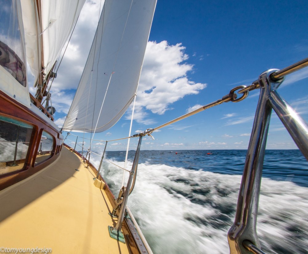

The only downside to the cow hitch for the genoa sheets (for me) is removing it in the fall. But that's a small problem as I only do it once a season(pliers help).
I just bought new sheets. The last genoa sheet had some wear spots but mostly it was overall wear that had me replace them. I never cut that old sheet in half. They came with the boat so at least 20 seasons use.
Compact, doesn't hang up on stays, sure, looks good in the lens. :)
