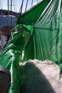

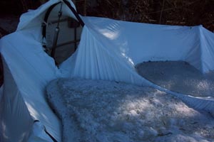

Great cover Tom but that picture with all the snow on the ground is really depressing. :(
It is, Rick,...but it's even more depressing when the snow, which turns to ice, stays on your cover. :)
That snow turning to ice can weigh a lot. 500 -1000 kg (double that in lb). It is really worth its while to visit your boat after any major snow fall. This applies regardless if you cover or not. probably even more so, if you don't. You can easily accumulate a ton of ice in the cockpit.

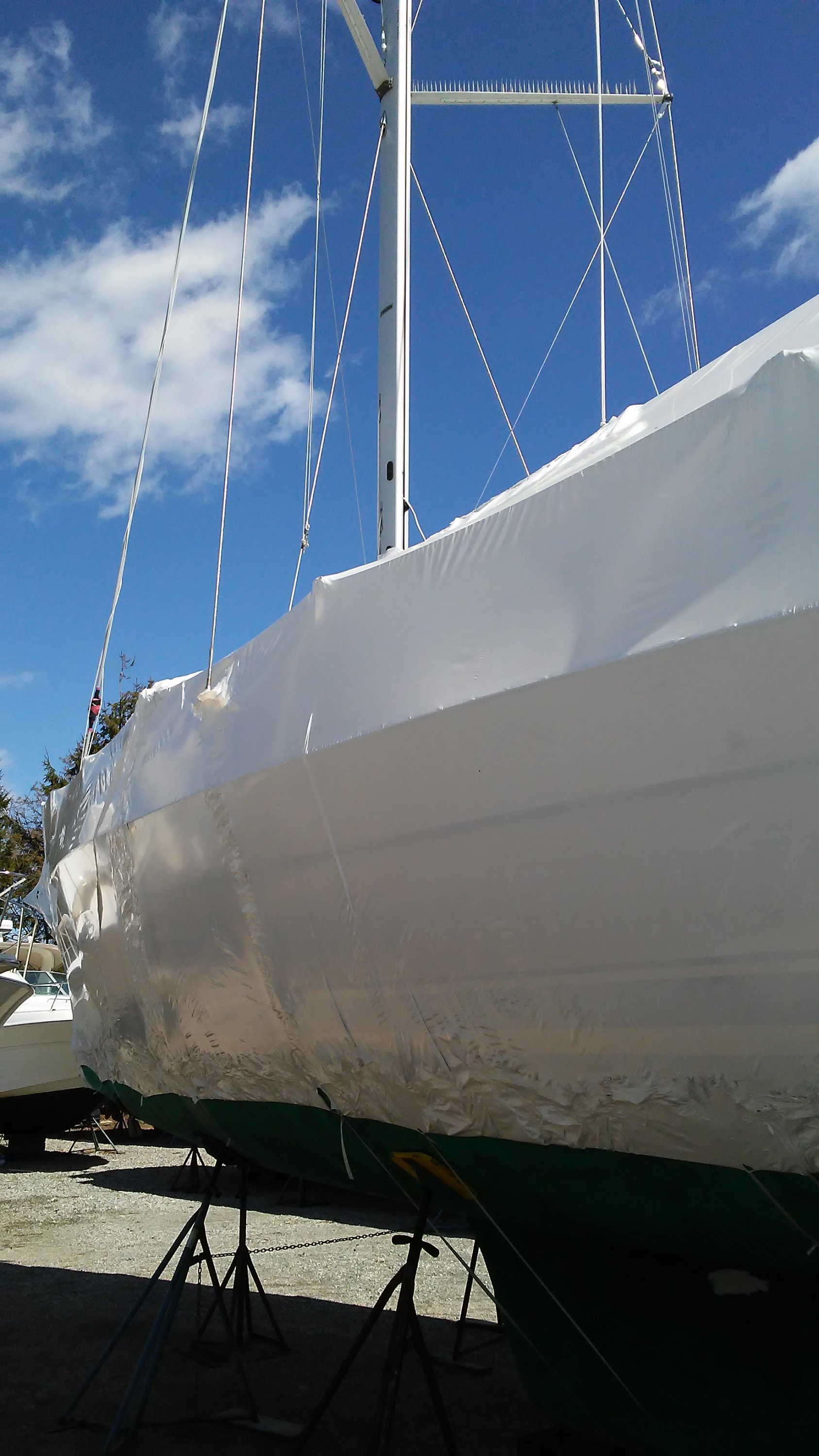

I have a custom cover: Mast up. The framework couldn't be simpler. Ridge pole (2x6) sets in anchor roller and on a crutch lashed to the mast. The boom topping lift is removed and a crutch for the boom sits against the mainsheet track. One piece and it is a simple task to cover.

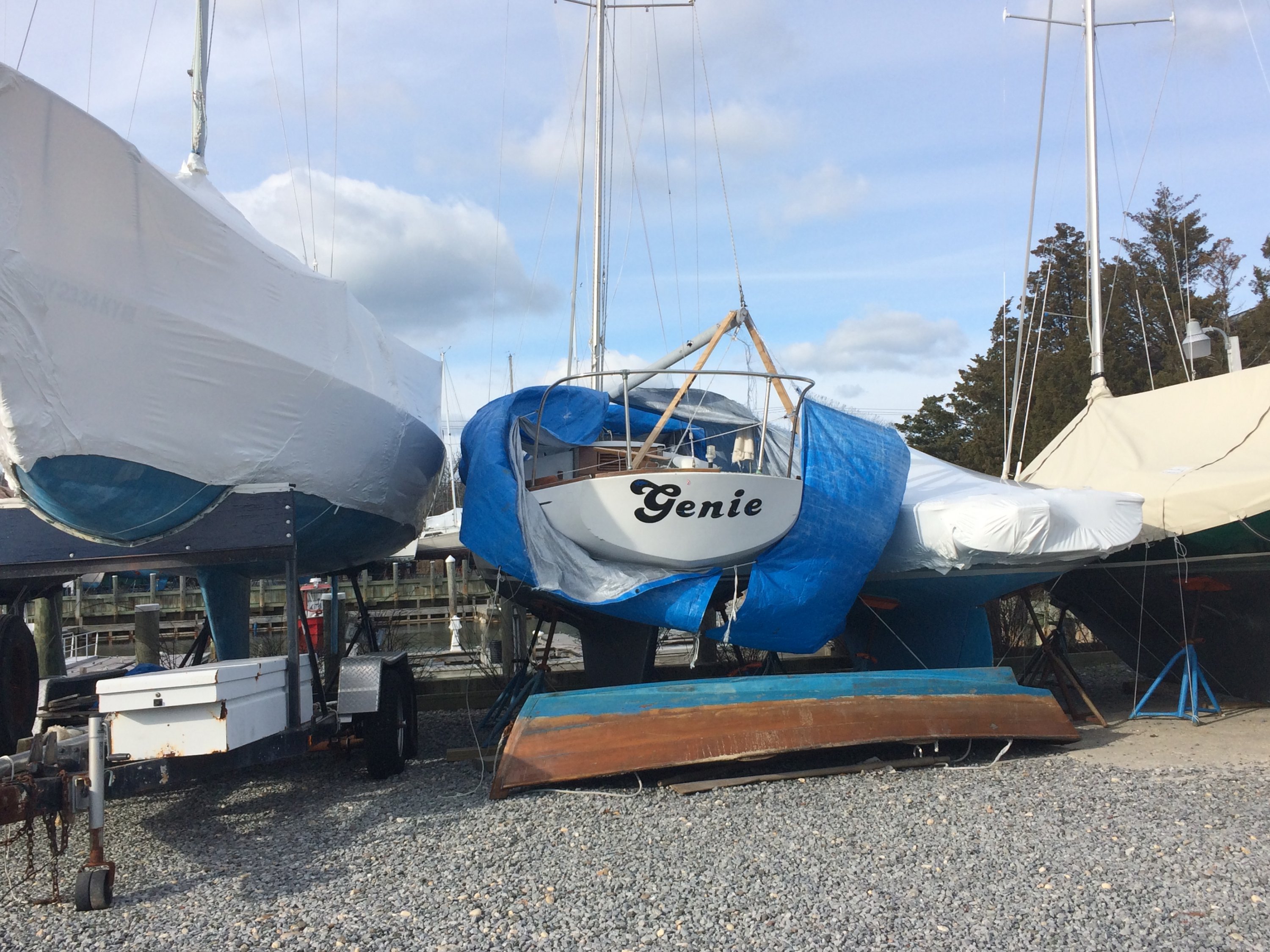

The shrink wrapped boats and custom cover on the right, however, look like they'll weather a hurricane. I don't think I'd like Genie's captain to tie my boat to the dock.

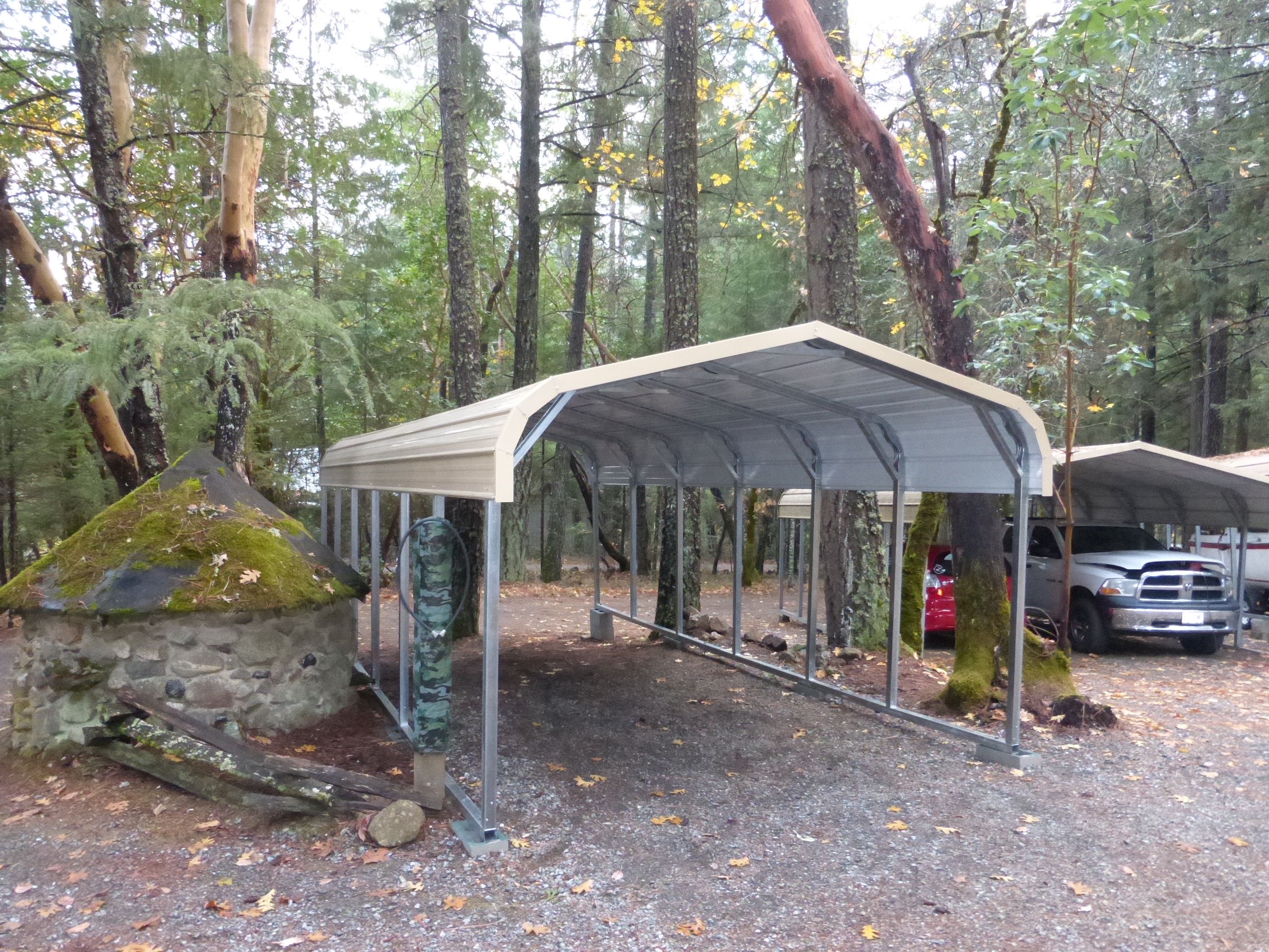

Earlier today a crew finally showed up to deliver and set up another "boat-port" for our most recent acquisition (Vagabond 17 day sailer). now I can toss the last of the #@$% blue tarps for good (as soon as I charge the dead battery in my truck that is :doh:).
