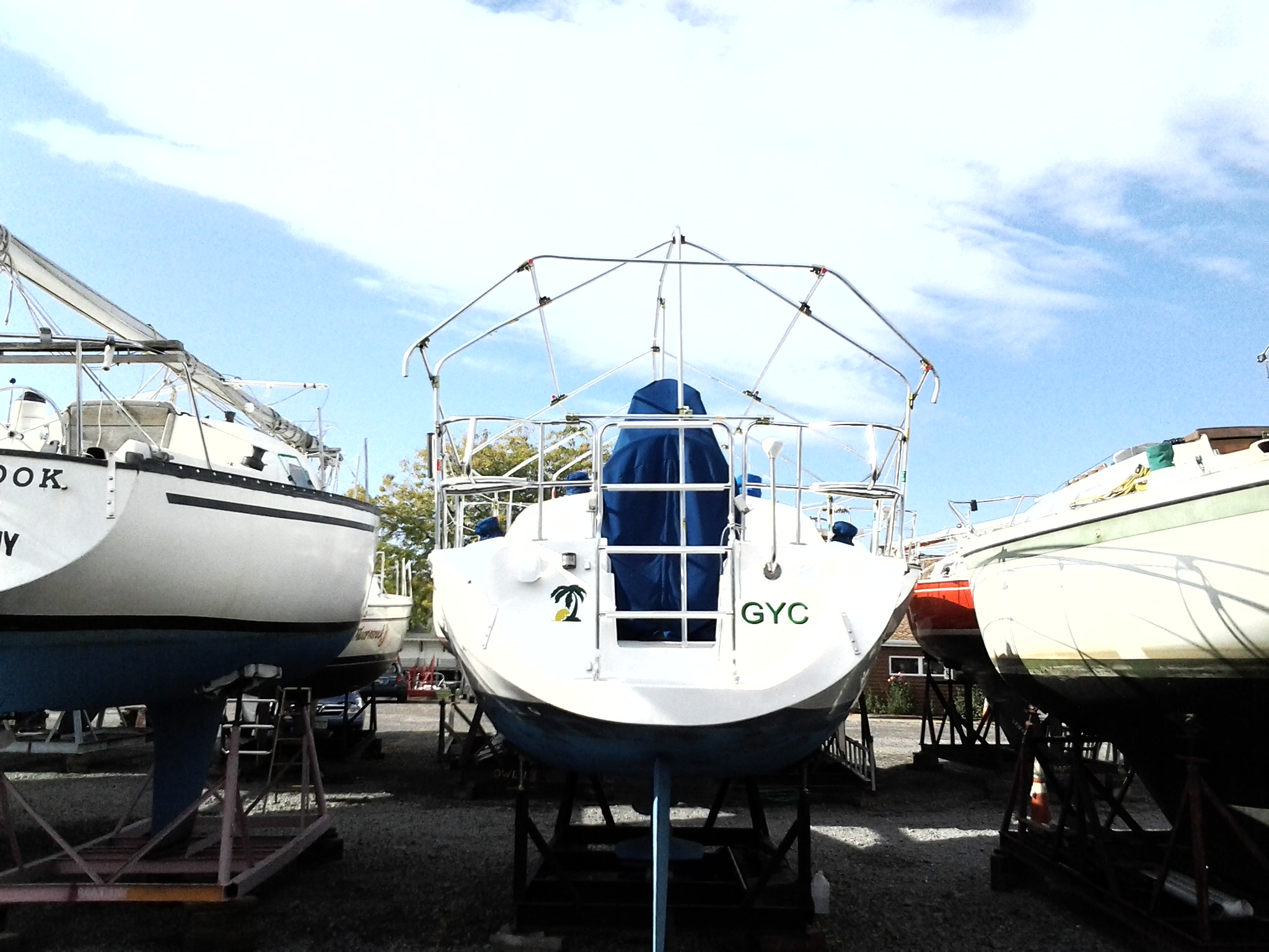

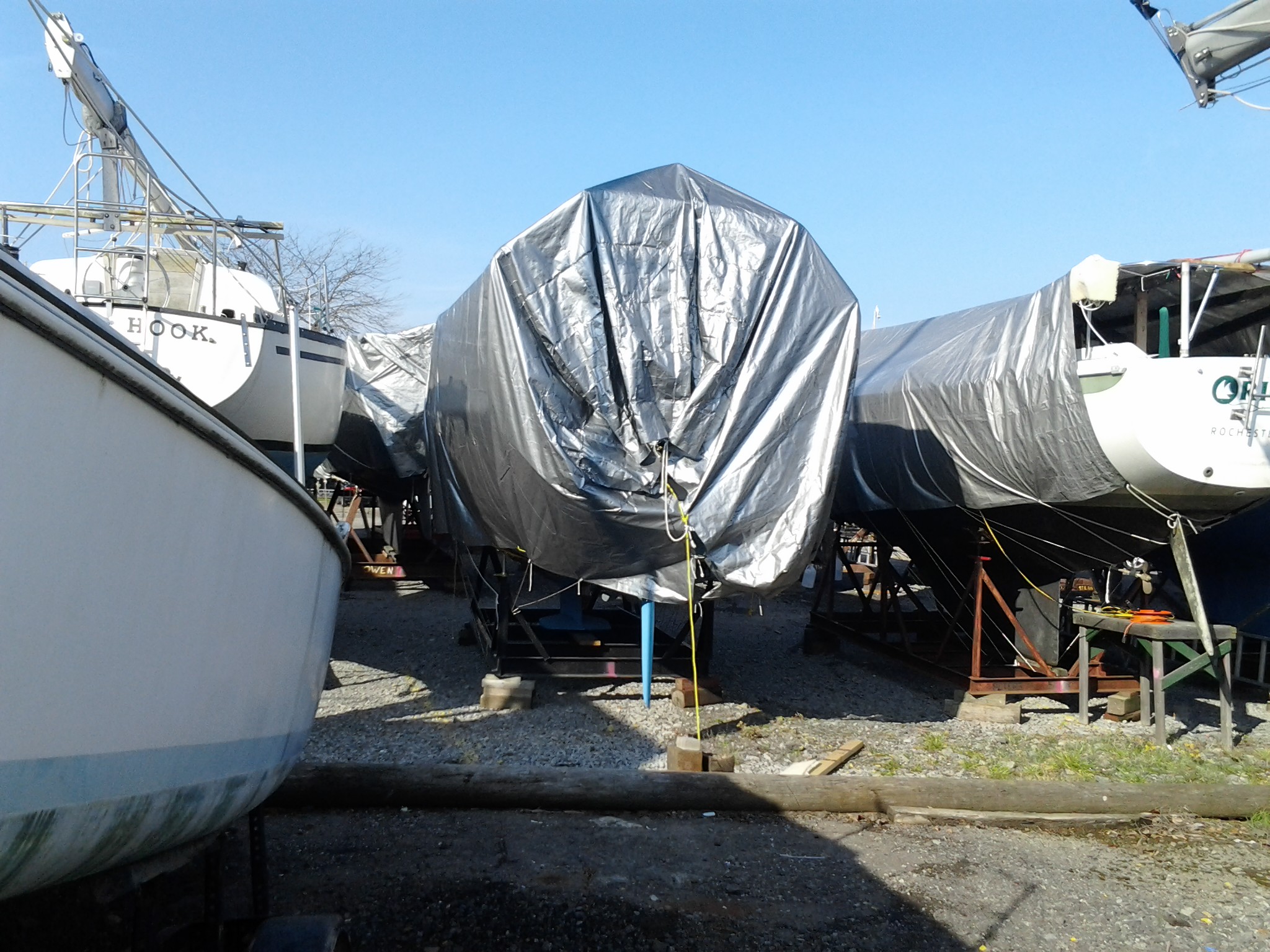

The boats shown on photos on Post #12 are only half done.

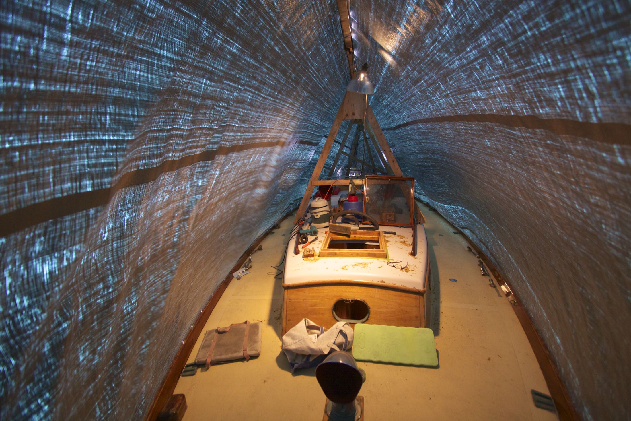

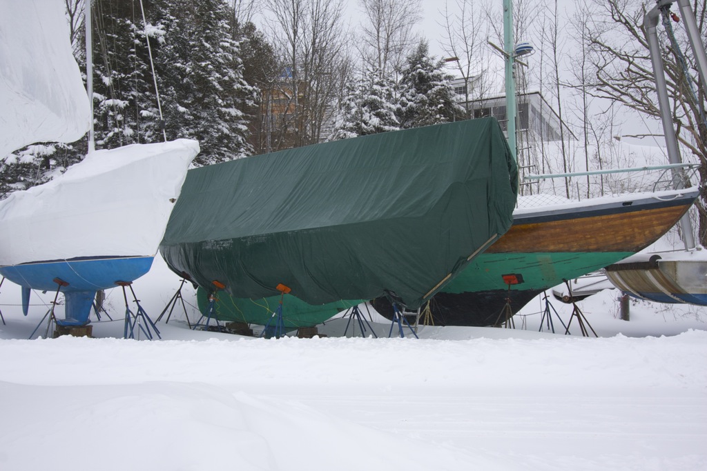

I use a pretty simple system here on the coast of Maine. A high ridge pole is all that carries a 30' x 50' plastic tarp. The reasoning: A steep enough pitch to shed wet snow.
The oversized tarp goes beyond the topsides to eliminate chafe on the painted topsides(my glass hull is nearly 60 years old and way past gelcoat). I run the tarp under the jack stand pads and tie it around the keel. I enclose the ends by rolling up a piece of 2x4 and screwing another 2x through it, which holds the tarp in place by containing the hull.
Compared to an elaborate frame, this is pretty easy (a few hours) to erect and cover. Caveat: My stanchions slide in and out of bases for removal. I always take my mast(s) down for winter.
It's not perfect but is about 95% effective shedding snow (I live nearby and can check and clear it easily). I can get a couple years out of a tarp. It keeps the boat very dry over the winter.
And gives some room to work below in the off season. I enter through a laced end at the stern.

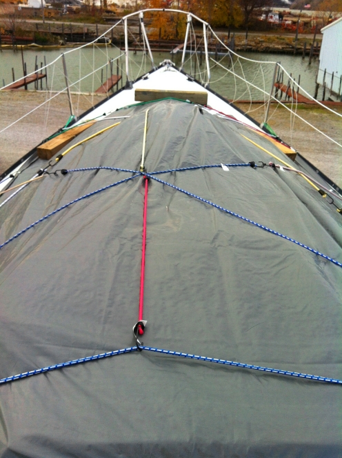

I use the Harbor Freight $30 solution. I have an awlgripped hull so no cover for that part. I use a heavy HF tarp that only covers the forward hatch to and over the companionway hatch. A number of HF shock cords attached to slotted tow rail forms a suspension system that holds cover down. a couple of wood blocks keep air from getting underneath the forward end of of tarp. Works great. Cords last 2-3 years and are cheap to replace. It keeps inside of boat dry and water out of the bilge.

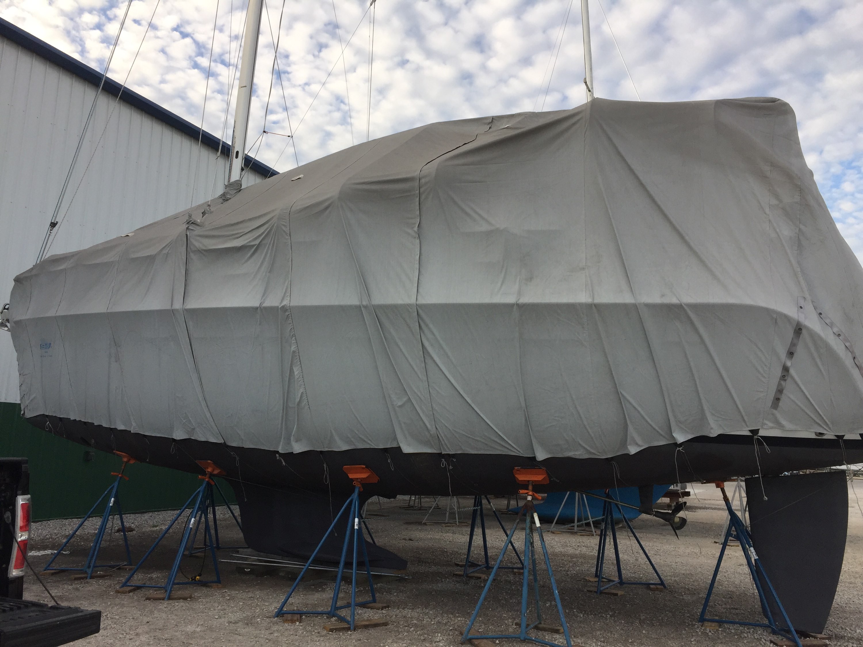

I was lucky enough when we purchased the boat it came complete with a custom cover it is job to erect the aluminum tube framing and then get the (3) piece cover over the framing. The first time it took us all of (2) days to complete the task this year we were finished in just over a day we would have finished in under a day if it had not been for the 25 gusting to 30 mph wind. Pictured is the job completed. If the boat did not come with a custom cover I am certain I would have bought one, are they expensive sure, but with all that is invested on purchasing the boat it is a very small investment in comparison.
