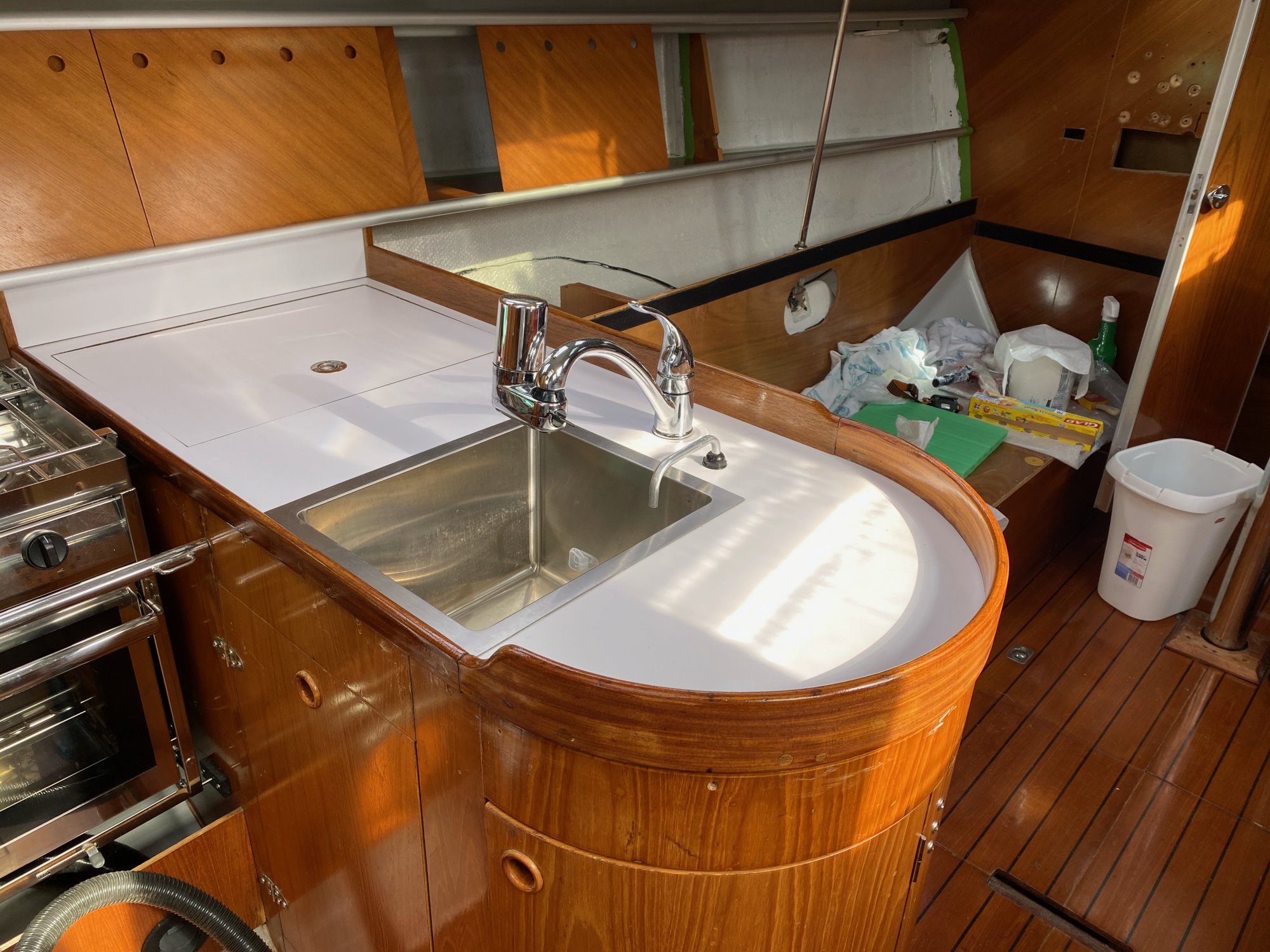

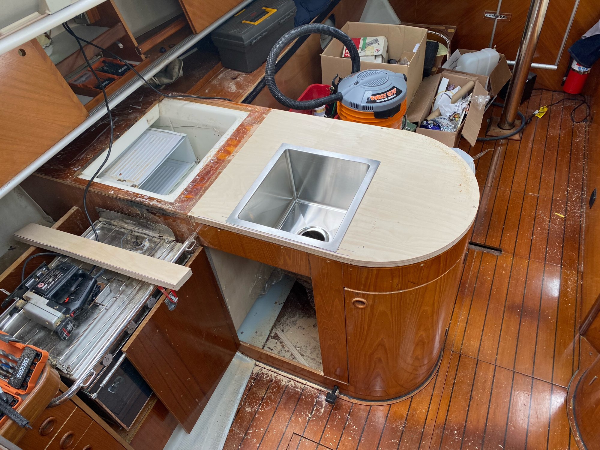

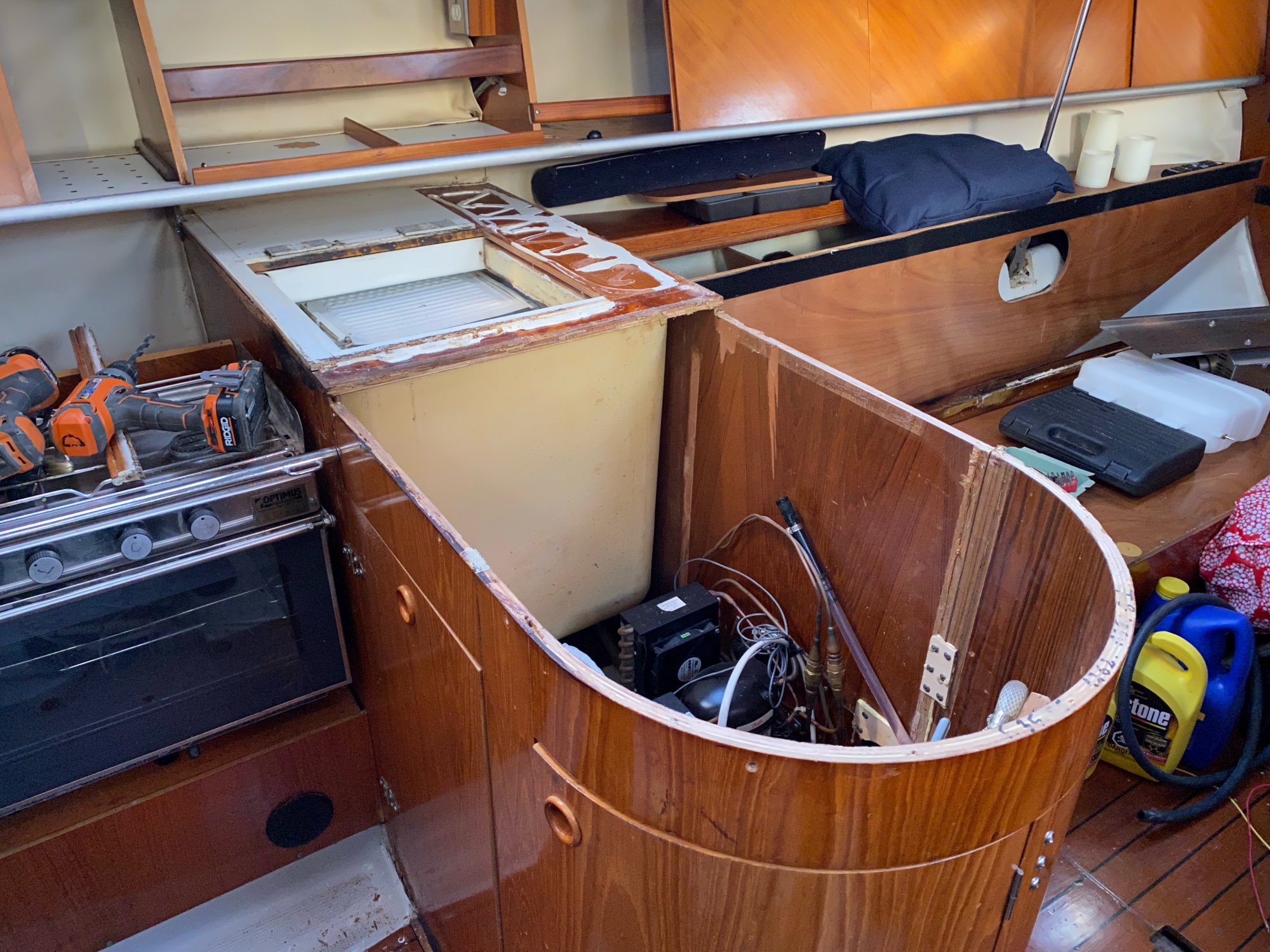

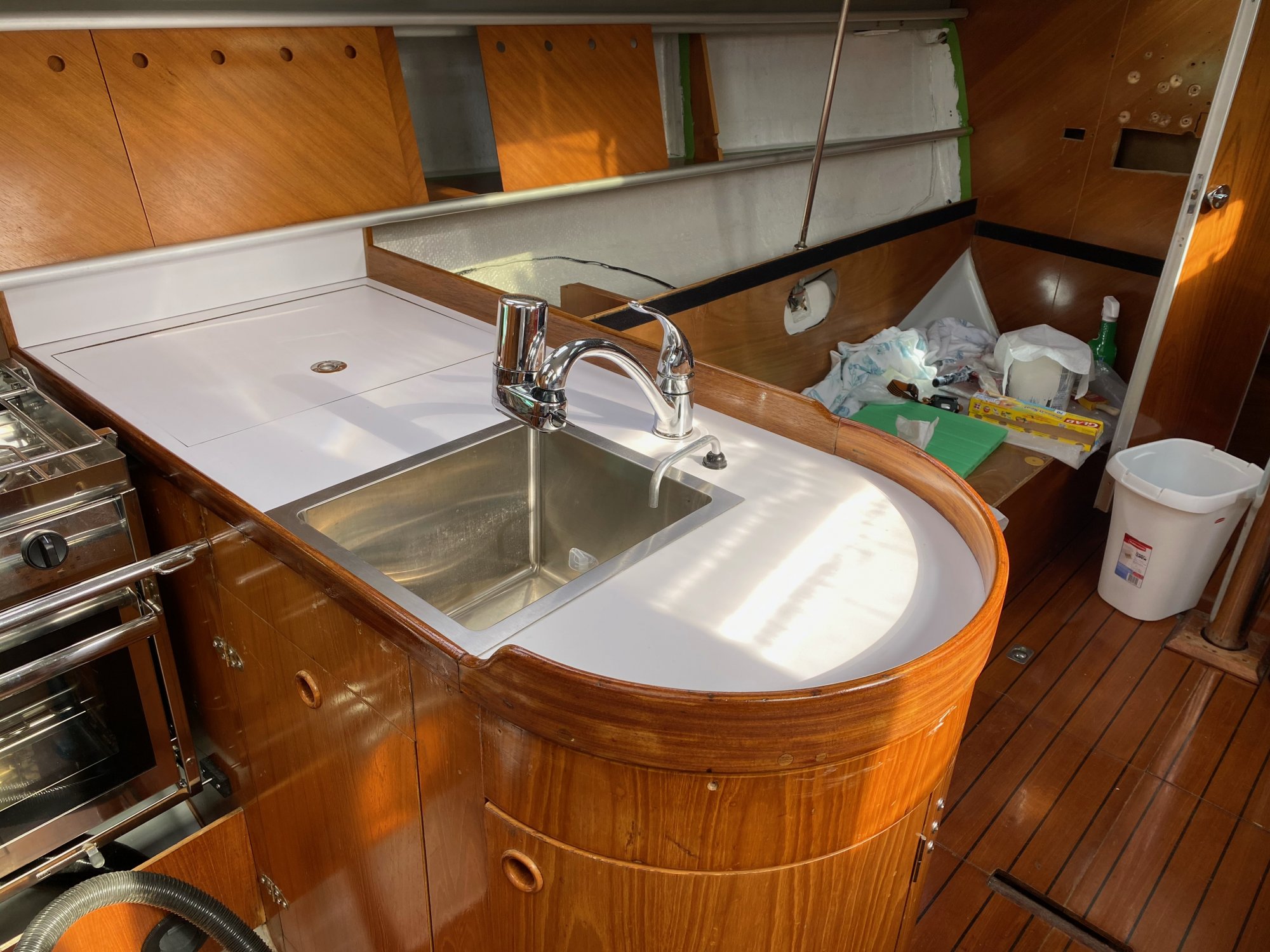

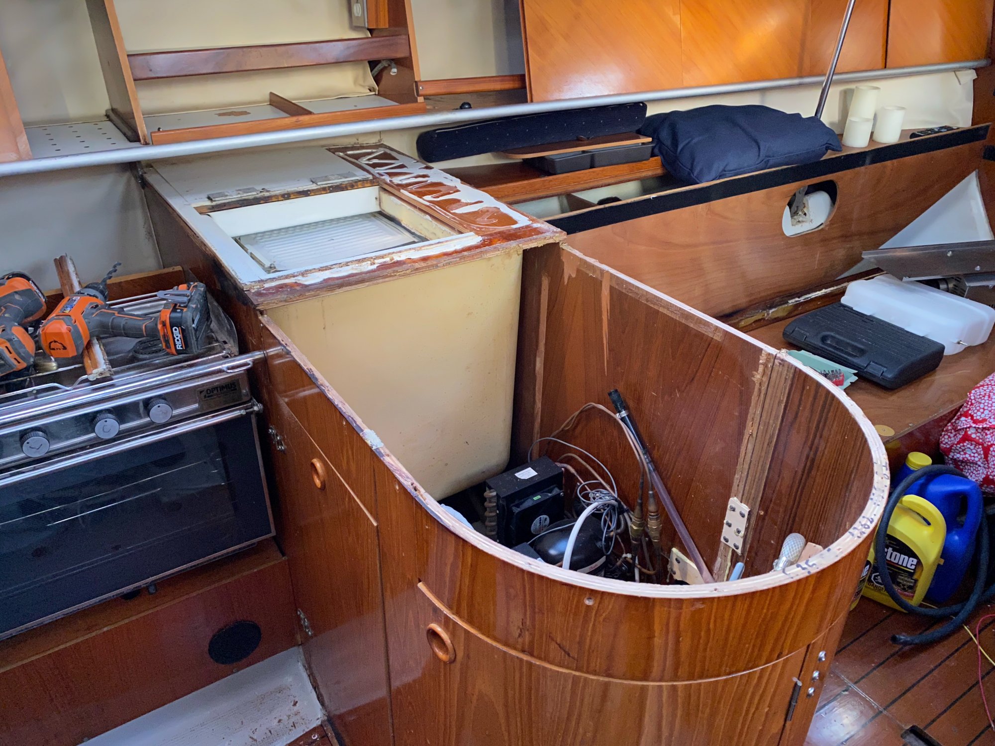

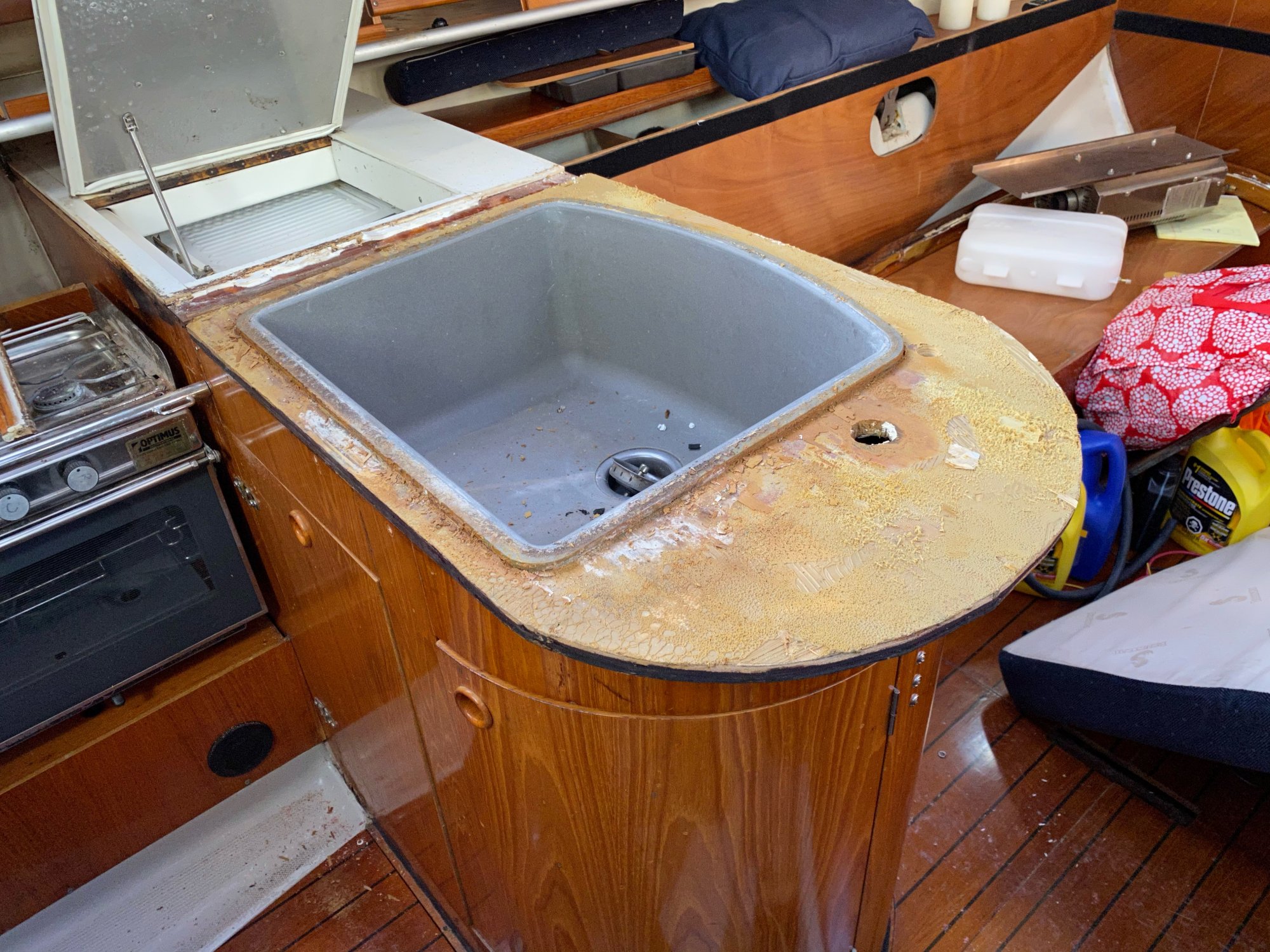

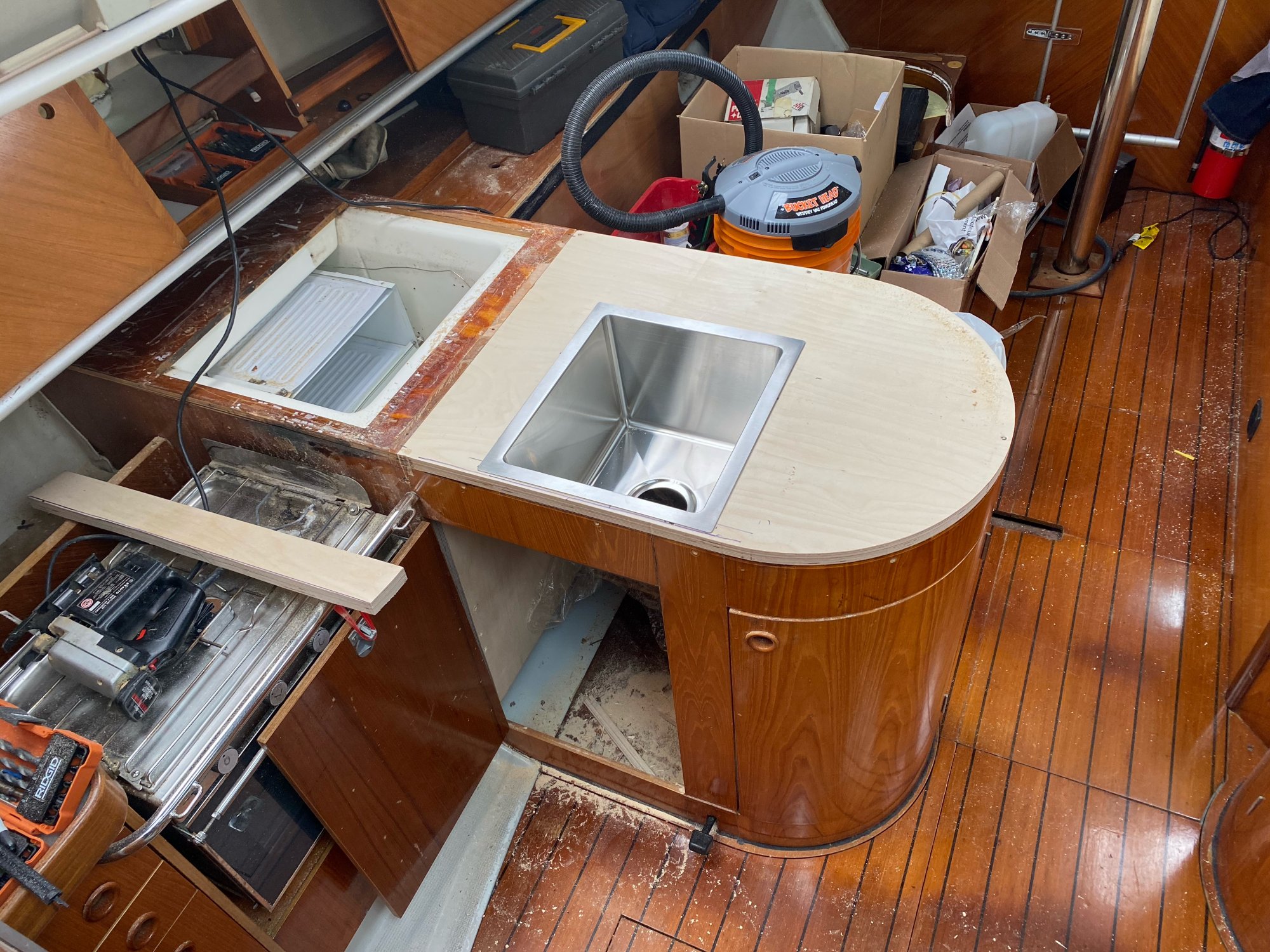

Ditto the above....
Over large sink
Old top removed
Plywood top with reasonable sink
Arborite cover and fiddles restored
For the fiddles you might consider sourcing some Sapelle rather than teak.. its a pretty decent match after some light cheery stain, and 1/6th the price!
