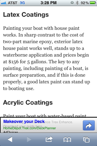

Could this work

I see no references to "marine growth" in that article. And, since I am really not interested in painting my bottom for "appearances", I see no advantage here.
Incidentally, I have never seen any research or trials using latex paint for this purpose. Unless someone else may have?
Happy Sailing.
Just wondering if anyone else have heard or tried it. Thank you
