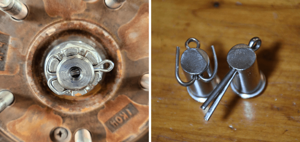

Shape, material, and thickness I would assume. They get caught and deform or are bashed and then deform. Once they deform, they are able to work themselves loose. I've found them completely missing on my rigging.
Pins, if done correctly, are low profile and have no sharp edges to catch on anything and can only be removed with pliers or by cutting them. The upper ball joint on your car likely use castle nuts secured with pins. It's a pretty crucial component that will surely cause damage and/or an accident if it fails.
Sep 30, 2025
173
Catalina 22 Davis Hollow - Lake Arthur
NICE! I like that.
So that first photo, with the hard bend in at the end to leave no edges to ever get snagged... Is that how you do it on your sailboat?
