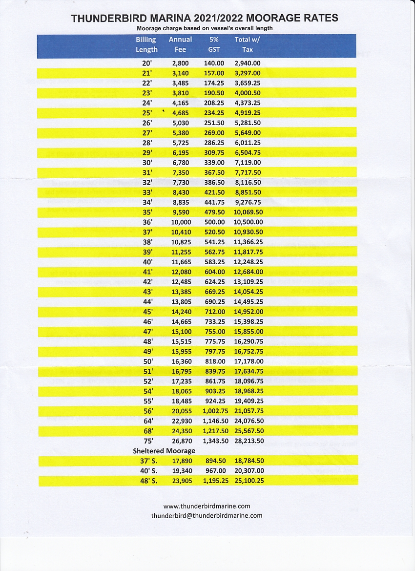

Only one cost to consider ................... moorage. Everything else is minor compared to that.
Cost for 31 ft. moorage in Vancouver, B.C. is $7,717.50/year (in Canadina pesos). Unfortunately, still a good chunk of change. Moorage increases at 2.0%/year. With all of the extras, about $10K/year.

.......Cost for 31 ft. moorage in Vancouver, B.C. is $7,717.50/year (in Canadina pesos)........
That cost makes San Francisco Bay marina berthing very reasonable at $7200 US including power with new docks and power and blocked from the wind. One would justify berthing the boat in the bay and fly back and forth.
I would think moorage for a 31 ft. in your marina would be pocket change. Frequent flyer miles and any other perks and it might just work :p.
