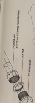

Folks I own a Hunter 41 DS 2005. The shaft size is 1 1/4" - any idea what size shaft packing material I should use 3/8th or 1/4"??

The most accurate method is to measure the inside diameter of the packing nut and subtract 1.25" shaft diameter and then divide by 2.
FWIW, I have a h40.5 with a 1.25" shaft and my packing is 3/16". I guessed once, bought 1/4" and after struggling for a while I bought some 3/16" that went in exactly like it should. Lesson learned- don't guess. Measure instead.

Our boat has a 1-1/4" prop shaft and a standard bronze stuffing box, which takes 3/16" packing material.
I don't want this to sound like a smart-aleck comment, so please don't take it that way. We have a 2005 model year Hunter 306, and it came with a big manual in a 3-ring binder. The packing size is listed in the manual. Assuming the previous owner (if any) didn't toss out the manual, have you looked there? Many, many times, I've found myself asking a question here, only to later be looking through the rather voluminous contents of the blue canvas bag which came with our boat, which contains a pamphlet on just about every system on the boat, and where the answer could be found.
BTW: I seem to recall that ours was 3/16" for a 1" shaft.
Jun 23, 2019
8
Hunter 41 DS DS Deale MD
Thanks Jaysweet - please see in my earlier post (28 April) that I did eventually find the picture in my Owners Manual that I already had. Thanks friend.
