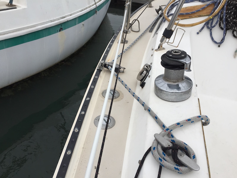

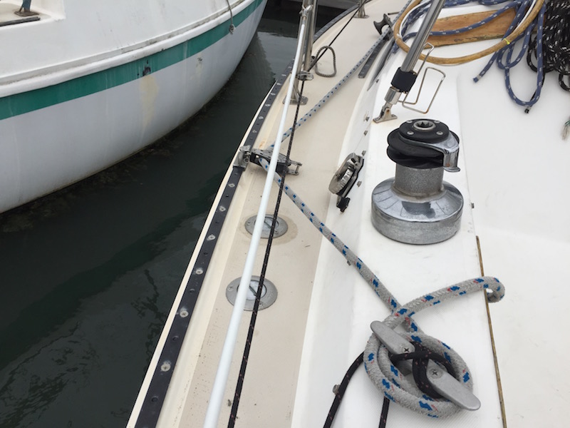

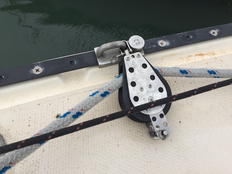

I thought I would chime in here as I finally obtained a couple of blocks and sorted my issue out. They aren't perfect, but were only $25 each and work well.
After more research, I think the ideal way to do this is to use a low-friction ring with a splice in place of those blocks. It would cost a little less and be just like all the racing boats today!
