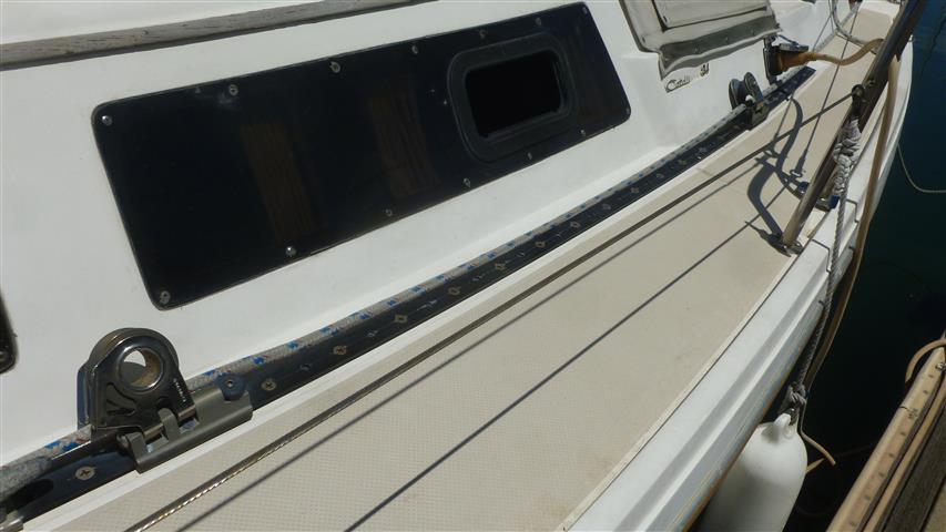

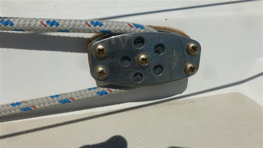

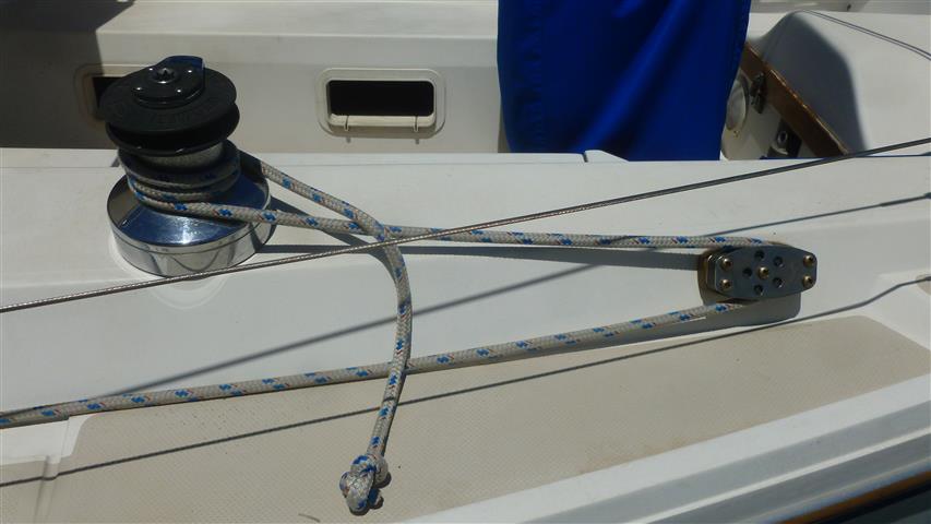

Stu, I love your wealth of knowledge and use it all the time. Thanks for your corrections....To be more clear I have these sheets coming off the back of my genoa that go to a pully thingy on a track on my toe rail that has a garhauer adjusting thingy that I adjust based on how much of my genoa I have deployed. I try to adjust it to approximately cut the genoa luff in two. From there the sheet goes back to another pully thingy on the same track that is in a fixed position about a foot to 18 inches behind my winch that is on the cockpit coaming. Then back to the self tailing winch.
23,320
John, as long as the lead is fair to the winch, and, as mentioned, not too low or too high, then all you're doing is using a
jib fairlead car mounted block as a turning or cheek block. They usually aren't used in that service, i.e., to turn the direction of the line. We have two fairleads per side going to a big cheek block on the outside of the coaming.
