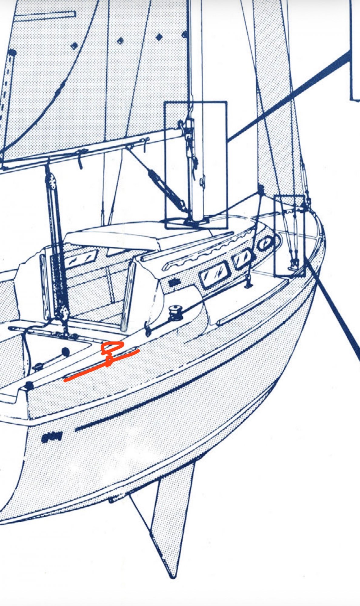

My O’Day 25 has two midship stand-up swivel blocks (one port, one starboard), genoa tracks with cars located aft, winches slightly forward of cockpit, and just aft of the winches, some clamshell cleats that were clearly DIY’d on wooden “risers.”

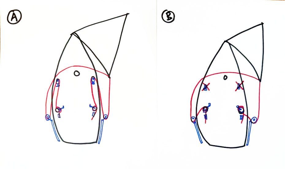

The PO told me to route the genoa sheets outside everything to the cars on the genoa tracks, back up to the midship blocks (now inside the stanchions), and then back to the winches (See Diagram A) but the problem with this is... the genoa sheets are too short. Every time I tack or jibe I have to get out of the cockpit to reach the end of the opposite genoa sheet which is stopped, only by the knot, at the midship block. At first I was going to add longer sheets.
Then I read (here) "Run the genoa sheet aft to the car on the genoa track, back to the winch, and that's it... the midship block is only for the 100 jib." (See Diagram B). This feels like it makes more sense though I can't give a solid reason why other than... why would I lead the sheet through another block unless it's just to line up better with the winch but...
I don't have a 100 jib. I believe the boat came with a 150 and a 135.
Does anyone else have experience with this?
Follow up question. I don't love the clam cleats on 2.5" tall 1" wide risers. What was original? A standard cleat? It looks like the position of the clam cleats are original (no new holes were drilled)
Thanks all!
