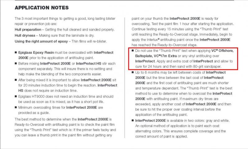

For a standard antifouling paint you can "hot coat" / "thumb-print" it but not with any of the vinyl based paints such as VC17..
"Do not use the “Thumb Print” test when applying VC® Offshore,
Baltoplate, VC®17m Extra or any vinyl antifouling over
InterProtect. Apply and extra coat of InterProtect and allow to
cure for 24 hours and then sand with 80-grit sandpaper."

Sadly they can't fit it all on the can of paint. You do not hot coat any of the vinyl based anti fouling paints to IP2KE. For IP2KE to IP2KE there is no sanding required unless you wait longer than 6 months but for IP2KE to VC17 the IP2KE must be dry then sanded, then solvent washed then the VC17 can be applied. If temps are in the cooler range 24 hours cure for the IP2KE may not be sufficient...
