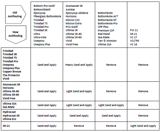

Sand it down to the gel-coat, and epoxy prime, or soda-blast. If you use a stripper, you still have to sand the gel-coat to give it tooth. I went back with a base of Trinidad hard paint, and then HydroCoat soft ablative. When I see Trinidad, time to roll on another coat of HydroCoat.

What do you have under the ablative? If you already have an epoxy barrier under ablative and you need to remove the ablative to install a hard anti-fouling paint, is there any need to soda blast down to gel coat if you already have a good barrier paint applied? I would guess that you would try to avoid removing a suitable barrier paint.

I don't know for sure but I would guess more ablative is underneath. I don't know if you can distiquish between layers of paint to know when to stop blasting. Anyway, I'm leaning just to put on another ablative coat. Seems like a lot of upfront costs for the hard coat and I'm not sure how long I'll have the boat.
