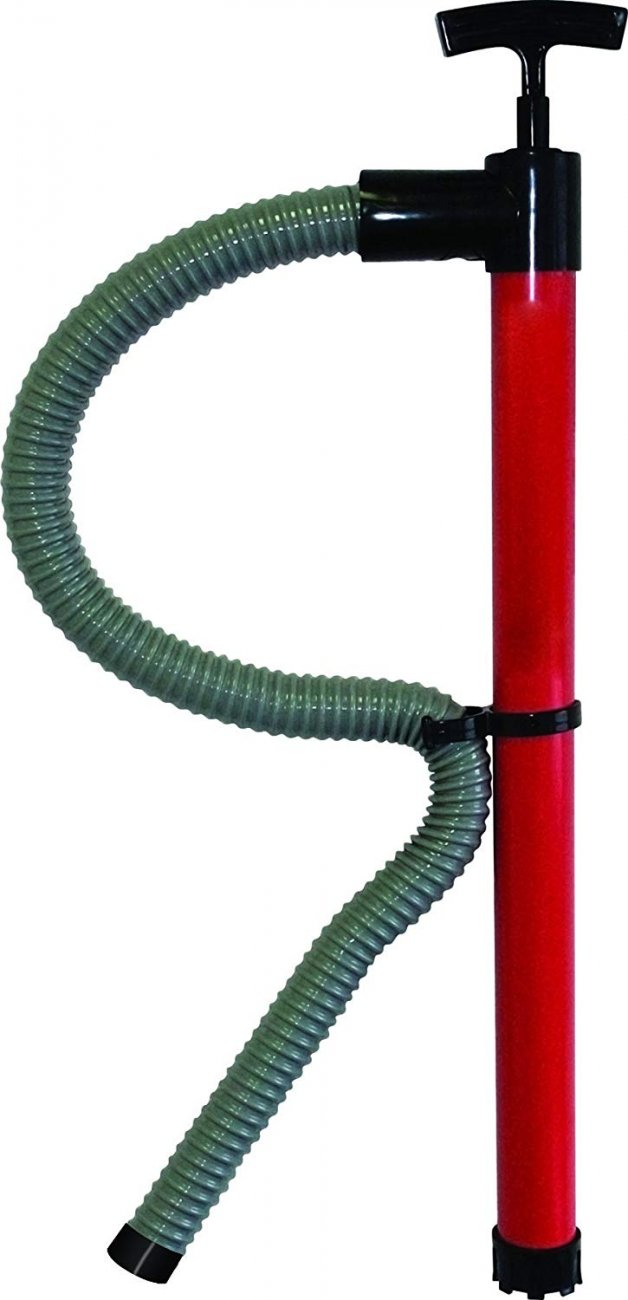

Here you go.
Seasense Hand Bilge Pump w/ Hose
Easy peasy. Buy from Amazon/Walmart or your favorite marine chandler.
Just call it your "Ice Box" pump when not using it in the bilge.
