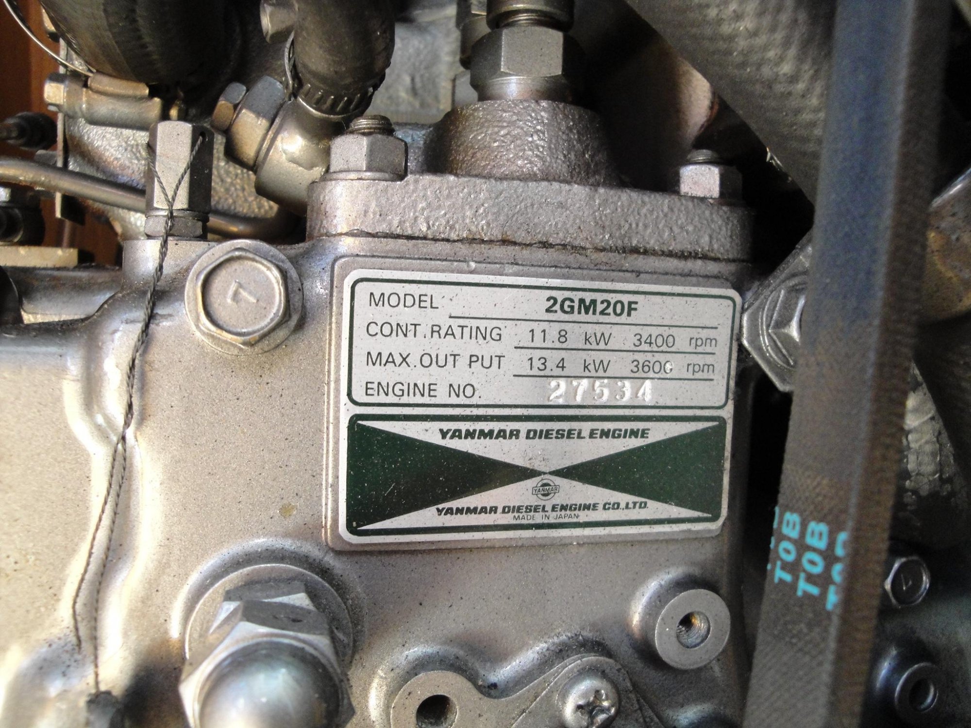

Please clarify the model of your engine :
It's 2GM _ _ _ . I suspect a 2GM20F but please confirm all digits and letters.
Also it would be helpful if you can supply one or two single shots of the engine, face on and face up showing the source of the leak. There are too many sideways and upside down shots to clearly see anything and I've sweated over my 2GM20F for 25 years and have a pretty good idea of who's who and what goes where.
Jan 4, 2006
7,772
Got to take a break from working beneath the cockpit here so I'll guesstimate your engine is a 2GM20F. Your ID plate looks similar to mine (which proves nothing) :

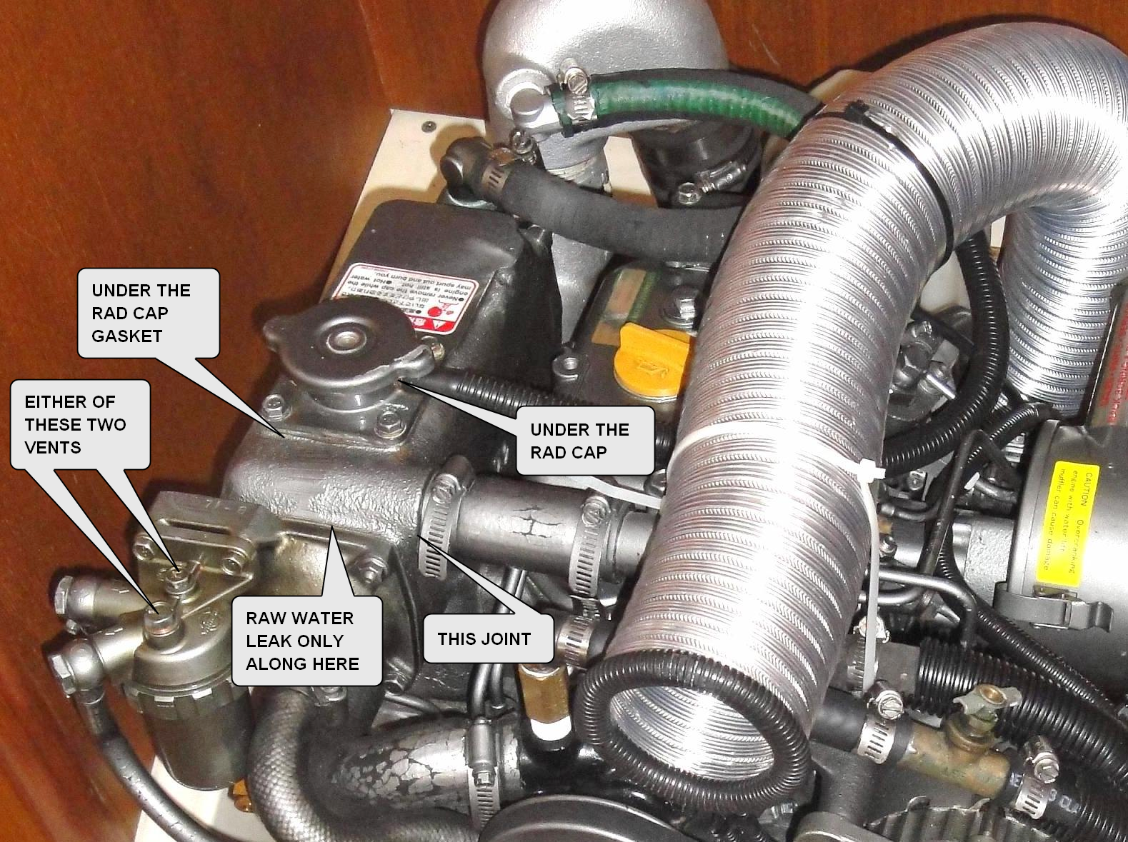

There are no obvious drips from a hose or clamp, but somehow it's collecting on the fuel filter housing and dripping down off the motor.
With that observation, look here for leaks. The leak is above the level of the seconday fuel filter. Do a TP test and allow the engine to run for a while and is hot :
If no show on a TP test, take the boat out under full load and get it hot ~180° and see if the TP shows yet.

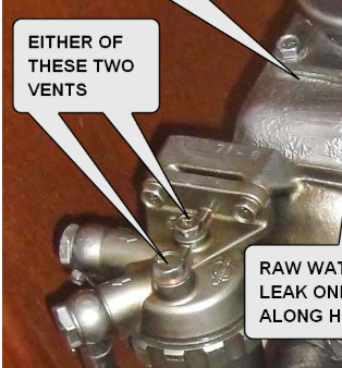

I agree it looks like diesel fuel leak from the fuel filter housing.
That's why I made a note to look at the two vents screws on the fuel filter :
I didn't expect to see AF coming from the vent screws but the OP may as well be on the lookout for any fluid leaks that might be present while looking for the suspected AF leak.
Your comments about colour (as well as other's comments) add to the thought that this "may" be a fuel leak rather than an AF leak.
