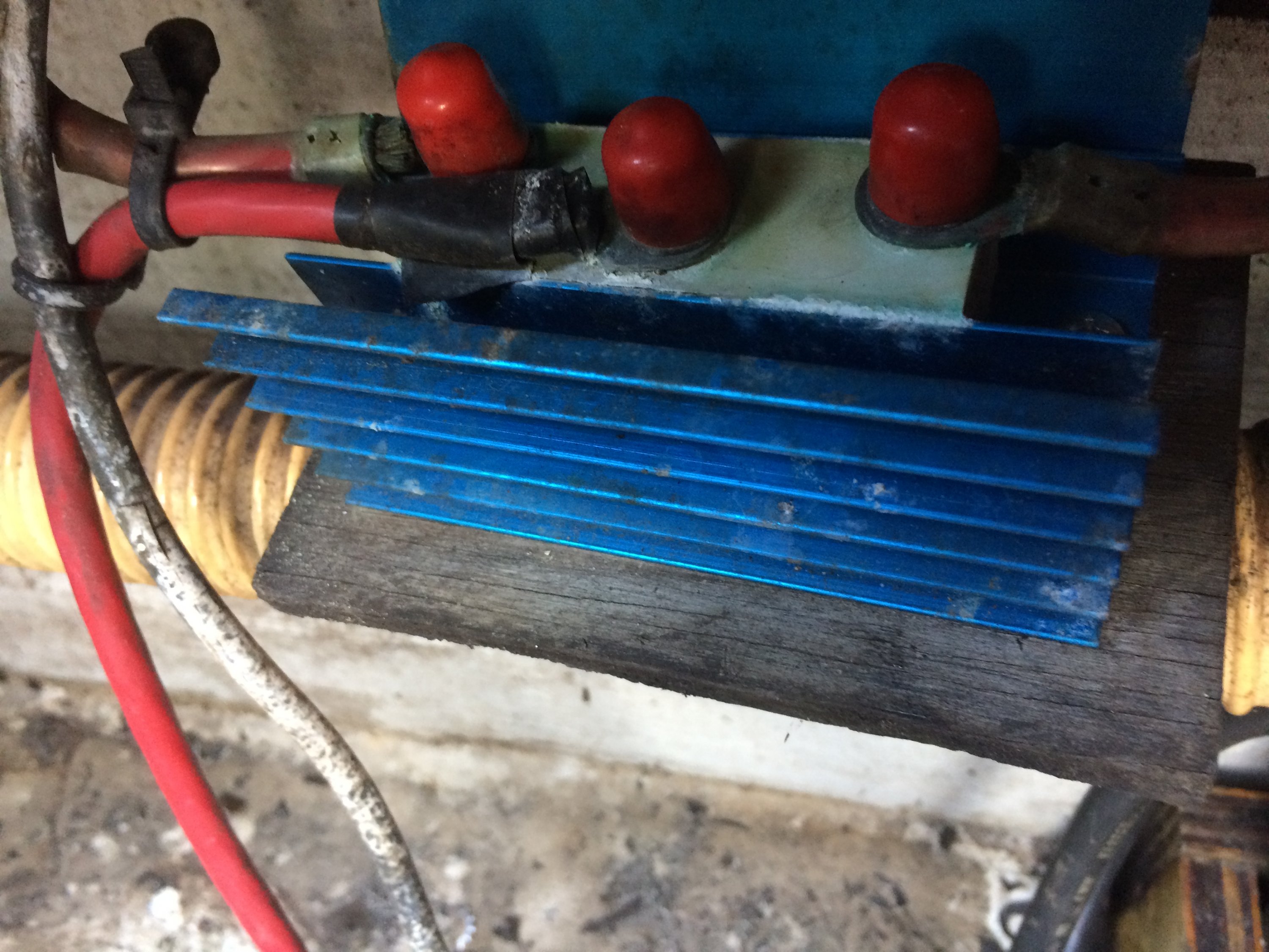

While we're on the subject of batteries - this is a battery isolator, right? It keeps a weak battery from draining a good battery while on the "All" switch and not charging? It allows charging of both batteries while set on "All"? In this case the charging comes from a 55 amp alternator. As I understand from recent re-reading that the isolator's negative attribute is the loss of a volt of charging voltage across it. It could be replaced with a combiner to not have the voltage loss. Am I summing up a lot of information with some accuracy?
Yes & get rid of it...
It odes nothing of the sort on ALL..... On ALL/BOTH your batteries are manually in PARALLEL and free to be discharged all the way to 0% SOC together... A diode isolator only prevents back-draining when the alternator is OFF. When the alt is on creates as much as 1.0V+ of voltage drop when the alternator is running......
Nope... It does not require ALL/BOTH to charge both batteries.
That and it also can't be used with other charge sources that require a 12V signal to boot such as solar, wind or smart chargers.
I would look at that as should be replaced with a combiner, if you ever desire decent charging performance...[/QUOTE]
