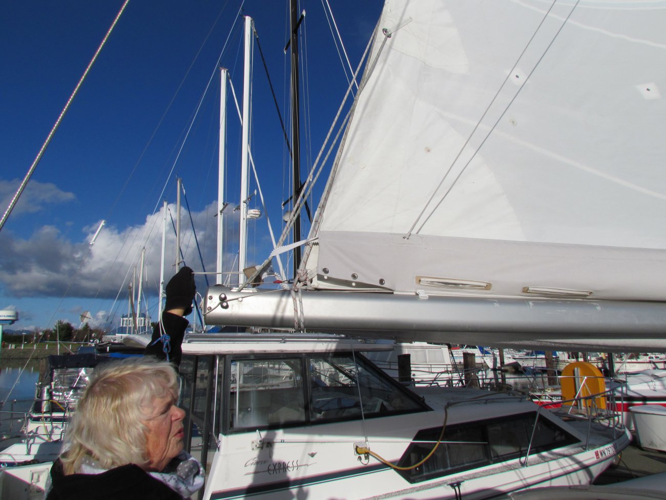

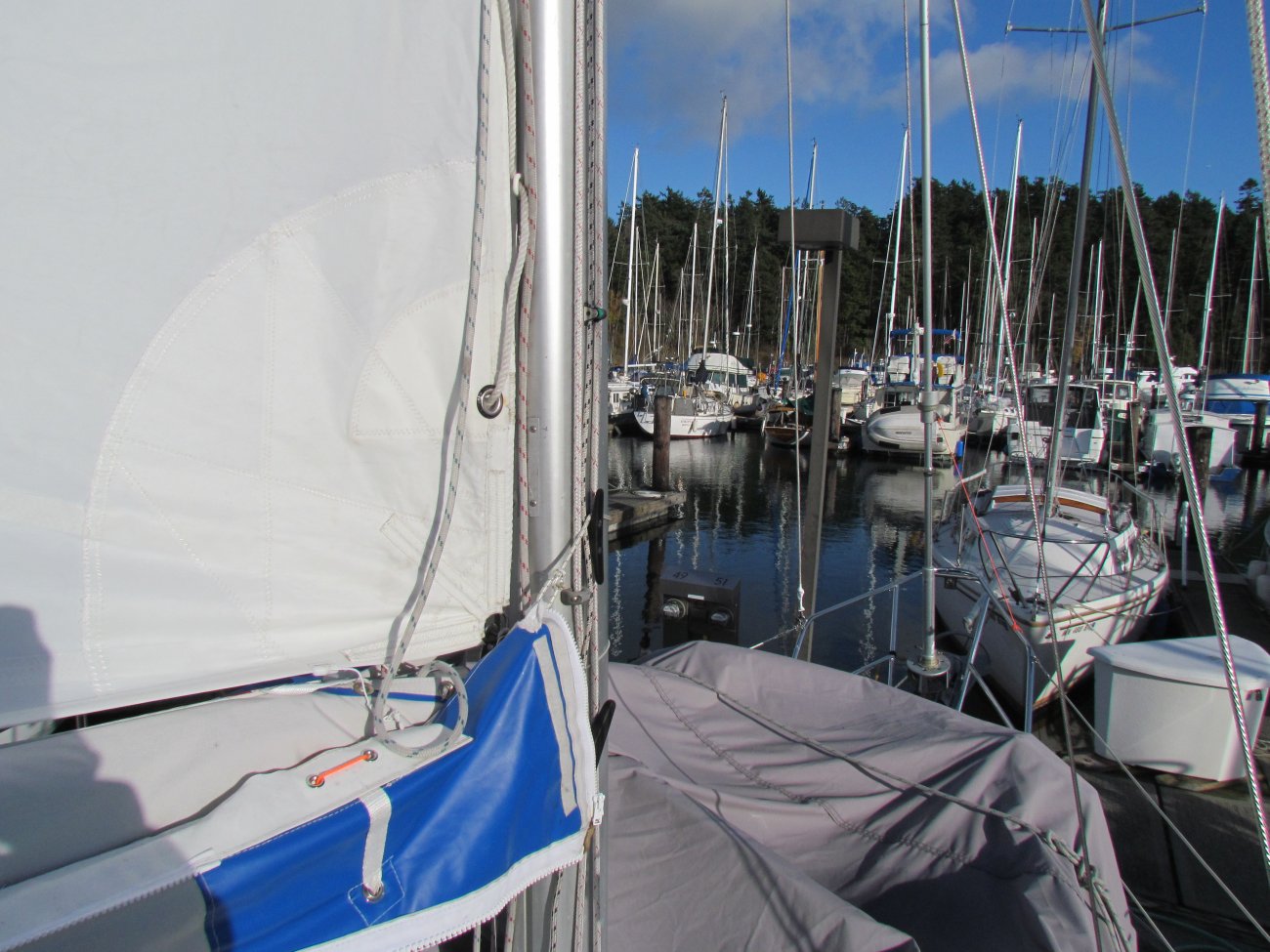

How does your O'Day's new sail attach at the clew? And how's it working for you? I had Precision make me a loose-footed main with a slug at the clew. I don't like the slug; there's too much pressure on that small bearing surface for convenient outhaul adjustment. I've been thinking about cutting it off and rigging a clew strap, but maybe Sailrite's outhaul clew would work.

Clew strap I have is double sided Velcro. I would go that route.

What kind of mechanical advantage does your outhaul provide?
If you want to adjust the outhaul manually (no winch), 4:1 would be the minimum. If you don’t have enough mech advantage, the wind pressure in the sail will be stronger than you are, no matter how the clew attaches to the boom.
I Havent seen your boom, but I doubt that the clew slide is the underlying problem, unless it’s the wrong shape or size, or unless the groove in the boom is in really bad condition. There are literally tens of thousands of small boats like yours, and bigger, with clew slides that work very easily, with 4:1 outhaul. For exmaple, catalina22s
On boats that originally came from the builder with a footed mainsail, the outhaul was “set and forget”. The builder didn’t expect you to adjust it while sailing, so they didn’t provide the capability to adjust it. If you switched from a foot mainsail to loose footed, you probably need to upgrade the outhaul.
Another option is to simply take some power off the main sail, adjust the out haul, then put the main back into the full power position.

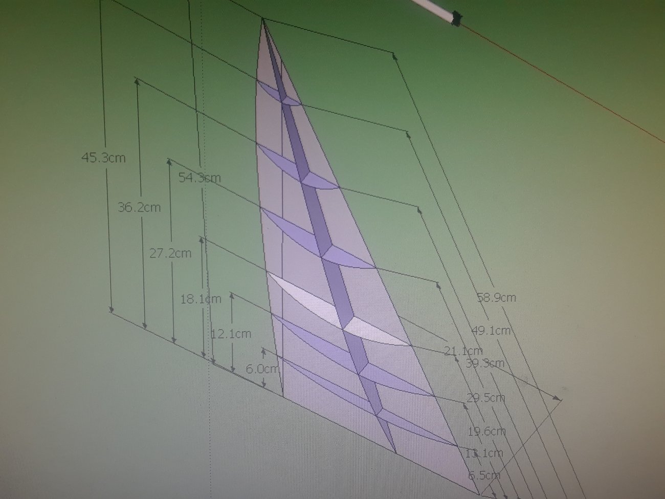

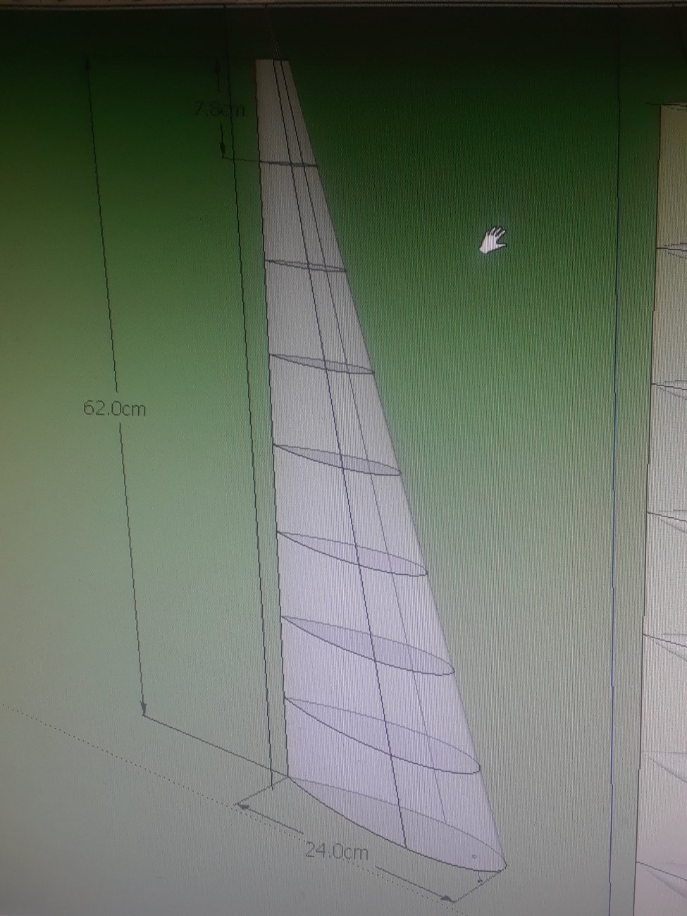

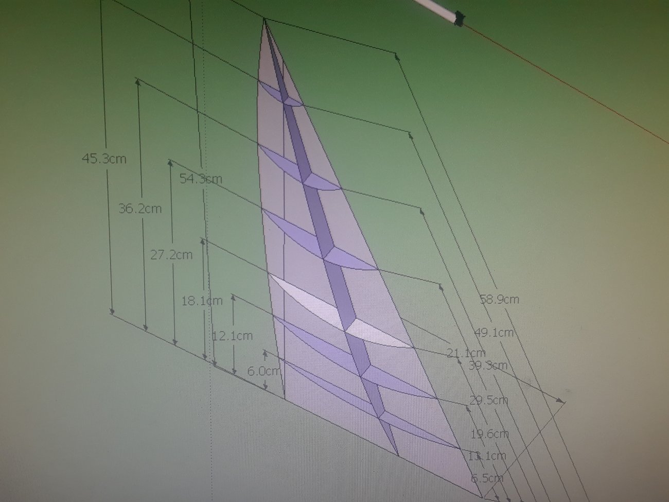

The bottom third of the bolt rope sail does not attain the same overall shape of a loose foot. This has to impact the airflow. If you look at all the pictures of the a380, there’s a huge shape where the wing attaches to the body.
bolt rope sails serve one purpose. one and done sail shape. The bolt rope completes a triangle plane. This connection of segments and the overlapping seams fixes the shape of the sail in all three dimensions. really all you can do to change sail shape at this point is bend the mast or adjust the boom up. Check out the design for the jib below. to make this jib i cut out a wood frame, stuff it with foam, then sand until the foam matches the wood. i then heat shrink gift plastic over the mold with a blow dryer. the resulting sail is a one piece 3D sail. the important part of the design is i can then tie off the three points with full tension. no matter the tension the shape is exaxtly as it was molded.
heres the rub. look at the bottom 1/3. The draft is terrible. the bottom third is wasting lift in the part where the wind is the least. look at the top third. the camber increases on the way up, when at higher wind speeds the angle of attack should be less. this was one of my early designs and not only was it a pain to make the molds, but the performance was terrible.
the other design, looks more like an airplane wing. the draft is proportional all the way up. This is a loose foot. This shape has the same angle of attack from top to bottom, but there is a problem. The shape is not dimensionally stable. infact, there is no shape once the sail is pulled off the mold. you just end up with a flat piece of sail with the foot a bit longer than what you started off with. in fact, even when put on a rig, you cant control the shape well, the max draft moves anywhere it wants to depending on the pressure. ive heard the shape is a "canternary". this shape still works great for RC models though and is super easy to design and cut out.
on a loose fitted main the sail, when all three corners are taught should have molded 3D shape, with crappy lift down low.
When the outhaul is lessened the foot draft will deepen, but at the expense of not knowing where the max draft will be at the foot. if one is looking for a boost in calm winds the extra curvature anywhere is better than no curvature at all.

You're talking about a hobie getaway mainsail now. notice how they have massive amounts of twist to "bleed" off the lack of dimensional stability, and then full battens everywhere. im sure there is a draft in those still. in other words, it probably doesnt lay completly flat on the ground, loose foot gives you more draft options.

Total BS. high tech sails are absolutly molded. they start off with a platform that has been shaped to the final product. laminate is layed over the shape, next, fibers are layed in various directions, finalkt another laminate is sealed on top of that. the result is a fiber sandwich. when the final product is pulled off the mould the sail fibers and the laminate are in the shape of the mould.
i tried this at home on a small scale to make my heat shrink sails stronger. the sails were so strong i couldnt get them to turn inside out on a tack. them suckers never flattened out.
the old school technique is to broadseam. same thing. if the sail is broadseamed it should be dimemsionally stable, since the broadseam pulls the fabric off the plane.

i guarantee if you suspended your main by three points say two trees and your truck hitch, you would see a beautiful moulded shape hanging down. thats the dimensinal stability that gives you repeateable sailing. thats from broadseaming. loose foot just lets you open the draft more, but somewhat randomly.
