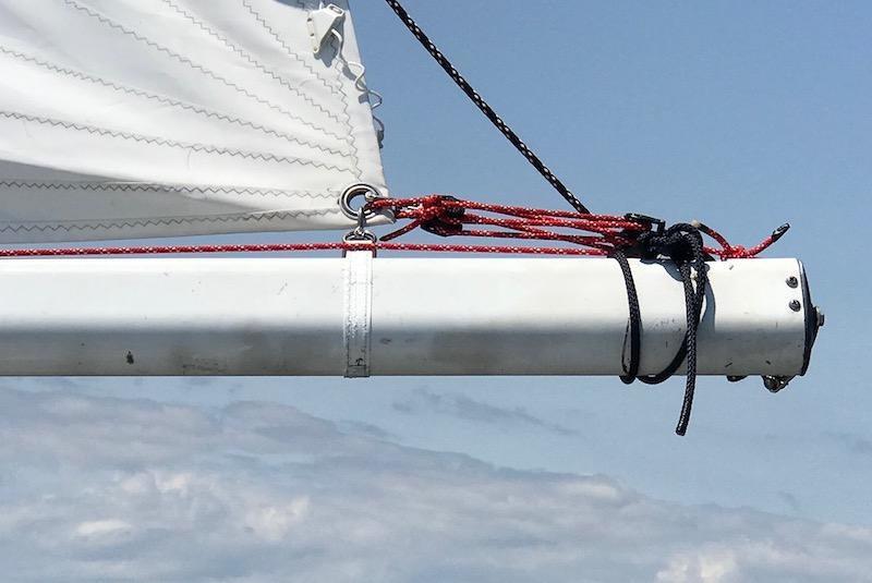

John, a lot of loose foot mains have a clew strap. It goes through the clew cringle and then around the boom. I've read somewhere a clew strap is stronger than a slug in the track. The slug is made to work in conjunction with the foot rope. If you have a car like @LeslieTroyer I imagine it would be strong enough.
Not hard to sew one up. I've made a couple out of dyneema strap and velcro. On my latest one I sewed in a ring and use a shackle to connect it to the clew.
Here's a pic.
