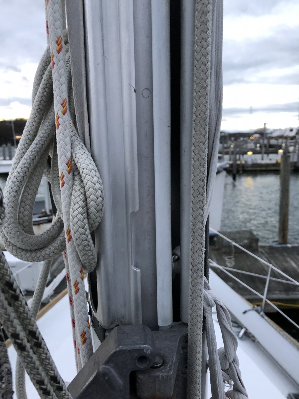

My boat has in mast furling however the mast also has a track for a traditional main. The boom as well can be converted by simply removing the top track.... US spar 2095.

Adjacent to your sail slot should be a track for a traditional sail with luff tape. Invest your money in learning how to handle a furling main. Most sail schools use furling mains, how hard can it be?

This is my mast... in mast furlering system US Spar. You can see that there is a track for a traditional mast. Boom is the same.

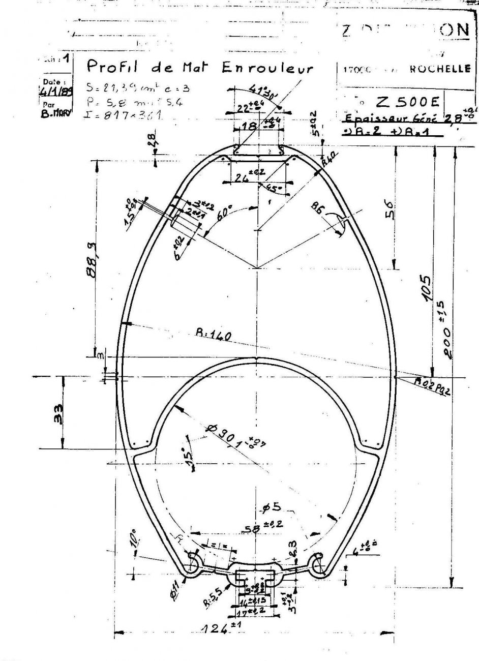

**It has been done. The Z500E mast has a built in track on the backside of the mast.
Mast comes out to remove all the furling gear, re-lead the halyard.
