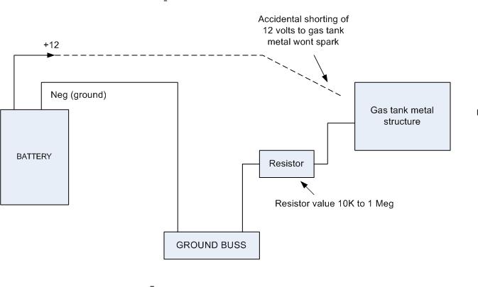

Just something to add on metal gas tank ground based on something we do at a factory that makes electronics.
You don’t want a spark near a gas tank and there is a good chance you have DC power somewhere near the tank.
If you put a ground on the tank, it will keep static from building up - which is good. But if you accidently have 12 volts come in contact with the grounded metal tank, for sure you will get a spark.
However, if you ground the tank using a resistor (common to use 1 Meg in Electronics manufacture for "grounding"), the resistor still insures that there is no static buildup. But it limits current in case of the 12 volt touching the tank so no spark.
I don’t know what boating standards recommend (likely Mainesail knows) but I thought I would throw this out..
