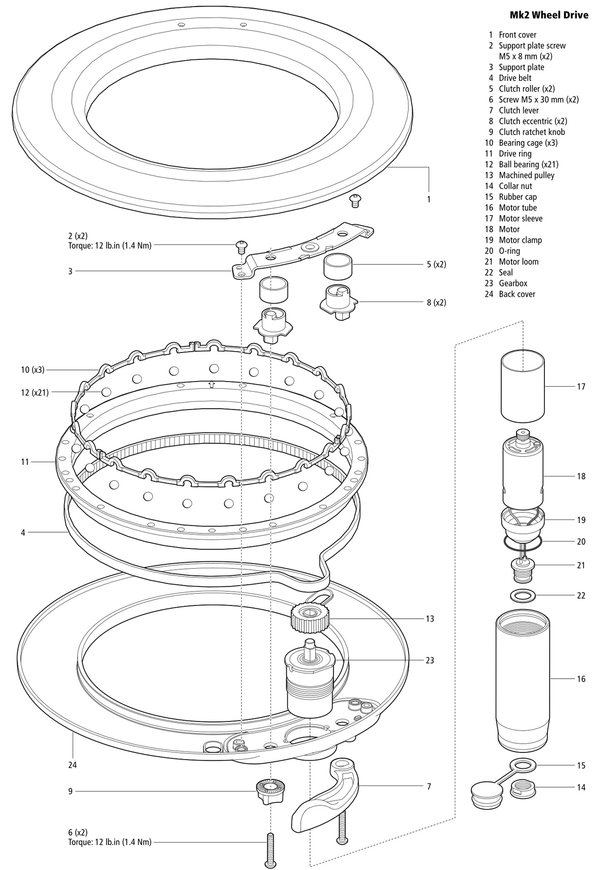

Your boat has about the same displacement as my Cal 35. I have a wheel pilot on the boat. Cruising in winds of less than 20 knots, with the sails balanced and the boat heading into the wind, the wheel pilot does fine. The AMP draw is minimal, and when motoring, it is of no concern. The design and materials are weak. I mainly use it for motoring in calm and mild conditions, where there is minimal stress on the motor.
When the Wheel AP is making numerous corrections, the belt clutch will release. This is a design flaw. I use a rubber band to put tension on the clutch, keeping it in place. All will then be well whether sailing or motoring.
Let the wind and waves (greater than about 2 feet) swing to the stern, the stresses on my rudder become more than the motor can handle. It can fight against the water pressure, but not recover swiftly as the wave passes under the boat. This puts a strain on the Drive Ring, and it will fracture. Mine did after about 6 years.
The Linear drive is a different design. There is a rod that moves in and out of an electrical motor. It pushes or pulls a stub tiller that you put on the rudder shaft. The unit is more robust and can handle your boat in more strenuous conditions.
The CPT AutoPilot was mentioned.
It is a wheel system that uses a more robust design than the Raymarine Wheel pilot. It's one flaw, in my mind, is the exposed belt and gears. I never liked working around exposed belts. Things can get grabbed and drawn into the gears. It has a lot more power to drive the wheel (86 ft-lbs).
