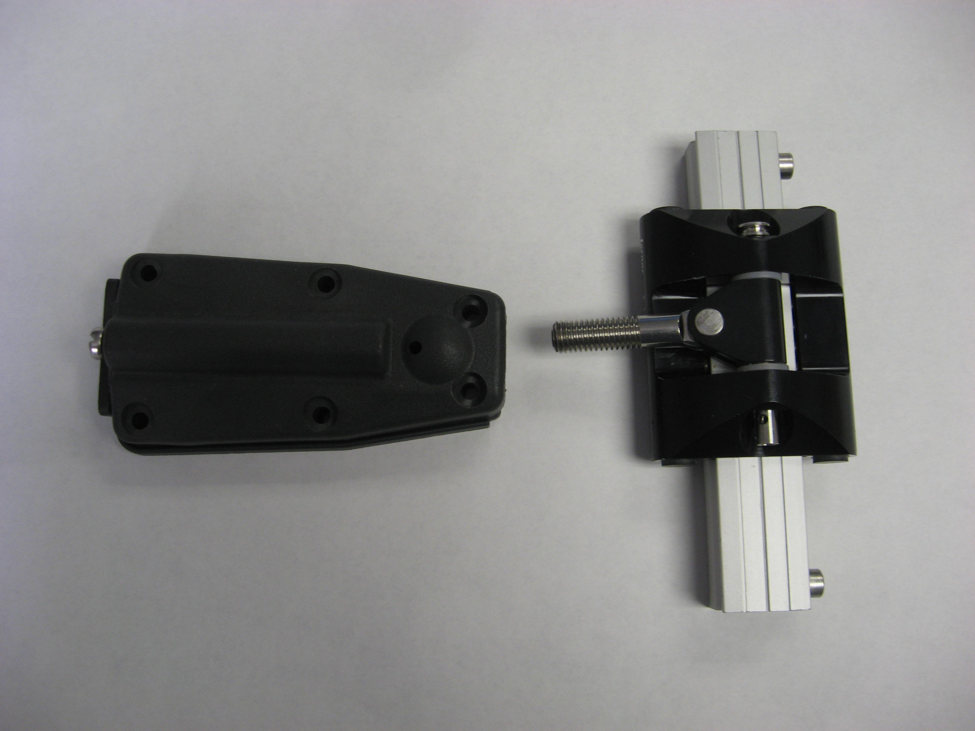

@Roland5048 Strong Track is a system to replace the standard mast track for the main. The system uses a HDPE material for the track system. Very slippery track. It provides a quick way to drop the mainsail with out the traditional hang ups due to corrosion or dirt that typically occurs in metal tracks or luff slots.

Tides Marine Strong Track system for mast hardware, which makes raising the main sail very easy. I want to get it so Sue can raise the main without such a struggle. Besides, I think it is the option that many consider when thinking about purchasing a full-battened main. I guess I'm thinking about it in the opposite sense, since I'm not talking about replacing my main. I hadn't considered the longevity issue. Our rigger is pretty reasonable in cost, so I think it probably makes sense to consider the battens when longevity is a positive issue. I have a nice Doyle main sail - dacron cross cut to be sure. I haven't noticed any wear due to the dutchman system so far.

I replaced my main a few years ago, and went with a full batten sail. North sail recommended the strong track As was stated because of the pressure the full battens put on the sail track.
i like the set up, and I like the strength and quality of the slides.

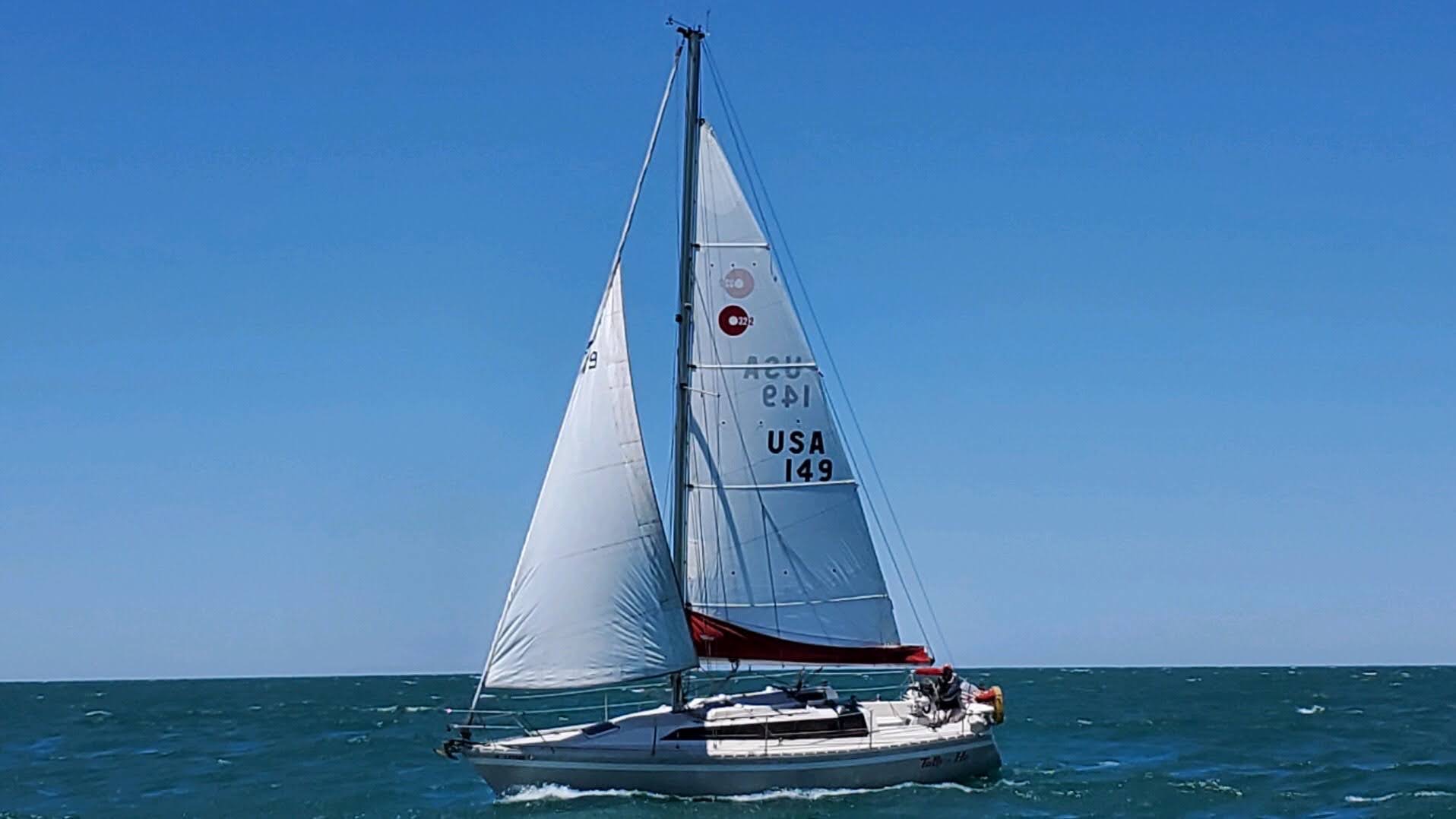

True Greg. The image of your full battened wing clarifies the information.
Your boat is charging along. One question. Would the sail in that wind have the same shape without the full battens? Would that wind condition need more or less trim options without the full battens?
I look on the batten choice as a part of the overall system to be used in the sailing conditions expected by the owner. In light and moderate wind speeds, the full batten design can help hold a sail trim shape more easily. There is also the possibility that the battens can become a pain if the wind is not strong enough to invert the batten when you tack, then you have to grab the boom, whipping it back and forth to invert the batten to the correct tack and shape.
A full mainsail with full battens plan has to consider the mast track. The force put on the mast track by the full battens induces friction on the sail slides. Strong Trac was developed to address the friction issue.

It certainly might John. Winds were full and my angle of attack was great.
But I am a fairly lazy sailer too, so the less fussing I have to do with the sails, the better.
As you can see, I am single-handed, and conditions were a little challenging IIRC. I see I have both sails reefed (Unlike me;)).
I am a big fan of full battens and the Strong Track. The high-quality stainless slugs are robust and slide easily in all angles. I can pull down a reef or shake out a reef pretty easily without rounding up into the wind…and usually by myself.
But to each his own. It is t for everyone or every boat.
