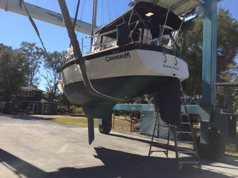

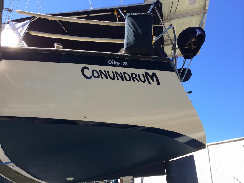

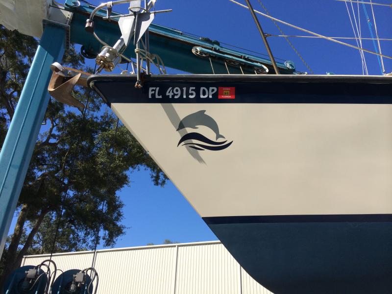

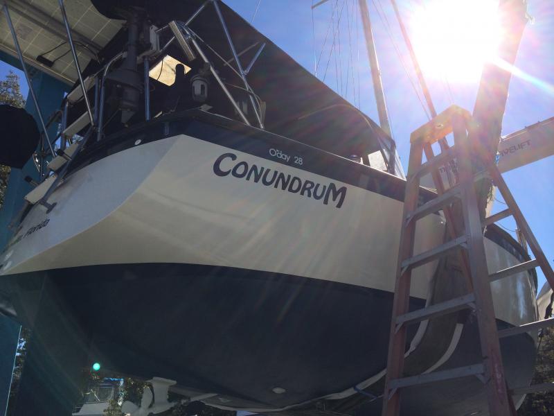

So they put my boat back in the water today. I had to rush to put the graphics on but pulled it off. Posting pics of the finished product. Please note the new Oday 28 logos look great (anyone needing them I can send graphics, also talked to my local graphics guy about making them). Definitely stripping the paint down to gel coat next time I take the boat out. I do all my own graphics work.

Also looks like a fresh coat of paint. What did you use and what colors? Looks like she just left the factory.

Great looking boat! That boat must be sooo proud among the fleet. I bet she takes good care of you. You did a nice job. I especially like the lettering and the decal.

The main hull is was done in Pettit EZpoxy in Off-White. I used a little over a quart (3 coats). Striping was done with Interlux Brightside Polyurethane in Dark Blue. 3 coats was about half a quart. The blue really needs multiple coats to look good and scotch bright scuffing between coats is a must.

As the others said, very nice. Was the Brightside Dark Blue a close match to the original blue? Hard to tell shades from the photos.

Its actually darker which is what I was going for. I have alot of Captains Navy on the boat so I was trying to get a little bit of uniformity. Of course Dark Blue is different for everyone it seems.
Ironically the bottom paint is SeaHawk Cucote Dark Blue....not nearly as dark as the Brightside.
