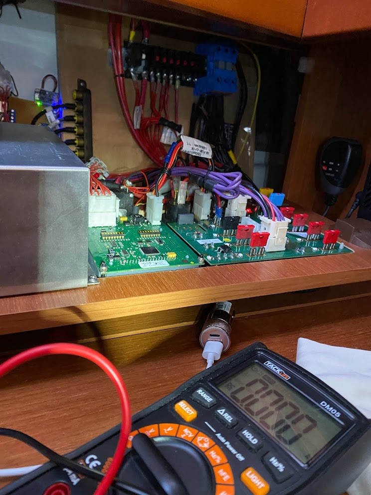

Hi, just experienced a nearby lightning strike too, blew my lcd panel out! Fuse in back, keeps blowing. Think I'm going to replace with this PICO Battery Monitor - Simarine and some sensors and the N2K gateway. Anyone have experience with this brand?
