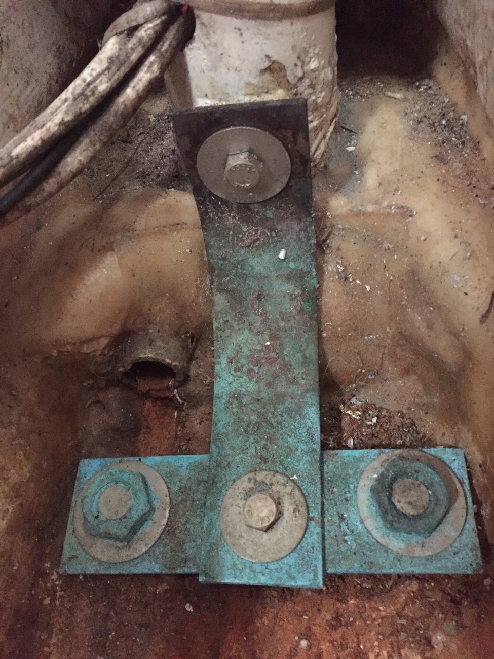

One more thought on your compression post. For reasons that I cannot explain, Hunter has the bilge water collect at the bow. It may come in at the stern, say, through the rudder post, but it still runs aside of the bilge, inside the hull, until it gets to the bow. There it accumulates, unseen, until it rises to a level higher than the fiberglass encasement block at the compression post base. Then, and only then, it flows over the block and into the bilge. The bilge is sloped toward the stern and there is the bilge pump. Why? Who can say? Anyway, the point is that your bow is low and the accumulated bilge water in the bow may be adding to your problem. This bilge water is also likely quite foul. When I replaced my compression post I added a pvc pipe that passes through the block to lower this barrier to the bilge water. Photo below:

Roy,
I'll remember to follow your example if I have the pleasure of chiseling out the current post.
There seems to be a fillet of something behind the grounding strap attached to your mast. If I'm correct, does it serve a specific purpose?
Greg
RoyS
Jun 3, 2012
1,742
If we are talking about the same item; I had a welder install a small flat aluminum plate about 1" square on the post base. I drilled and tapped that to attach the grounding bus. Important to note that there is a stainless steel washer between the copper bus and the aluminum post to prevent electrolysis. The plate was installed while the post was out of the boat.
