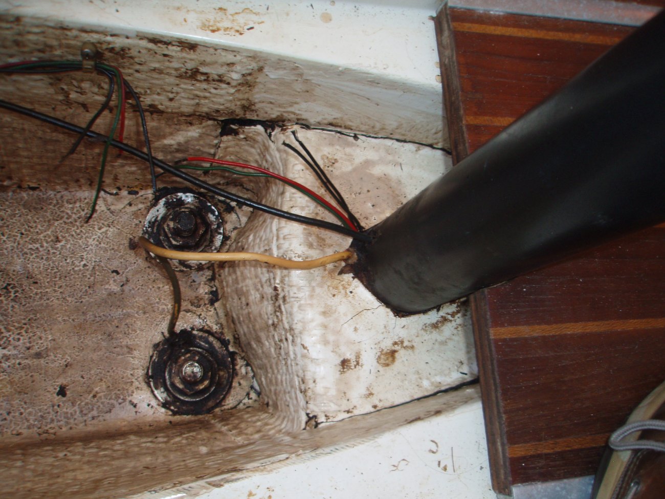

Another issue is that the wires to the anchor light/ steaming light don't have continuity. I've attached a picture that shows how the wires seemingly go under the compression post base. I should have taken an image from the other side, but there didn't appear to be a hole that the wires are snaked through. The VHF cable does have a somewhat ragged hole that it passes through. How is the base of the compression post secured? Is it a flange that is glassed in place? It doesn't seem to be bolted to anything. Current owner said that the riggers said the mast should be removed to rewire which makes for a very expensive light fix. If the current wires are pinched by the post base, I doubt they could be used as a messenger to snake new wires. The vhf cable hole could be cleaned up and would have enough room for the light wires possibly. Has any body attempted to do this while at the top of the mast?

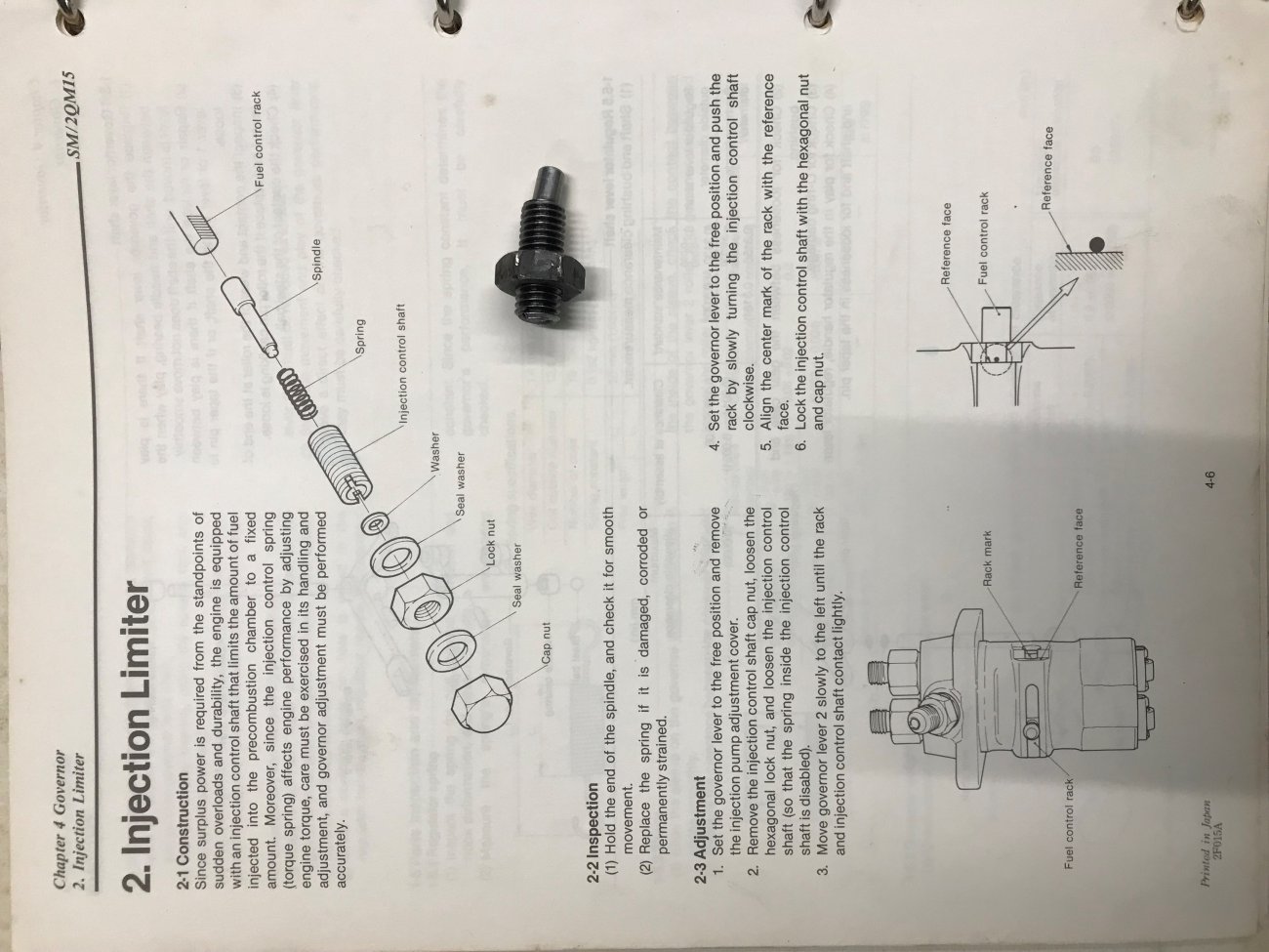

Another question is about the original 2 cyl Yanmar. I don't have a picture of the actual part but it was described a limiter. The part it self looked like a small spring load plunger that apparently pushed on another rod in the fuel delivery system. The plunger end was bent. Apparently the mechanic is having a problem finding a replacement and that it may need to be machined. The part itself is small and simple so machining it shouldn't be a big deal. The question is what caused it to bend? From the picture I'd guess the plunger diam was maybe 3/16 to 1/4 inch diameter and I presume it was steel. That would take one heck of high axial load to bend it. I've asked the owner to send me a picture of the part which hopefully he'll do soon. I realize these details are probably too sketchy for somebody to know which part I'm talking about...but there is always hope.

I don't specifically know about the 33, but the water pooling where you've described appears to be common on these boats. As far as the wires you've imaged, I'm not understanding your question exactly. That image looks like the base of the mast where the wires come out, it would seem to me. Where they would exit is at the light fixtures. Regarding why the limiter rod is bent - no way to know unless the PO knows something happened.

Wiring.. You show the way the wires enter the compression post base but not where they reappear. Is there continuity in the area that they disappear and then reappear? If not then you have located the problem. And. You will need to discover a solution. If there is continuity in that area, then you need search further. Where are the lights on the boat? Could the fittings be the issue (that is a common problem). Corrosion of the wire connections exposed to the moisture.

Thank you for your comments. Unfortunately my picture isn't worth much in showing the problem. The small pair of black wires at 11:00 and the red/green wires at 10:00 do not enter the compression post through a visible hole. It seems quite probable that there must be a hole or notch in the post below the layer of glass that are not visible. I can't believe that by design those wires would be pinched by the post. Unfortunately I don't think new wires could be pulled by taping to the existing ones and pulling up the mast as those wires seem tight between the post and the fiberglass layer. So part of the question is how does the bottom of the compression post look? Knowing that might tell me if it would be possible to offset the load from the post and move it up enough to feed wires into it (without dropping the mast).

The engine problem is a bit worrisome, but I'll probably need to speak to the mechanic to better understand the situation. I thought that maybe others with this boat or engine might have encountered a similar situation.

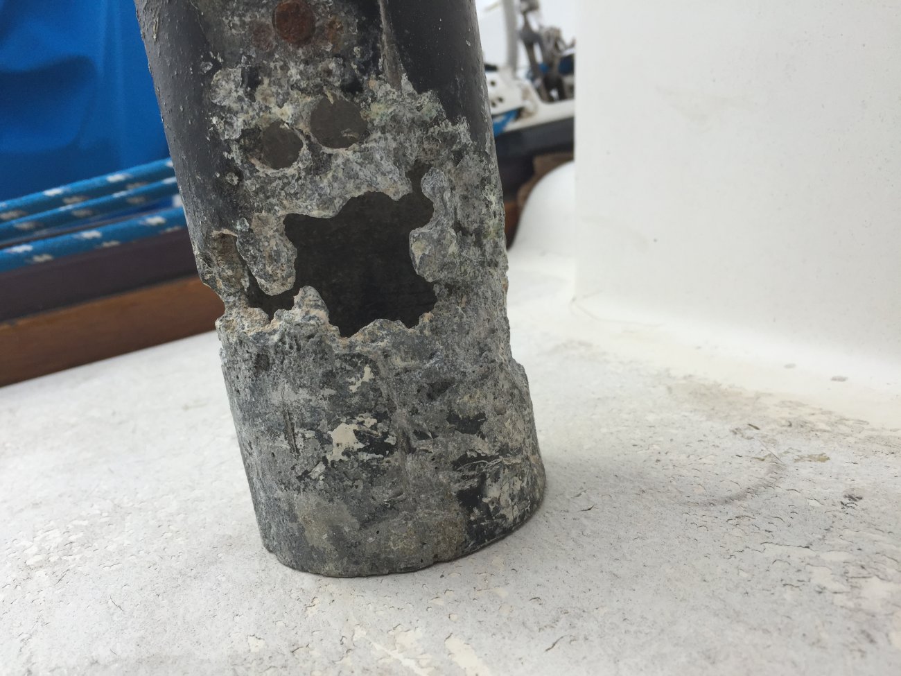

I have a 1980 H33 and some bitter experience regarding the compression post. The bottom of the post has a casting exactly the same as the casting on the top of the post. That casting simply sits on the bottom of the bilge encased in fiberglass. That fiberglass may be chipped out to expose the base of the post and the casting. My original compression post had a visible hole above the fiberglass block for the wires to enter. Some prior owner added a copper shunt strap which he fastened to the post with a tapped in bolt. The other end he fastened to one of the keel bolts. This caused great electrolytic damage to the post. See photo of old removed post bottom.

thank you. That picture is very helpful yet scary. The post I looked at only has a hole where the VHF cable goes into it. Was the hole in your post above the fiberglass? How far down into fiberglass "well" is the bottom of the post and casting? The casting at the top on the boat I saw was maybe 1-1 1/4 inches thick. If it is any deeper, then I guess a fare amount of the fiberglass would need to be removed. In the picture I posted the white wire is presumably a grounding wire that goes into a visible caulked hole. Not sure how that is connected to the post but it wouldn't be replaceable without removing the post as far as I can tell.

The compression post bottom casting is on the very bottom of the bilge. That casting is exactly the same as the one on the top of the compression post. Both are a slip fit. The wire hole on mine was above the fiberglass. If you study the photo that you supplied it appears that there is an additional layer of fiberglass on the top that may have been added later and possibly covered the original wiring hole. I removed the entire fiberglass encasement with a wood chisel and hammer. The post is replaceable if necessary. To remove - Remove mast and set aside. Purchase adjustable lally column in Home Depot for about $70. Chip out fiberglass to expose bottom of compression post. In my case the fiberglass encasement was not difficult to separate from the bilge bottom and sides, it was not chemically bonded to these surfaces. Unbolt mast shoe from deck. Slightly raise (distort) cabin roof about 1/4" using the adjustable lally column as a jack to free post. Measure post and call Metals Depot (find on line) and order exact replacement length of Aluminum Structural Tubing. Paint, drill new post to suit. Reinstall post as original with new bolts and old mast base shoe. Using West System Epoxy cast a new block of fiberglass around the new post and old base casting. Reinstall mast. Of course, at this time you should take care of your mast wiring.

The owner was kind enough to send me a picture of the bent limiter which is below. I must say that I have a new appreciation of how much force a governor can exert. Likewise it is baffling why the limiter wasn't designed to resist such a force. I'll ask in another forum if anybody has ever seen something like this.
Greg
