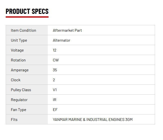

Thank You all for your posts. I apologize as I was away. This Hunter 27 has nothing on it electronically except for a VHF Radio. To summarize some of the comments:
1. First I accidentally connected a battery backwards (it was dark out and I was stupid) and it fried the diodes instantly! I replaced the alternator and it came with the sensing wire.
2. The boat needs new circuit panels as the previous owner chopped them up so I plan on putting in new ac/dc panels.
3. I would like to add the battery charger so when I am at a dock I can have shore power and charge batteries when needed.
4. I did actually just buy a regular battery switch since the existing one is no good either. A regular 1 2 both off switch.
5. lastly my main concern was not frying the diodes again and the sensing wire affecting the diodes if switching the power on and off.
I will have to look at the invoice for the alternator I bought. I know it was a replacement for the Hitachi and is 35 amps.
