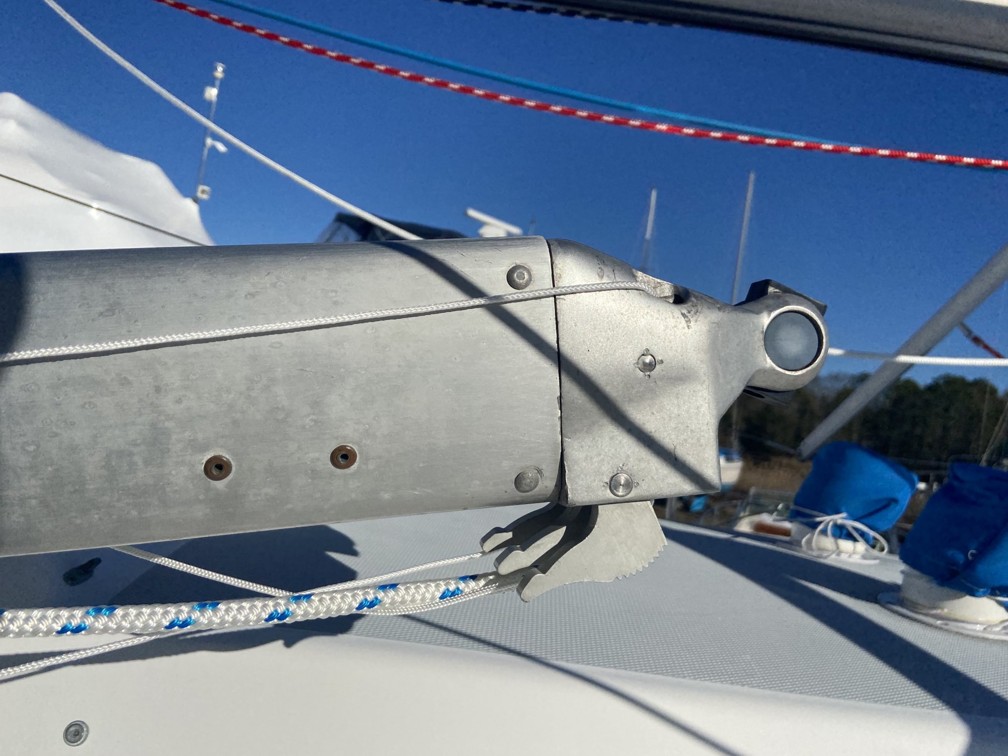

Tried to replace outhaul and was blindsided by a block hidden in the boom. I thought it was just a straight in then out 1:1 purchase. It seems there is an eye inside the boom where the rope is fixed. There are 2 mystery rivets near the fwd end on the side of the boom but the only way to access this seems to be drilling out the rivets that atach the boom end cap and removing the cap. Is this something Hunter (or Selden) would have done?

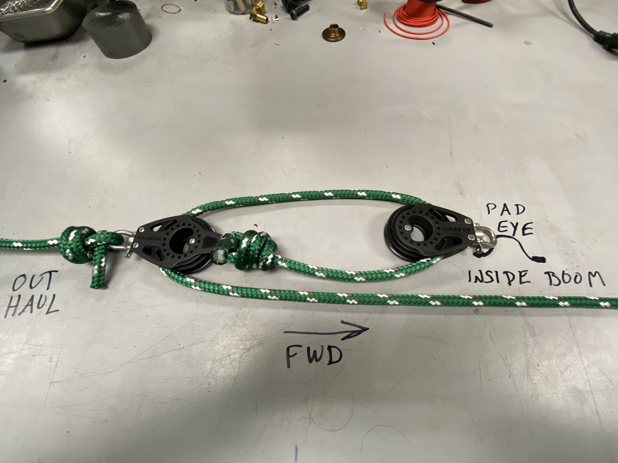

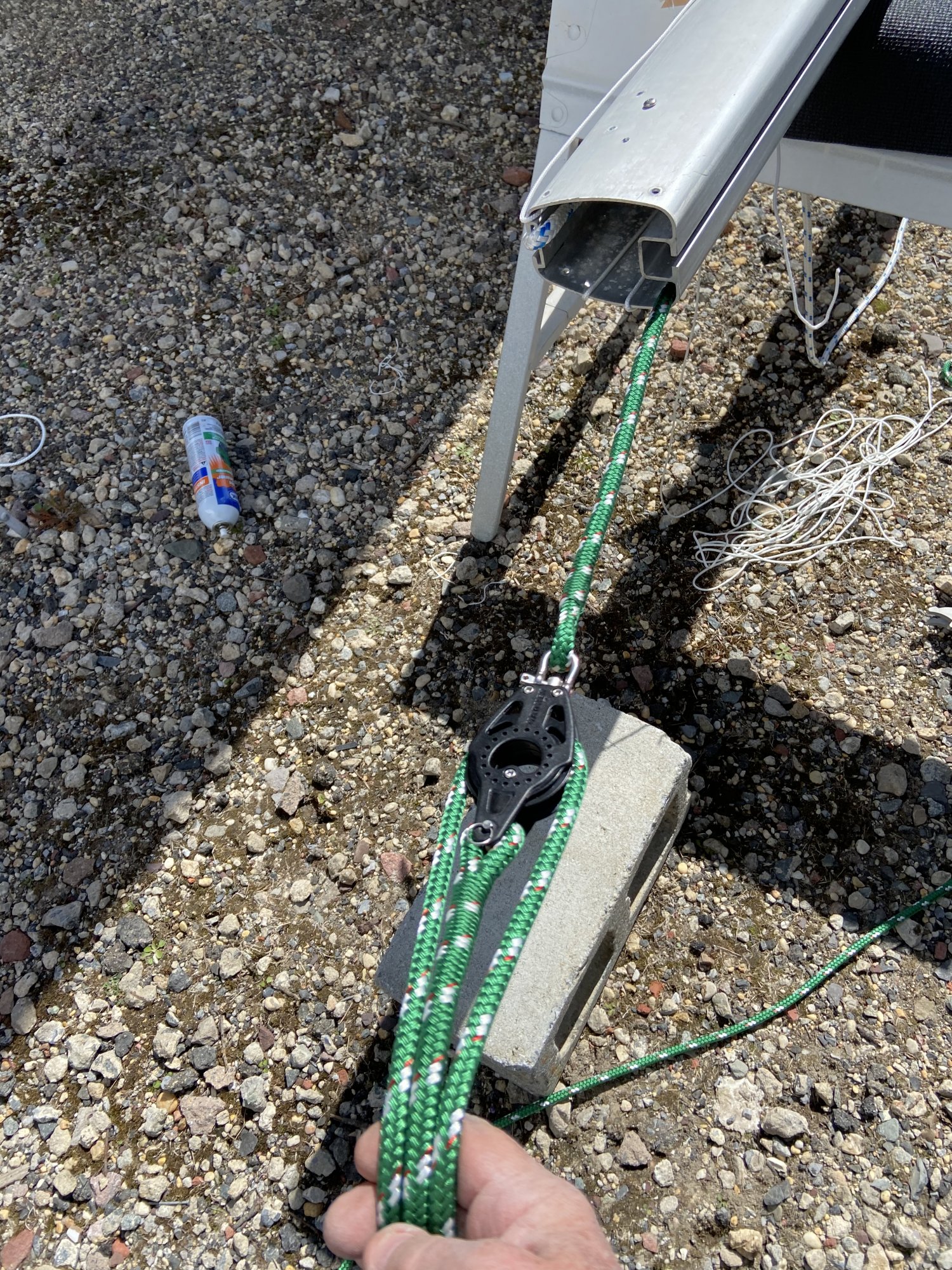

Exactly. I wound up drilling the rivets on the fwd end cap and installing a 2 block system as shown. Carbo low friction blocks & 3:1 purchase. Can't wait to try it with the new loose foot main. Boat splashed literally 4 hrs ago. Oh and I didn't notice you sail a 310. Love my boat.

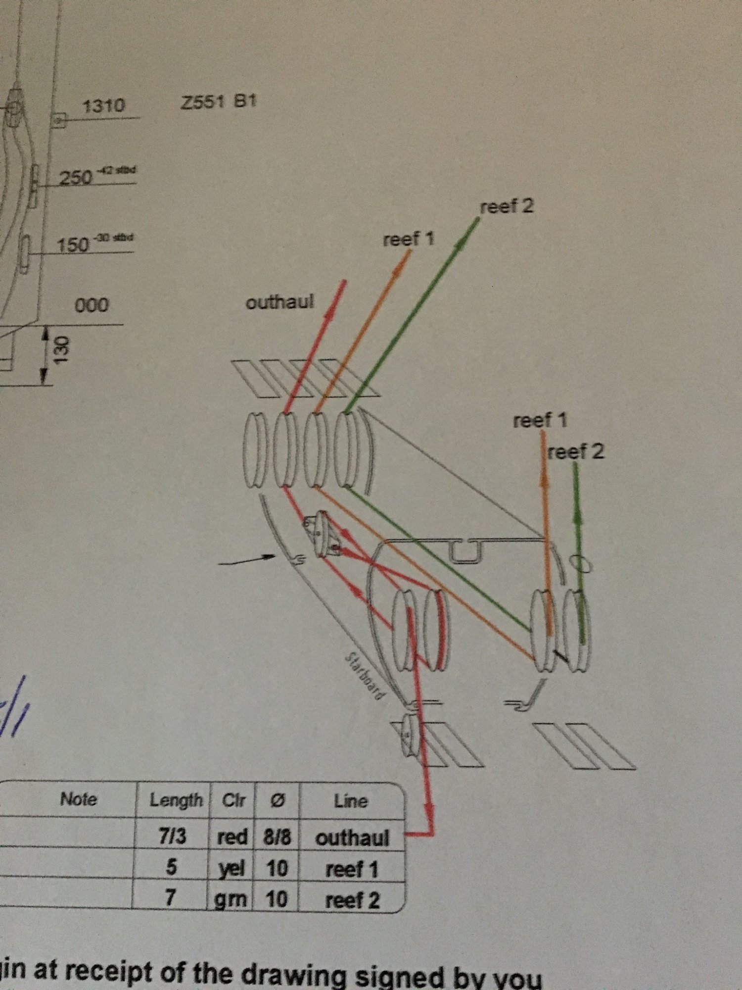

This is how the outhaul is supposedly set up in a US spars boom. The block with becket is not attached inside the boom and can be accessed from the aft end without having to drill out the rivets in the end casting.

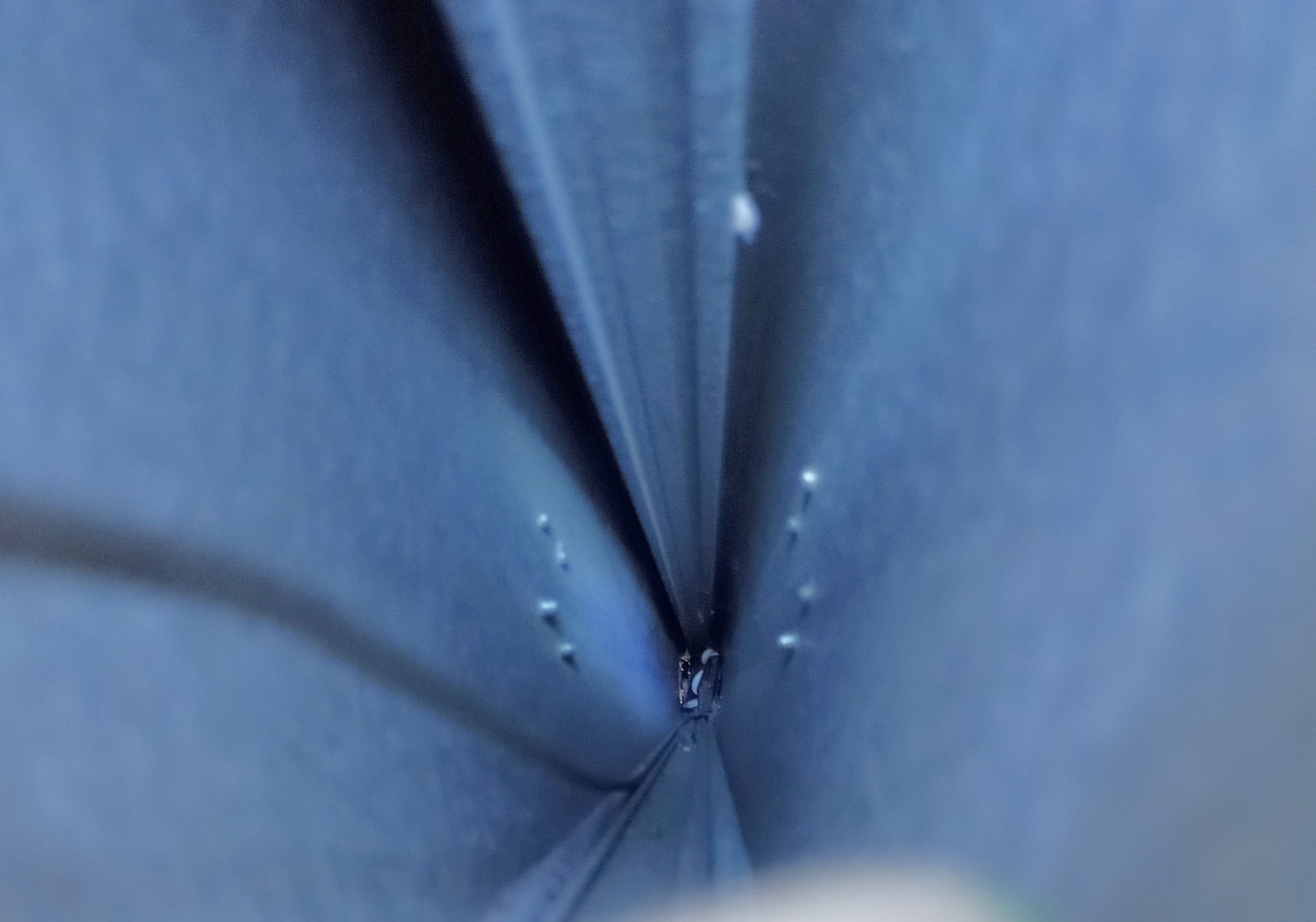

Accessed the block from the out board end of the boom with a long pole with a screw in it but the block seems jarred (zoomed photo attached) as is the outhaul itself (jammed though it's loose at the mast end of the boom).
