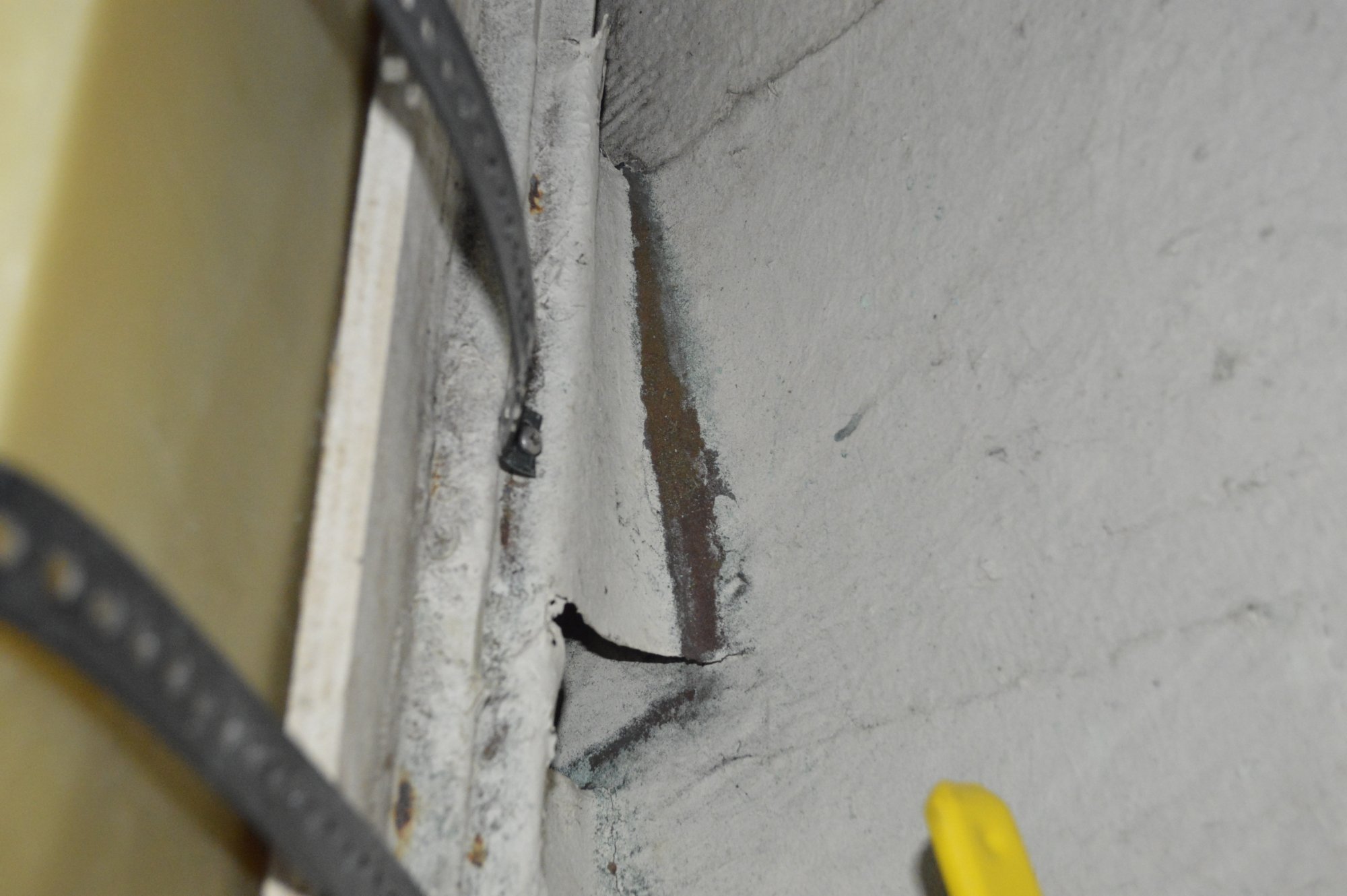

@Peggie Hall HeadMistress
I think i was not clear. Replacement wood platform to be tabbed to the hull. Tank to be strapped to the platform. Original version shown below. Looks like 3-4 layers of glass were used to secure wood to hull. The tank sits inside small compartment.
