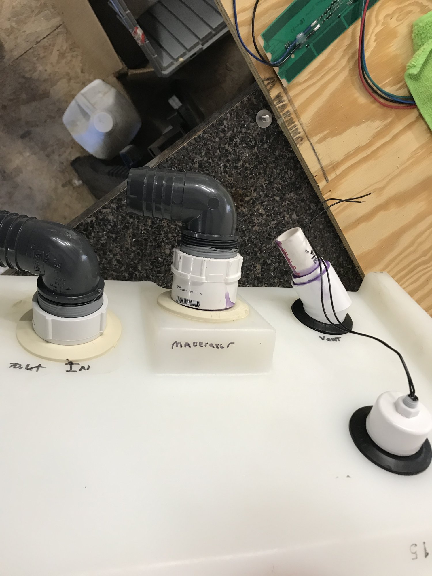

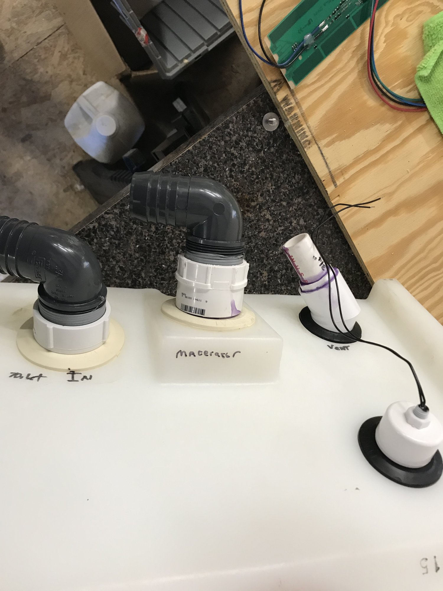

I have read "the book" and I am ready to replace tank and all hoses. There is a nice post on the site for the same boat so i am nearly set.
I have ordered a tank with 3 female NPT fittings on top, 2X 1.5" for the business in and out and 1X 1" for the vent. So far, so good.
For the tank inlet, I am using a male threaded elbow (1.5" NPT) with barbed end. Same for the tank vent.

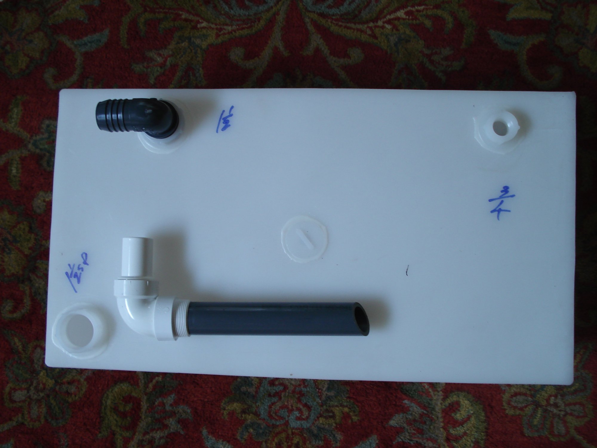

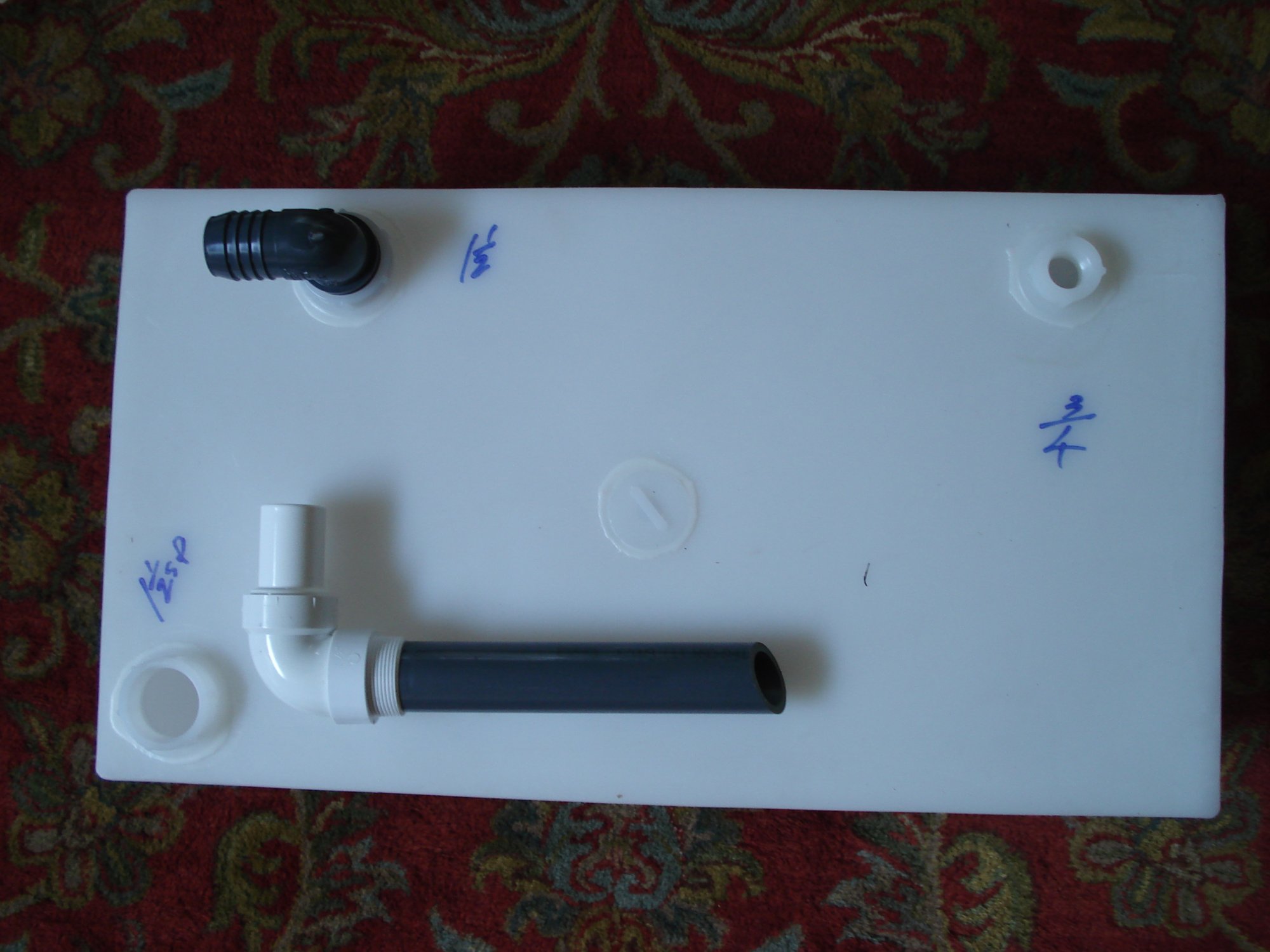

For the tank outlet, I am trying to make/buy a dip tube but when I place all the components together, the tube that would fit inside the male NPT fitting is either too small or too large. The opening is exactly 1.5" but the standard pipes do not fit inside.
The photo shows what i am trying to achieve. Ideally, I would have a barbed end but anything close to this will work. What am i missing?
