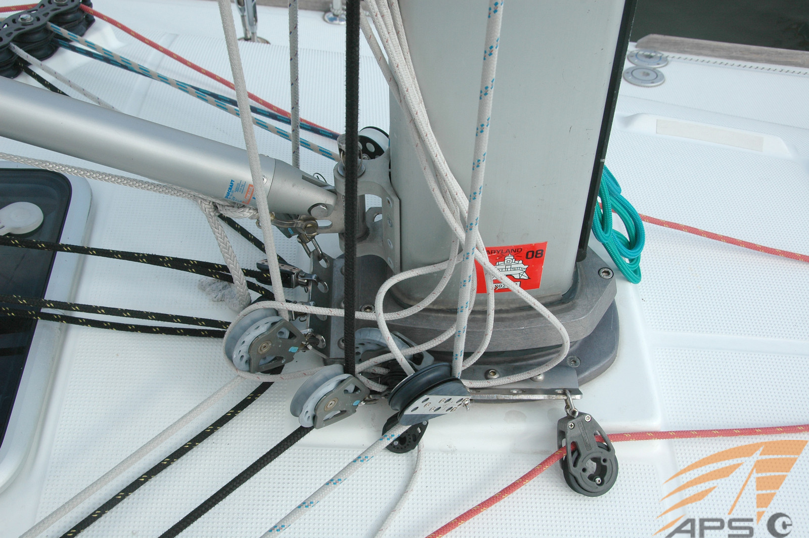

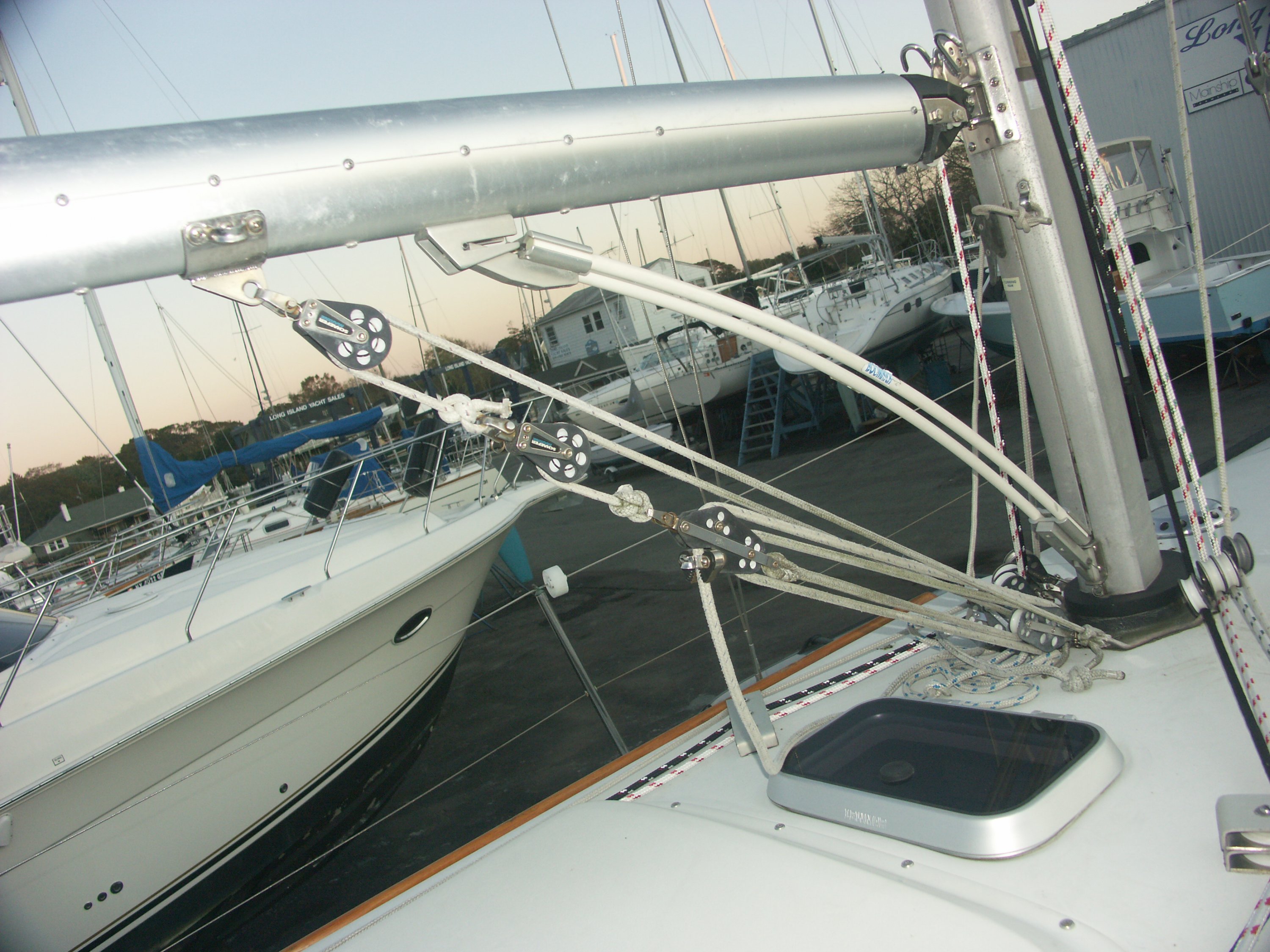

I'm considering:
a) 8 to 1 purchase with cascaded fiddle blocks and 1 control line led aft to the cockpit.
b) 8 to 1 purchase as above with 2 control lines led aft to cockpit. The line on stbd side would come from the cascading block for low purchase - high throw and the line on port side would come from the fiddle blocks for high purchase - low throw.
c) 5:1 purchase with triple/double block combination with a continuous control line led aft on both port and stbd - both with the same high purchase - low throw capability.
d) 10:1 purchase as in (c) with a cascading block. This would give me the ability to have the stbd control line with low purchase - high throw and the port control line with high purchase - low throw.
I'm pretty certain that 8:1 is the minimum purchase that I want. I'm not certain how useful the high throw / low throw option will be.
I have been reading about the low p - high t / high p - low t functions for both vangs and mainsheet controls. I could not find any reference to the size of boats where this capability is useful. I'm wondering how this function applies to a small keelboat such as mine. I consider that the ability to "blow" the vang with low purchase - high throw control line might be a safety feature. I could also be radically over-thinking this issue

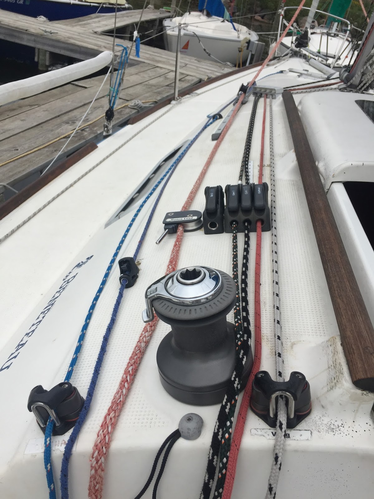

. But I will have the capability of leading a total of 12 lines aft, and that gives me the option to use 2 control lines for the vang if I want to.
