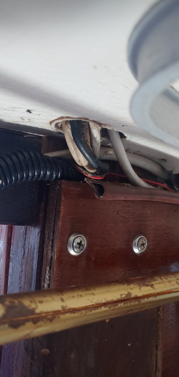

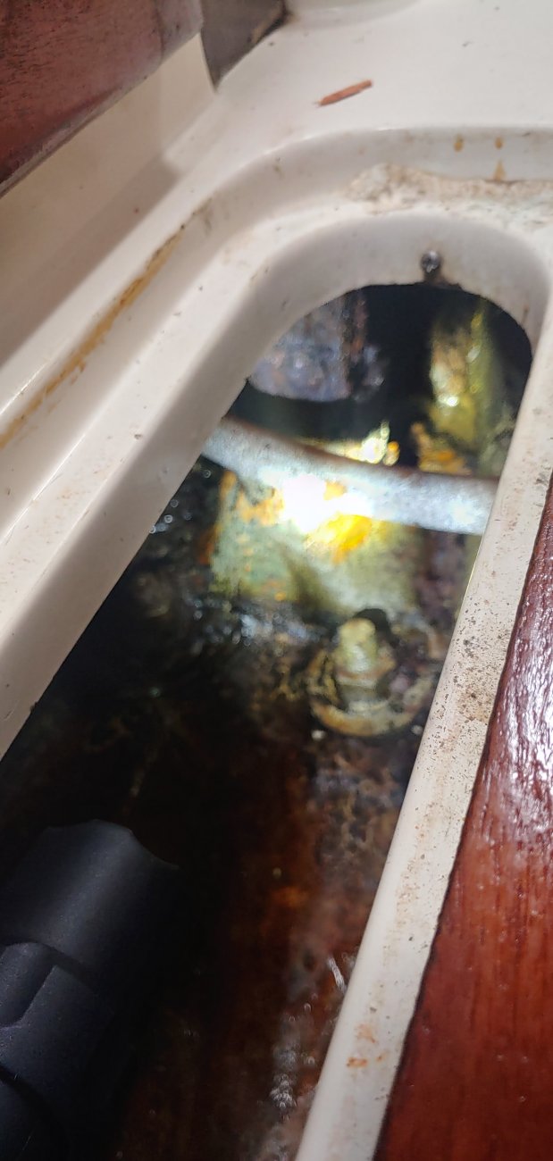

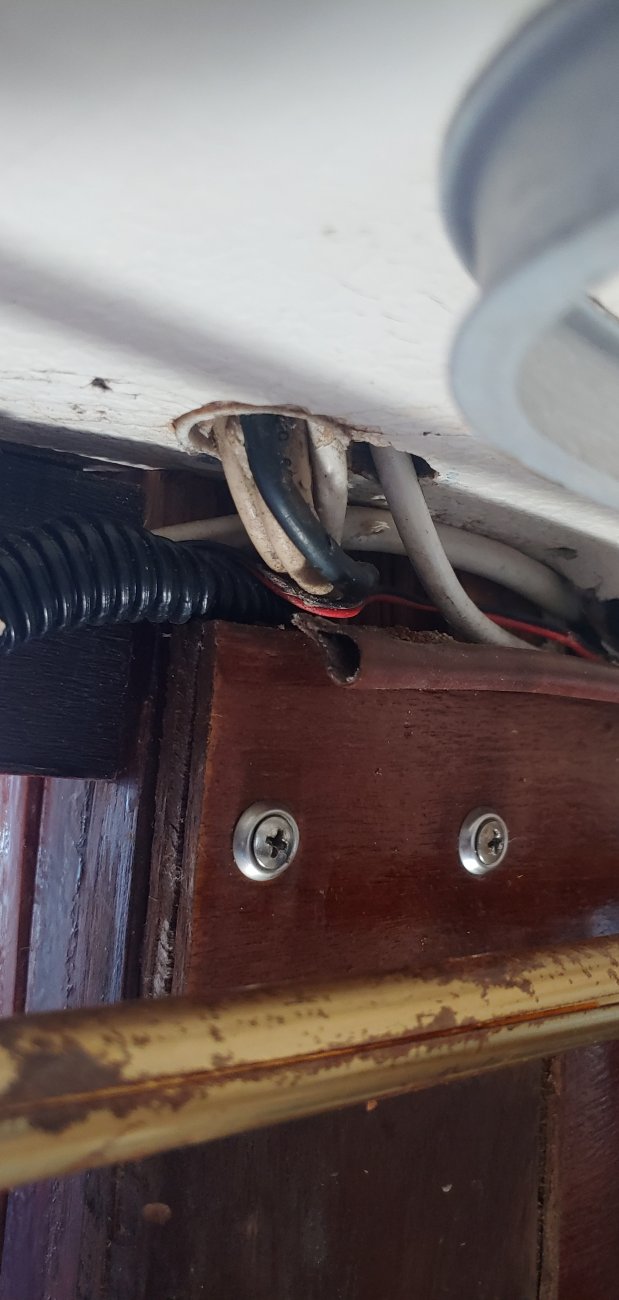

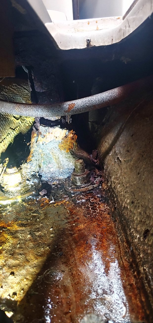

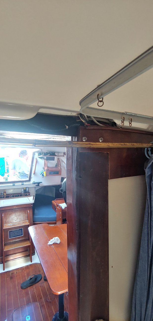

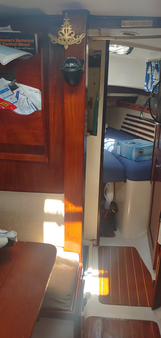

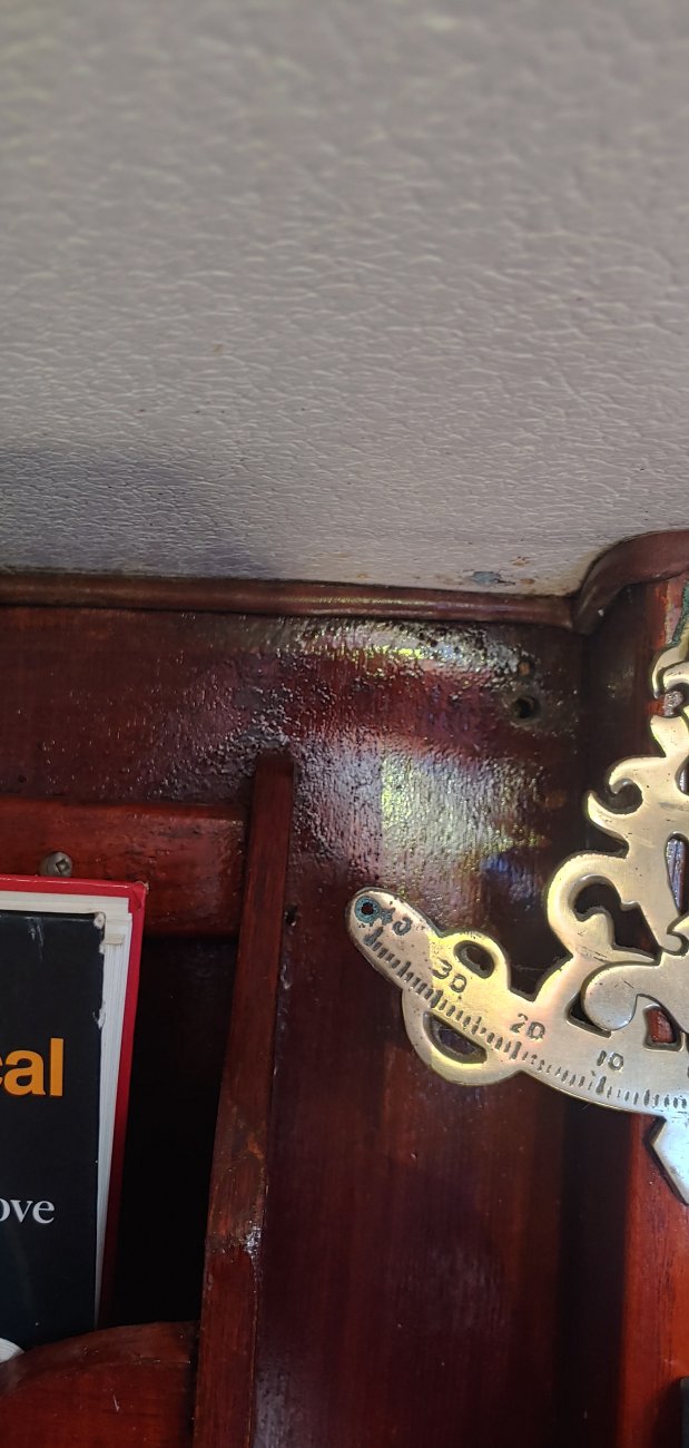

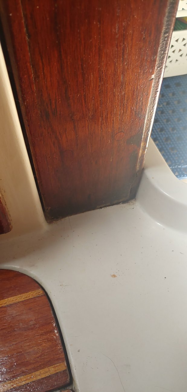

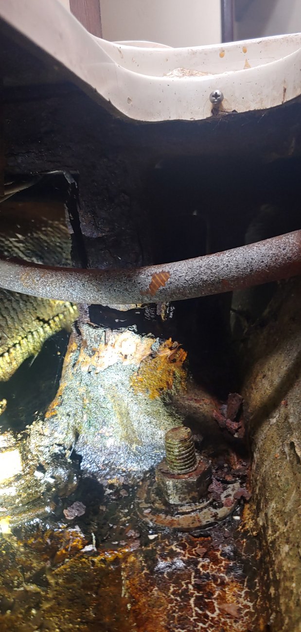

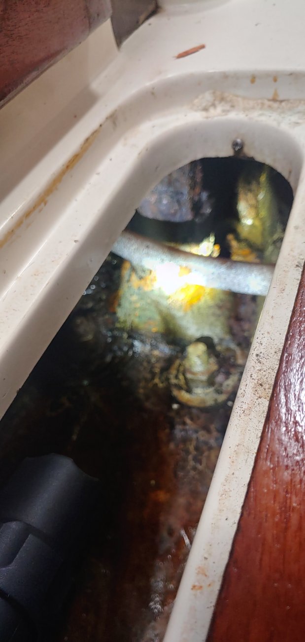

I have a 1979 Hunter 30 and I'm having issues with the compression post. The piece that is in the bilge was steel and is completely rusted in half, not sure if that is something a PO did because most people say they had an I Beam in there boat where as mine is a steel Square tubing glasses in. Also I noticed I have maybe 1/2" to 3/4" drop in the deck step around the mast. Water is pouring in through the wires that come out of the mast into the cabin roof . The post has a crack in it so I would like to replace it as well. The door to the V berth does shut perfectly but there isn't a door for the head.... Any pics or info on this particular problem would be much appreciated.

The compression post (located behind the teak facia in your pics) sits on a mast step in the bilge.
I see the metal rod, but can't make out the 'square tubing mast step', unless it's the gray item behind the round, bent rod.
There are a number of posts in the archives on this site relating to "Compression Post" and "Mast Step" repairs.
The water leak is a matter of removing the mast, routing the wires above the cabin top in a way that they have a 'drip loop', resealing the mast plate entry hole(s) and reinstalling the mast.
The head door was a slider on the '79's and I assume that was the case for your 1980 model. It was probably scrapped by a PO after it broke/wouldn't slide due to cabin liner/bracket deformation. A cabinet shop could make a new one if you can get the materials.
