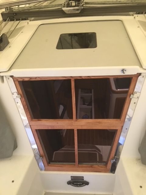

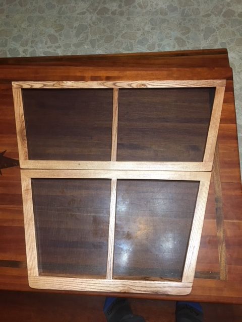

The screens in the Zarcor doors seem kinda small for those hot summer nights on anchor. Our Cat 27 had a two piece wood frame with a screen, while it was very poorly made by the previous owner, it provided great ventilation. I made mine from Ash and the screens are set in a saw kerf with screen spline, tight as a drum. Test fit this weekend.
Oct 19, 2017
8,154
That is very nicely done.:thumbup:
Is that your inlay work on the table underneath too? Walnut in cherry?
I'm working on another set of hatch boards
But, I feel inspired to do a set of screens now. I hope you don't mind if I use those as my guides.
- Will (Dragonfly)
CTS
Dec 5, 2017
31
Catalina 27 pa
Yes I built the table many years ago, seen a lot of use. Walnut and cherry. There is a hunters star of walnut burl inlaid just to left, out of frame.
You are an artist, very nice, I am just a creator of things. I am thinking I may make new companionway boards and router our boats name on one of the boards, just to add a bit of uniqueness. Probably us some locust wood, since that is completely impervious to rot, mother natures treated lumber.
I sized the screens with my existing boards, that is why they are not symmetrical. That way if I only wanted to use the top or bottom screen I could do so by replacing one screen with the boards. Another cool tidbit, is the ash came from trees I cut down and sawed on my sawmill.
