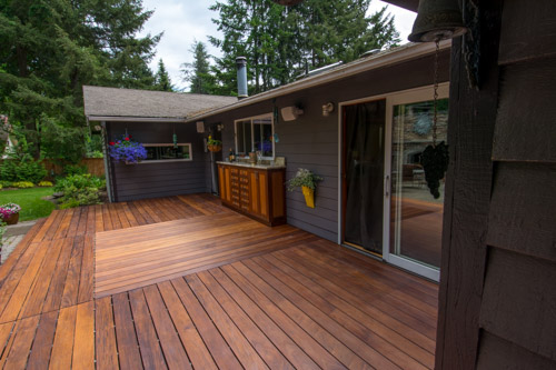

There is also a lot of ipe around - It's commonly used for decking and boardwalks - fairly reasonable if you get 11/16 (IIRC). Similar in color - but more tight grained. Very heavy - it is also called iron wood for a reason. I have several hundred board feet behind the shop and some inside. Thick ipe does get pricy, I just paid $11/lft for 2x6x16.
here is a ipe and teak buffet I built
the panels are teak - frames ipe
deck is also ipe.

24,938
The colors, the deck and the woodworking that went into Les's back yard is stunning.
