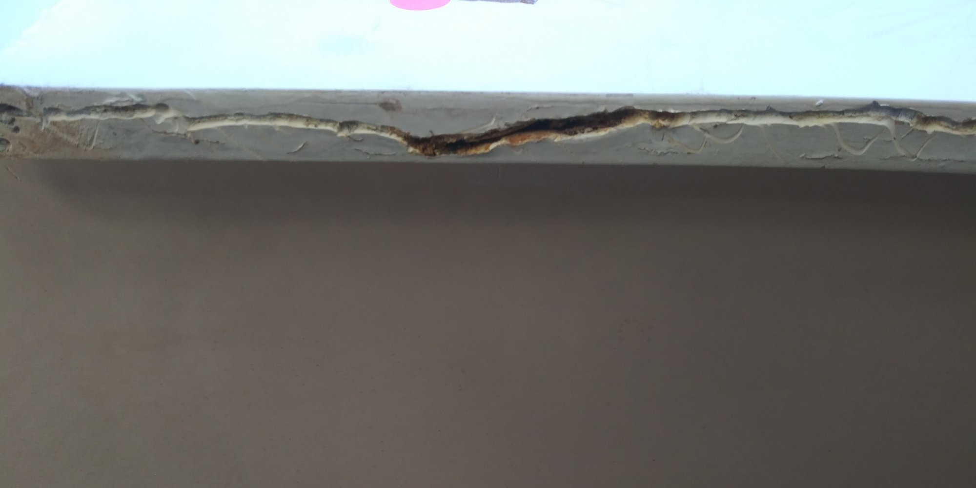

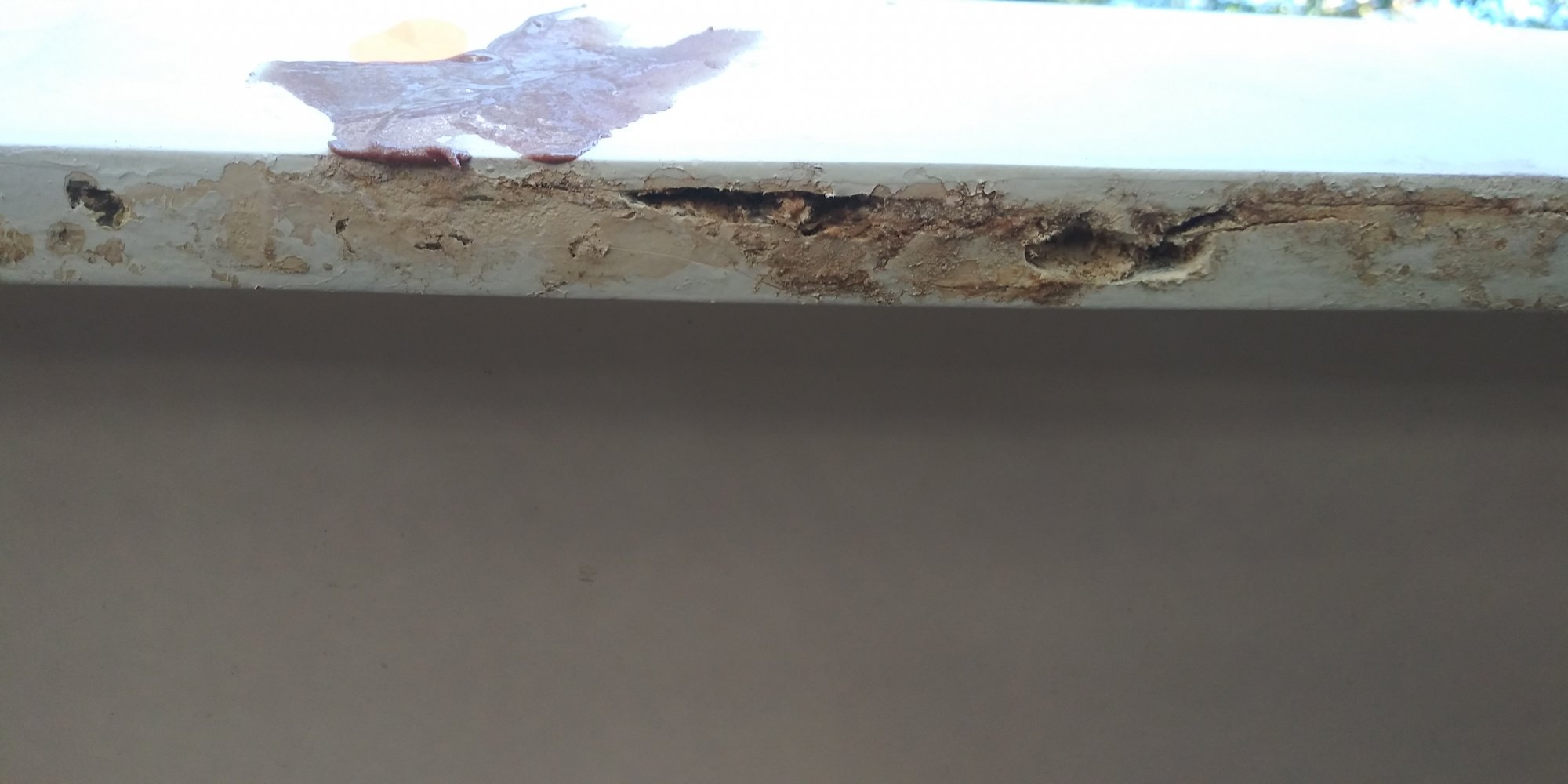

here are 2 photos of the edge of tbe companion way hatch. the inside edge, border is as you can see hollow to some extent in the areas that I dug up with the dremmel, ect. The question is, how to work overhead with west system 407(feel free to make recommendations, ect) so this product wont sag down due to gravity, ect.

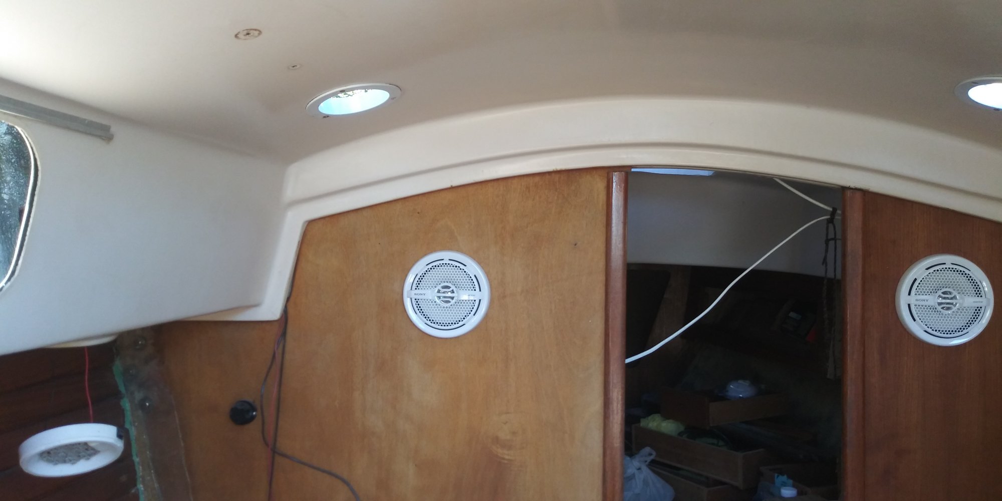

Now, the other photo shows the cabin interior. Is as 1976 when it was build, smooth. how to prep such for a coat of paint? 220 sand paper?

I would suggest wax paper on wood held up by something like duct tape, possibly using a syringe to inject it if the filler won't stay long enough to do the job then put up the wax paper, etc. The epoxy should dry fast enough you could hold it up there, if tape doesn't work.

Download the West System manual or any other epoxy manufacturer's manual (all epoxies are similar in working techniques). You can't even begin to work with epoxy without a manual in hand.
For your application you will need a thickener (glass beads) and a thixotropic agent (prevents sagging). The epoxy will then hang in there like putty.
14,186
Before sealing up the companionway, do a little digging to be certain the wood inside is dry.
Start by putting some unthickened epoxy into he crack, do not try to fill it, just coat as much of the interior surface as possible. A thin coat is all that is necessary. Drips, if any will be minimal.
Thicken the epoxy with enough filler to make it about peanut butter consistency. Then force it into the crack with a stiff putty knife. It will stay. Check the West System website for their manual which will give all kinds of good advice. It is a free download.
(EDIT) It goes without saying that to cover the surface below the crack to catch the epoxy that fall off the putty knife or off the brush. You might get a little sag with the thickened epoxy, however some sand paper will cure that.
As for the paint, in all matters of painting and varnishing, pick a company and follow their recommendations for prep, priming, and application. Go with a good marine paint, not house hold paint. It might be cheaper in the short run, however eventually you will rue the day the paint was applied.
Jamestown Distributors TotalBoat line of products seem to be a good economical option. I haven't used their paints, but I have used their varnish and I like it.
24,779
While Dave is correct... Most of it will stay, if it is thick enough. Then as the thermodynamic cure process occurs you may find some of it will drip... Cover anything beneath the work area, that you do not want epoxy drippings to spoil, with plastic, or some form of disposable covering.

I might try the West System Six-10 as an alternative to the more liquid type to which you would add thickener. The wax paper covering is a good idea too after the hollow area has been dried (hair dryer perhaps?), filled (perhaps in several layers with the appropriate dry time between applications) and sanding of the resulting material. Like other members said, "Read and follow the manufacturer's instructions". The Six-10 is a bit forgiving as to movement.

I haven't worked with six10 but I did use some West 655 G/Flex thickened epoxy for filling a fairly large gap recently and it was quite easy to work with. It uses a 1:1 mix ratio and has a peanut buttery consistency out of the tube. It does sag a bit in vertical applications so you may need to damn it up. I like @rgranger suggestion of acetate sheet. That would likely be easier to get a good shape with, and hold in place, than wax paper.

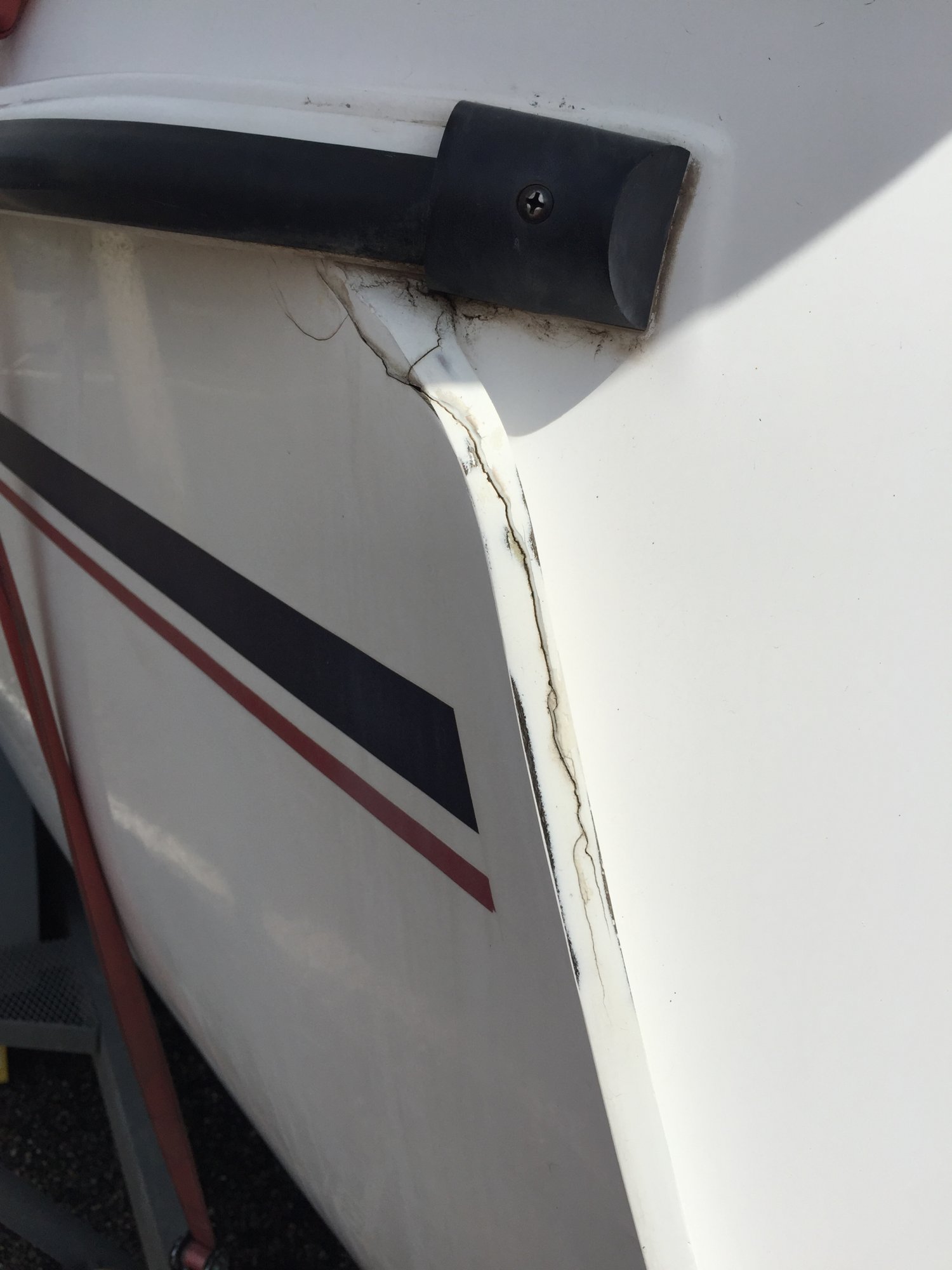

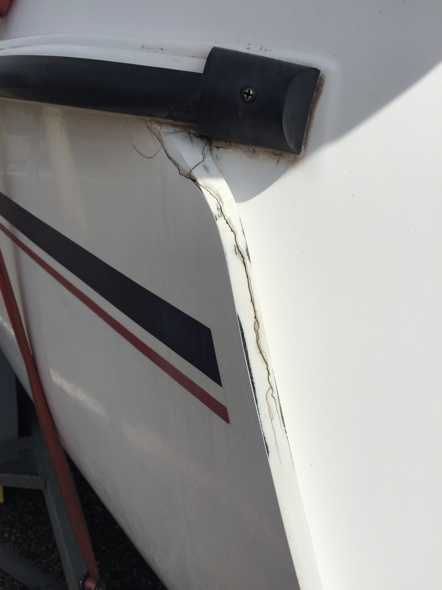

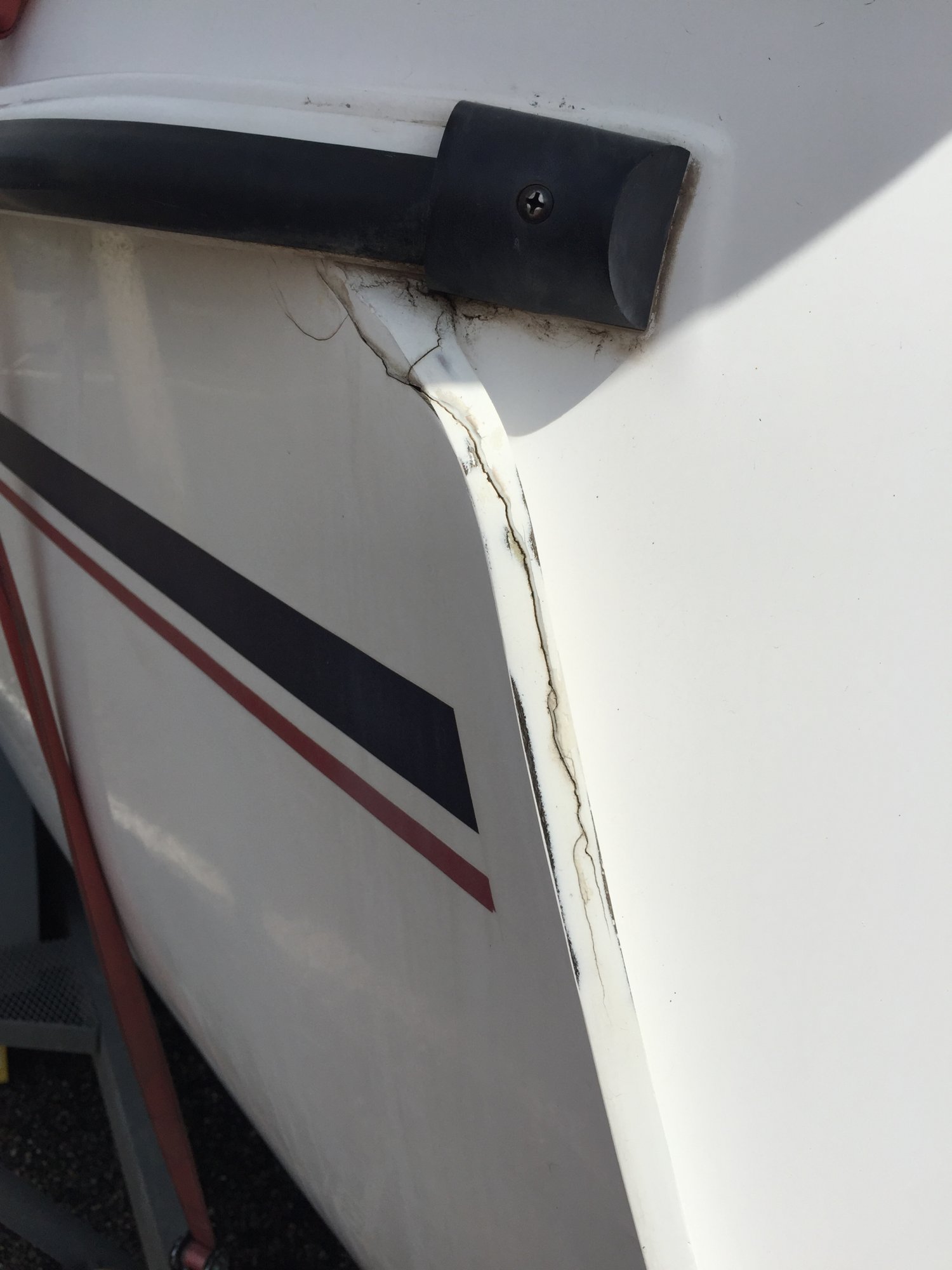

I’m glad I ran into this thread. I’ve been wondering what to do with this on my Hunter 26. Sounds generally like what you all are talking about here?
Clean it out then start filling it up with epoxy then finish off with fairing compound as needed? Seems like something I could tackle.
It’s been this way since purchase a few years ago, so not getting worse, at least.
For your application I would recommend using G/Flex 650 (regular) or 655 (thickened) epoxy. That is a joint that will experience some strain so the G/Flex will be more durable. Normal epoxies can be quite brittle and not forgiving of any flex.
Epoxy will need to be painted over since it doesn't stand up to UV. You may be able to get a color match gel coat.
This is a little different situation, because connecting the hull to the transom is pretty important.
Broadly, there are 2 possibilities. It can simply be cracked gelcoat with the fiberglass intact beneath the gelcoat. If so, the repair is easy. Remove the gelcoat and apply new gel coat. Because of the location color matching will not be a big issue.
In the worst case scenario, the underlying fiberglass laminate could be damaged. That could be a bigger and different repair.
First step, remove the gelcoat to see what the problem is.

First off, Dave has some excellent knowledge regarding fiberglass. He's guided me through a number of fiberglass repairs which have turned out very nicely thanks to his advice.
I personally would approach this slightly differently. I would first grind down a bit more to inspect as others have suggested. Grind down until you have reached solid material. When grinding I try to leave enough of the original so that I can regain the shape when the repair is done. In this case I would use a dremel or multitool. Practice on the edge of a piece of wood first.
Once you've gotten to good material, seal it off with unthickened epoxy. I would use a chip brush to apply it. Definitely mask off the area around it with masking tape and put something underneath.
I'd use 404 filler to fill this crack mostly because it's what I'm most familiar with. I've also used something called P14. It's a thick paste thats very easy to work with. Similar to thick plaster consistency but smooth. It's available from Express Composites.
I would use masking tape since you're going to sand through any drips that come out of the crack. If working with epoxy and a filler mix as much as you think will mix in there and then mix even more. The key to getting more to mix in is to expose more surface area for the filler to mix with. I would use a syringe to apply. In some cases you may have to build up the thickened epoxy in steps. Dont be afraid to put a bit more than needed on in order to get a good application since you'll have to sand it down afterwards. I would carefully use an orbital sander and a sanding block. 80-100 grit sand paper is suggested.
Another idea would be to make a gutter or channel out of tape just below the crack and filling it up to the point that its just above the crack. There's many different ways to approach this.

As for the interior, if the surface is smooth it should be sanded to the grit the paint manufacturer suggests and wiped down with the manufactures suggested solvent. If it is not smooth sanding is still required in most cases followed by scrubbing out any grime from textured areas with the suggested prep solvent and possibly some sort of brush followed by wiping the entire surface with the suggested solvent. Proper PPE is a must as most of the solvents you will be using are very dangerous without proper protection. This preparation will give the surface a tooth as they call it for the new paint to grab onto. Many times if this step is skipped or done poorly the new paint will not adhere properly which can and does end up causing the paint to fail in various ways. Again proper repair the first time will prevent you from having to repeat the repair a second time down the road.
