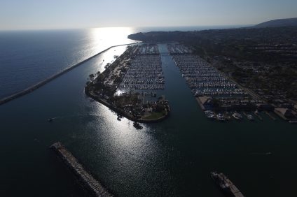

In regards to Rule 9, does not apply. As I stated originally, neither boat was encumbered. See pic of harbor. Big channel. Also those boats are reasonably nimble.

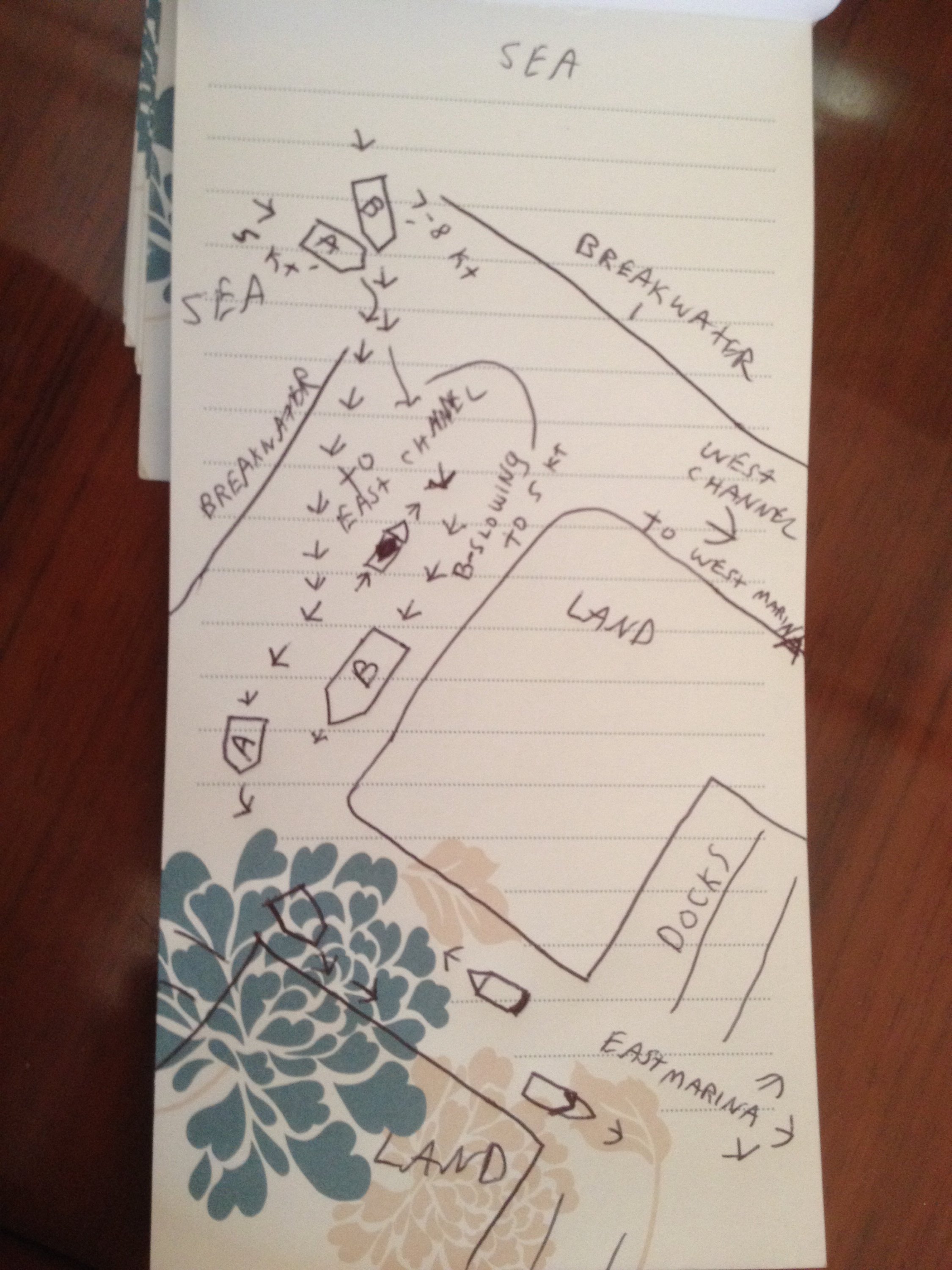

So I'm coming into the harbor at 5 knots - I maintained speed throughout the course (see hand-drawn map. No snickering at my artwork), and boat B passes and then royally cuts my port bow. Had to take evasive. Not butt clinching, but produced a frown. Had I been headed for the west channel, would have been emergency collision avoidance. Contact slightly possible.
So then we're abreast, with him gaining ahead. He then slows and takes a wide berth to port, presumably to avoid another boat which was exiting. So far to port in fact that he would have encountered exiting traffic had there been any.
I then had a better angle, and my boat overtook his. Then we're pacing with me ahead and to his starboard.
I check my port quarter. He had slowed and was pacing me aft, I presumed to give me space, so there was sufficient room. I turn to port, as should be expected in the main channel - see map and pic. In any case, I was stand on. I should anticipate the other to give way should he need to (he didn't need to). I would have given way, had there been a collision danger.

Summary:
At the mouth of the harbor, boat B should have fallen in behind me, or confirmed visually that I was turning to starboard prior to him doing so, and with more room initially allotted to my port.
At the 2nd turn, as we are at the same speed, boat B should have simply fallen in behind me prior to the turn (this would also have put him back on the right side of the channel), or used his anticipation and visual of my turn and steered to starboard to cross my stern. -If needed. Wasn't needed.-
Instead of continuing ahead and getting mouthy on the PA. Very unprofessional.
