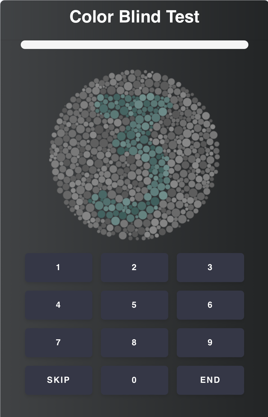

I am beginning to think there is a gene for color matching
That is a possibility. There is a genetic mutation that causes color blindness. With it you have problems with color matching.
Even a test.
what do you see?
Jun 5, 2024
6
Tartan 3500 Amelia Island, FL
Ha! I see the 3, but I am generally at a loss to know if I need a little more brown or a little more yellow to get where I want to be.
