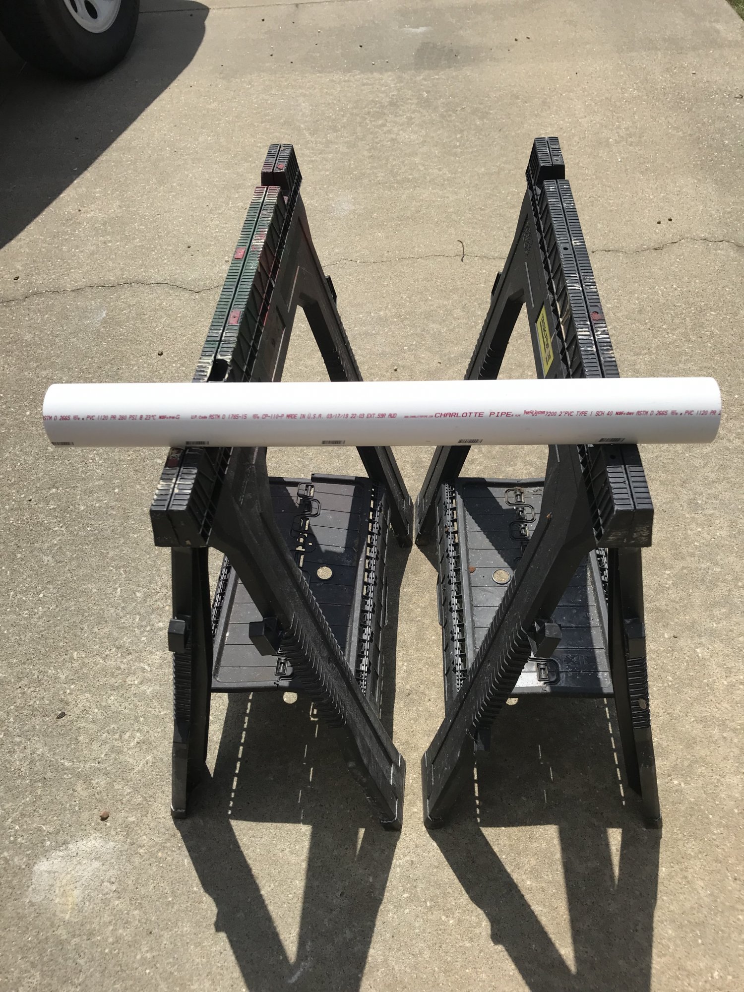

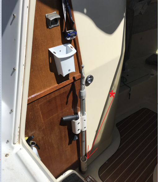

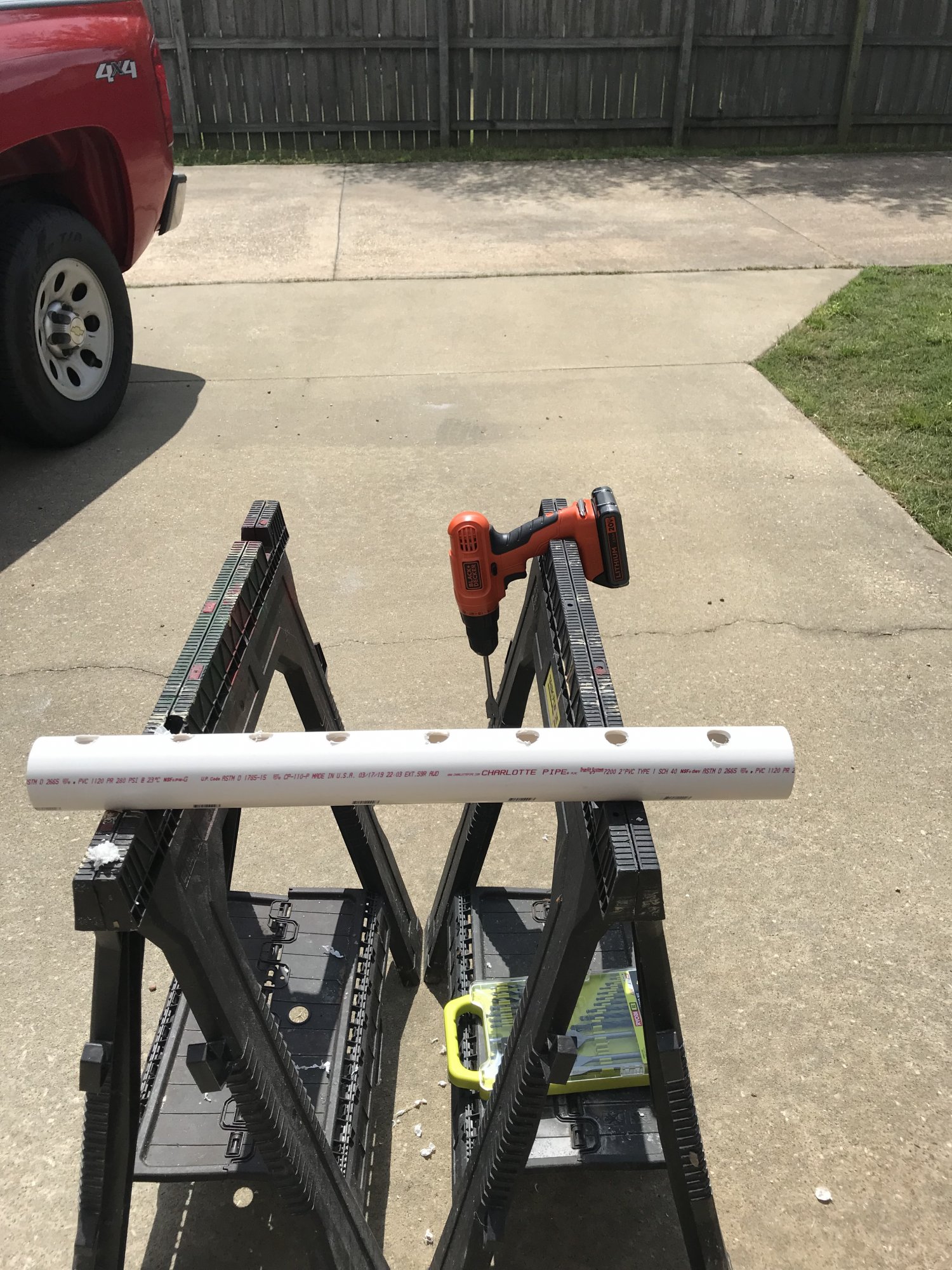

and here is my initial contribution to this thread...
The holes are there to allow you to get a screw through to the back of the pipe.
