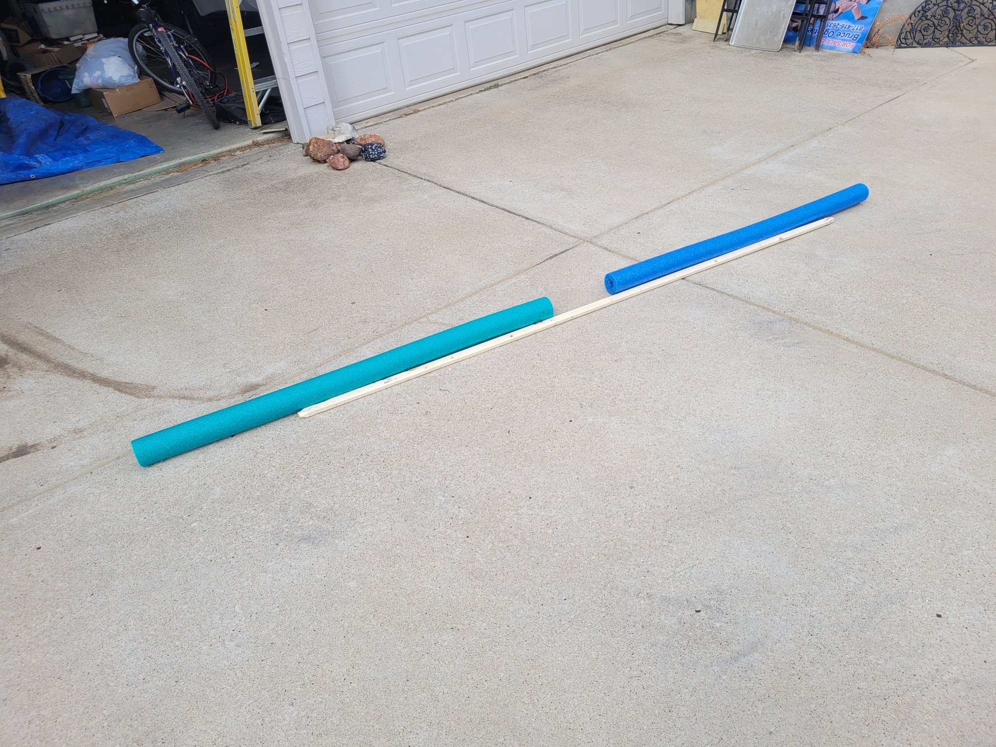

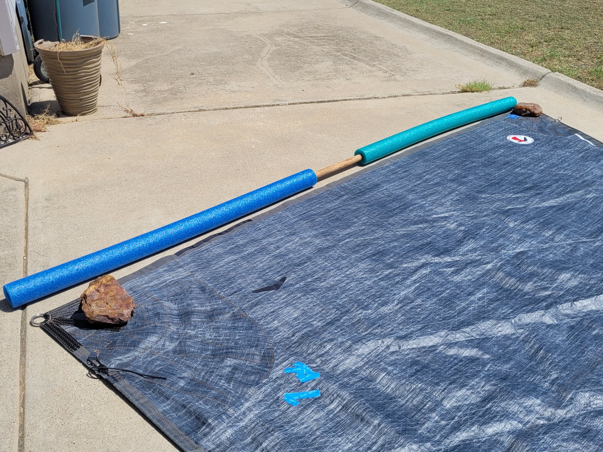

Faced with the realization that I should roll certain sails when not in use, I have put together a cheap device to make that easier. It also serves to support the sail during transport.
I used two large pool noodles and a cheap piece of 8 foot 1x2 pine. It's hard to find a straight piece of this material, but the edges are rounded, making it easier to insert into the noodles. I had to clamp the 1x2 in a vice to get it fully in place.
The photos tell the rest of the story.

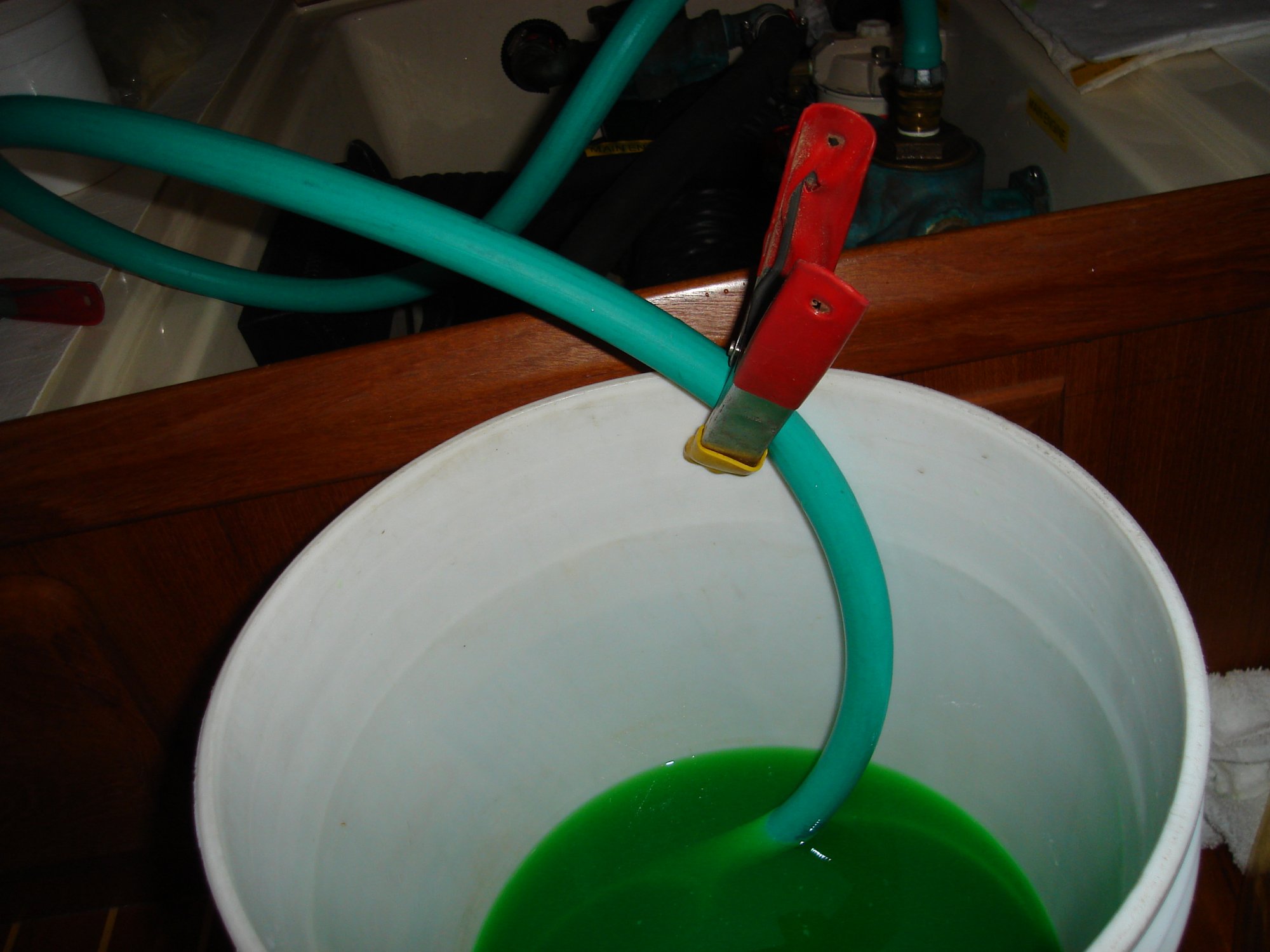

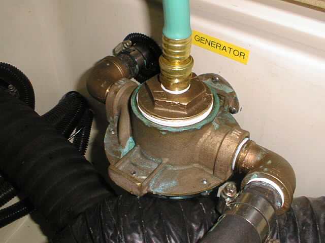

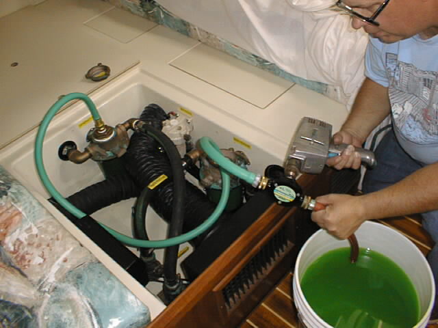

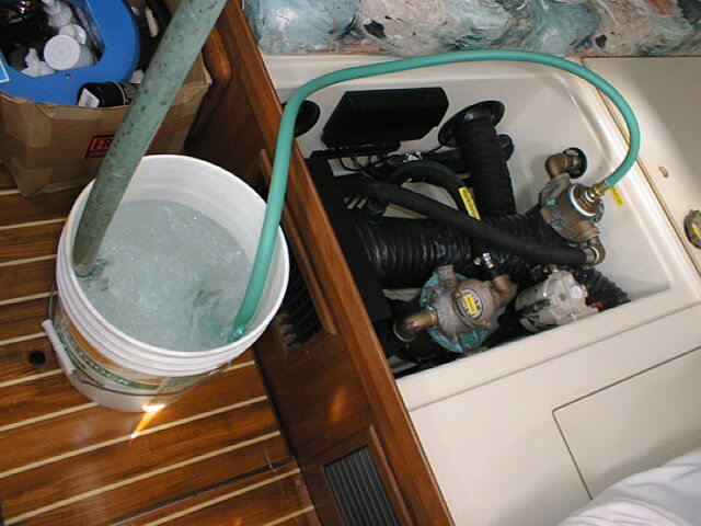

For those of you that have a Groco raw water strainer on your engine, generator, A/C systems, here is an easy way to flush with fresh water for winter layup. It is not necessary to disconnect any hoses and can be done in the water or on the hard. If you have a different type of strainer and can get a replaceable top to which you can connect a hose, you can do the same thing.
Buy a threaded bushings that will thread into the strainer and will connect to a garden hose. Make a short piece of hose with a connection to the strainer bushing and put it into a bucket of water that is fed from another hose. Run the engine or A/C system and let it pull the fresh water from the bucket and flush itself. Keep the bucket filled. When you are done flushing, empty the water out of the bucket and add antifreeze. Then start the engine or system and let it pull the antifreeze from the bucket.
I have done freeze point measurements on the antifreeze that is expelled so I know exactly how much antifreeze to draw through the systems to achieve the level of freeze protection that I need. Mark the inside of the bucket in 1/2 gallon increments so you know how much you are drawing.
I perform this procedure in the water before hauling. After hauling I open the sea-cocks and let the hoses drain. The strainer itself will be filled with antifreeze, so it is not necessary to drain the strainer.
If you store in the water, after adding antifreeze to the engine, use a drill pump to push antifreeze out the sea-cock to protect it. Shut the sea-cock before stopping the pump.

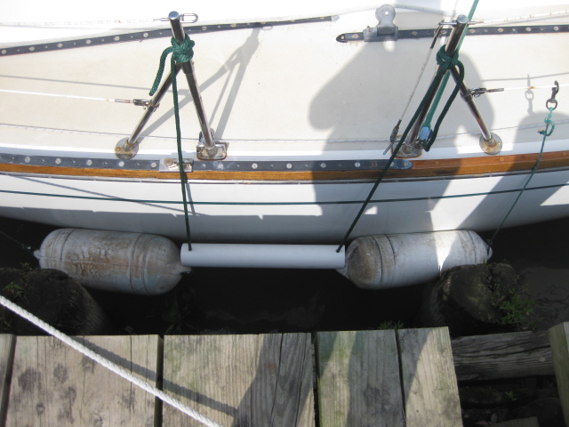

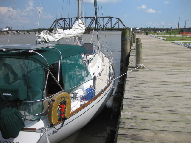

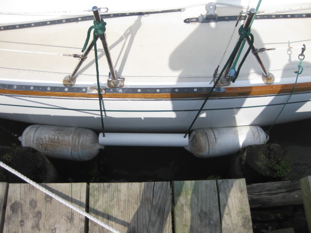

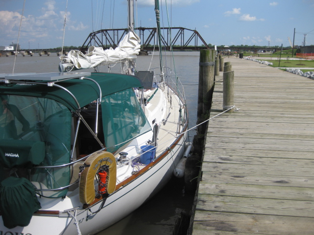

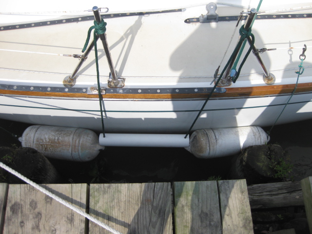

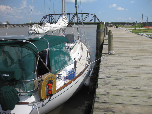

3" PVC fenderboard. Shown at Berwick, LA. The right side fender is above a two inch long 3/4" bolt holding the dock to the piling.
When not in use, I store the beach umbrella in it to protect the fabric and keep it from winding up in the bottom of the quarter deck locker.
You might want to look into using lightweight landscape drainage pipe (like in my previous post) for those applications. As a fender, it would compress and act more as a cushion than standard PVC sanitary pipe would. It is much more lightweight, and has a bit more inside diameter than PVC pipe of the same size. It takes the same size caps, so would be easy to close up. Some also comes perforated so that it will allow for ventilation and prevent mold and mildew.
Is the PVC tough enough to take having a powerboat wake bang the boat against the dock, or is it just there to hold the two bumpers in place? Our fenderboards are 2x8's that we hang outboard of the fenders so that they take the abuse from any pilings, steel bulkheads or stone piers instead of the fenders getting trashed.
WayneH
1,125
Tartan 37 287 Pensacola, FL
There are gouges in the PVC from all the tug traffic coming down the Atchafalaya River. I needed something sturdy to take a pounding. I wanted something lighter and multipurpose than a fender board. The picture was taken at the Southwest Reef Lighthouse in Berwick, LA. Google Maps on satellite view will give you an idea of how much traffic is in the area. Not as much as the Sabine or Mississippi Rivers but enough to keep you aware.
