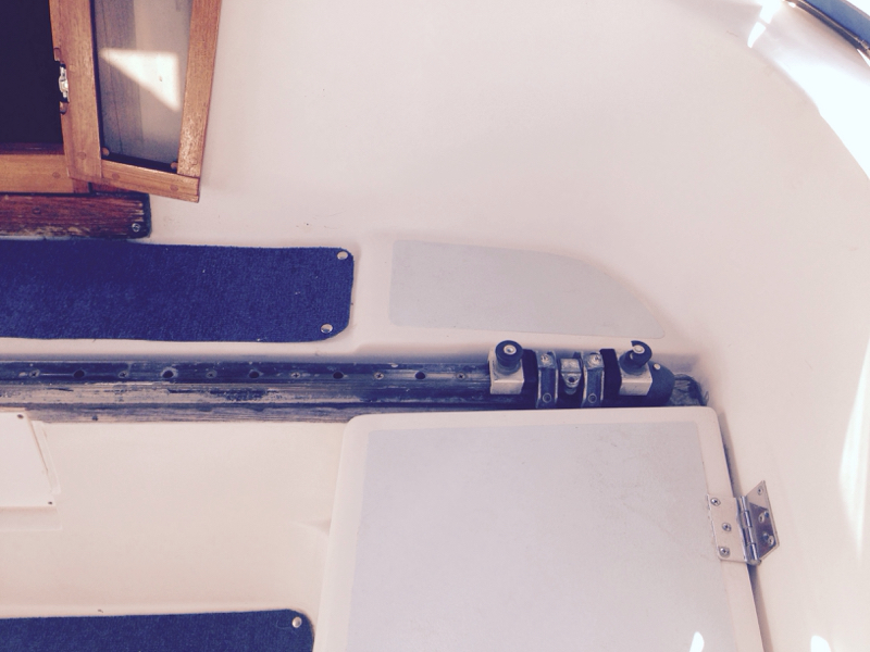

So, today was the day. Homeless, tied up atFisherman's Village Marina,Mary has wanted the traveler gone for months. New traveler on coach roof works well. Yesterday, I soaked the bolts with PB Blaster, hit them with a hammer. Today I reapplied PB and the hammer. Hit T them all with a hammer drill. Yahoo, they all spun after 35 years. Still had to drill out 3 heads, but the traveler is gone. Lots of mess with teak under the traveler but wood is no match for us now that we have defeated stainless and aluminum.
