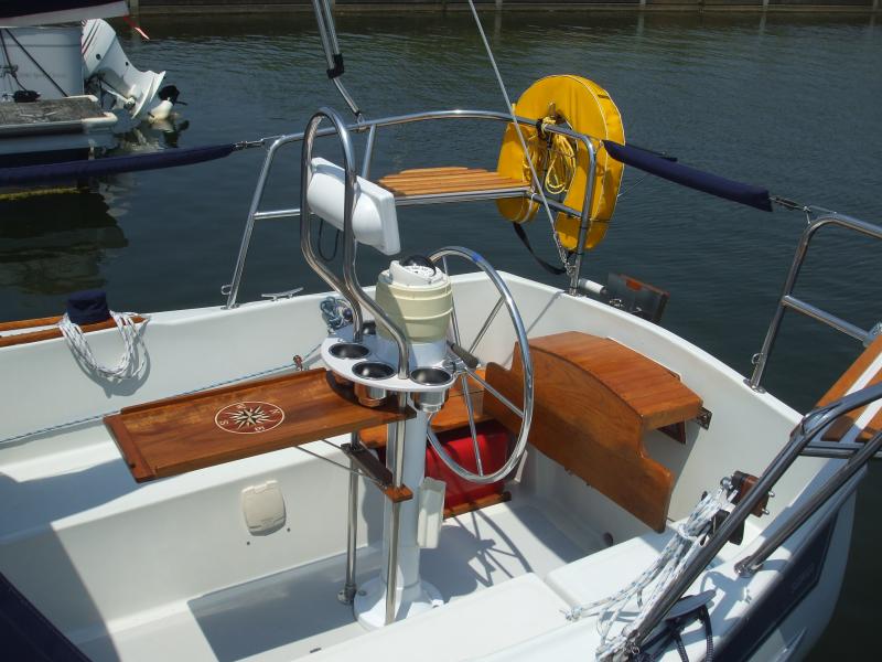

Attached is our 12X24 Cockpit Table on our Seaward 23. I made it from solid Teak and is supported by a 1/4 SS rod and other over the counter SS hardware. The table is firmly mounted to the pedestal tubes using Teak mounting pieces on 9.500" centers and folds down via a SS piano hinge. As you can see, the table as a 6" Mahogany/Teak "Compass Rose Inlay" installed in it. This was the most challenging aspect of the project, but was well worth the extra time/effort! We recently added the Edson's remote mount, which will let us remove the wheel, thereby creating more room in the cockpit while at the dock or anchor.
