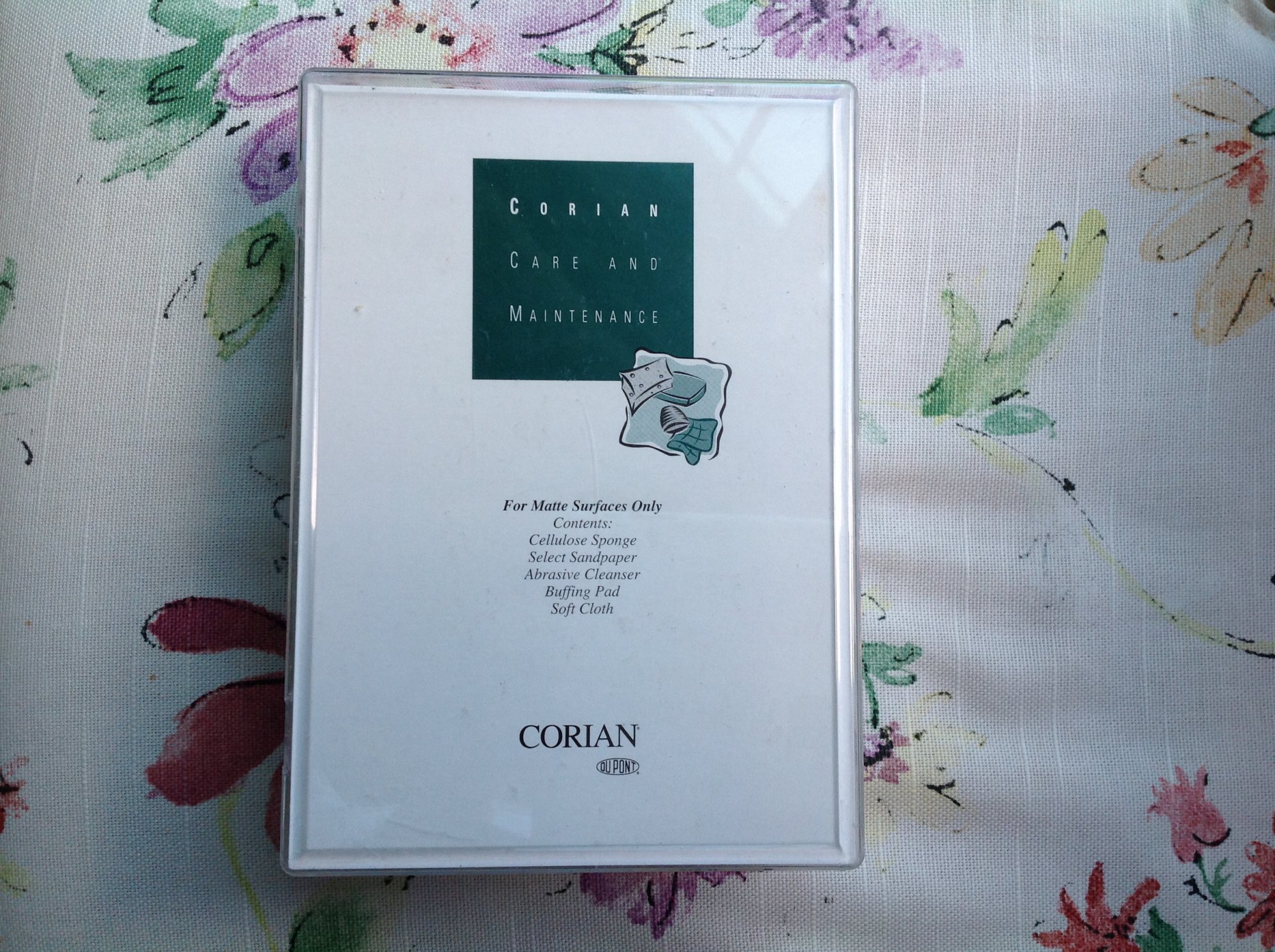

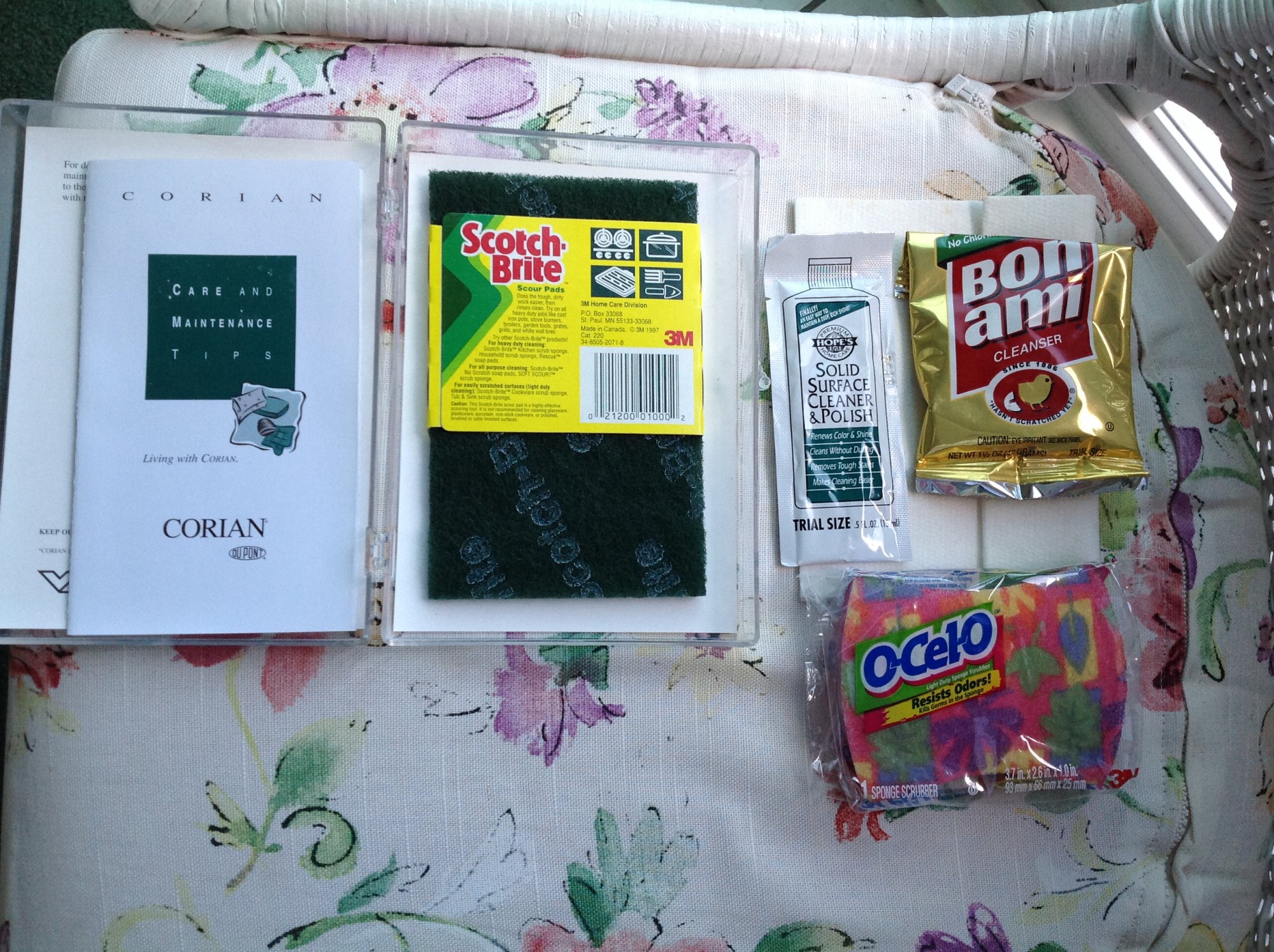

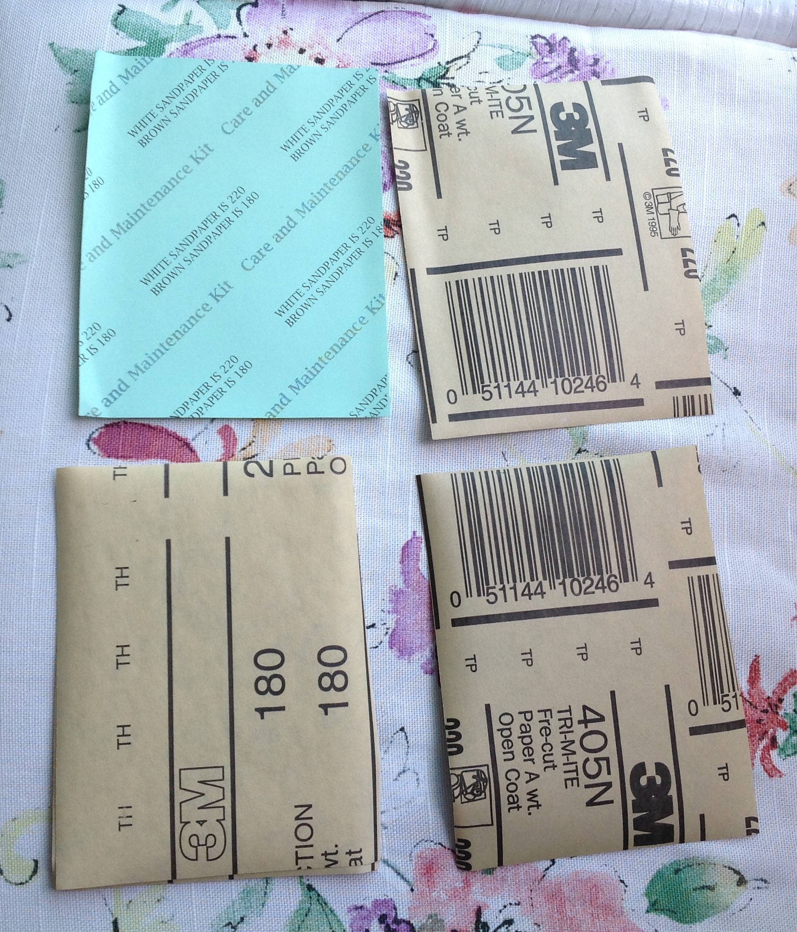

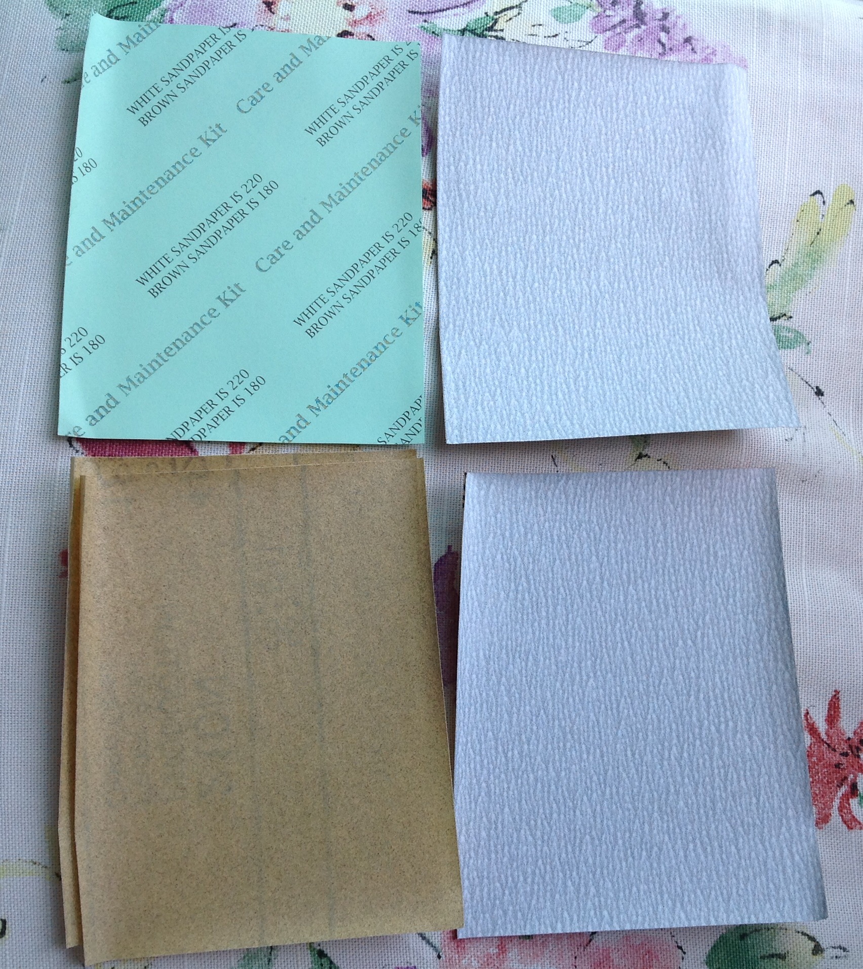

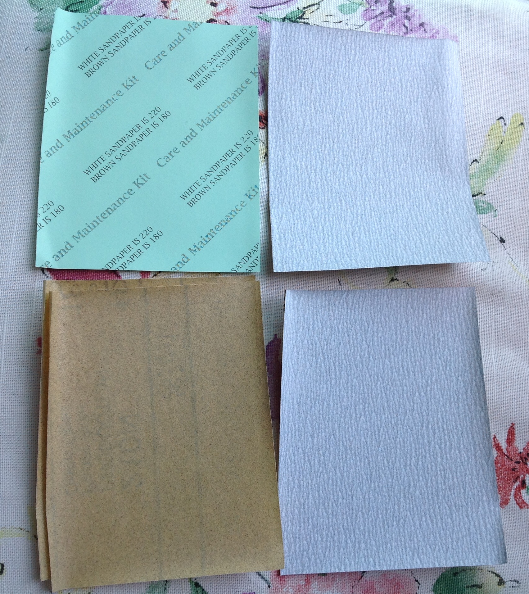

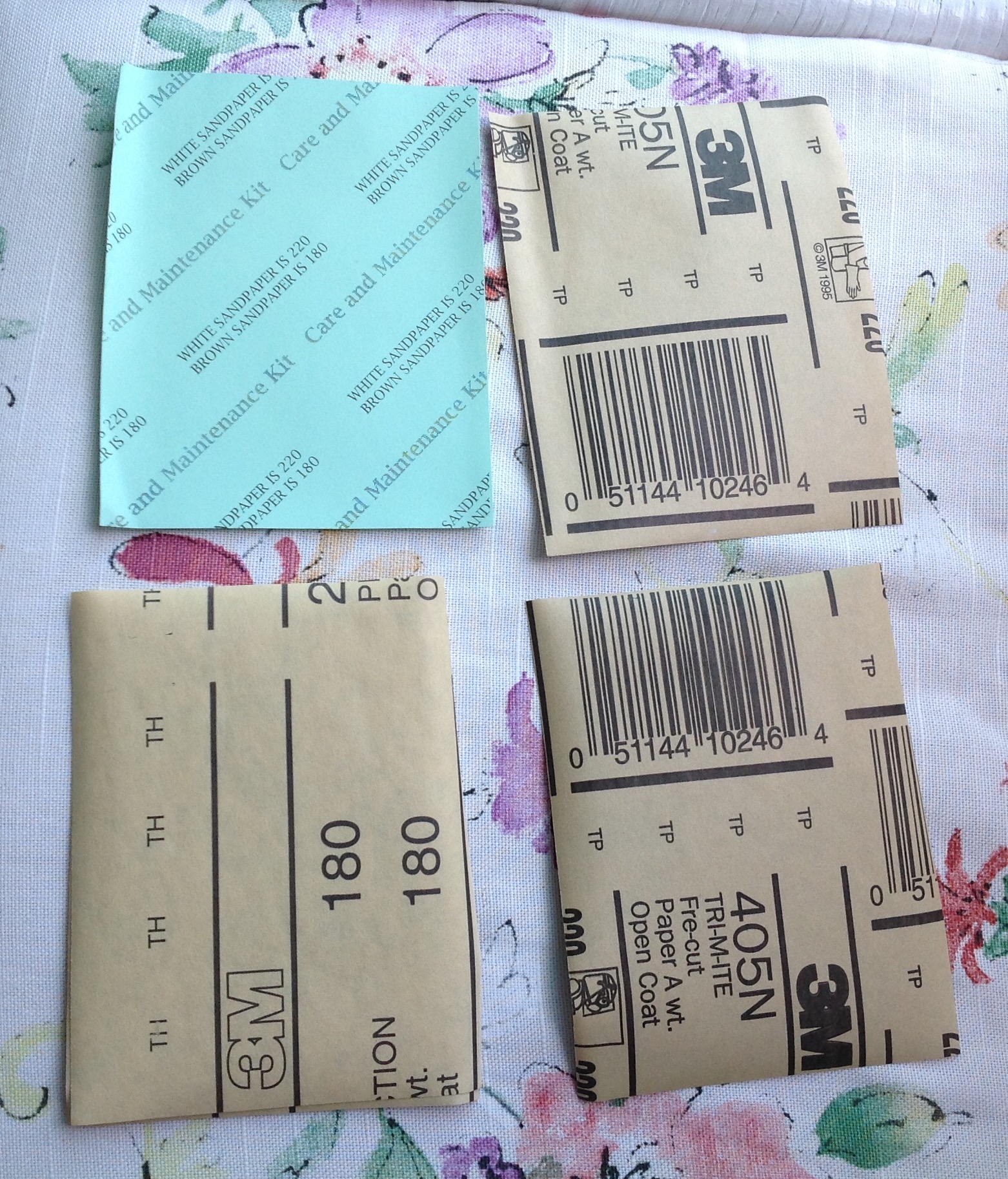

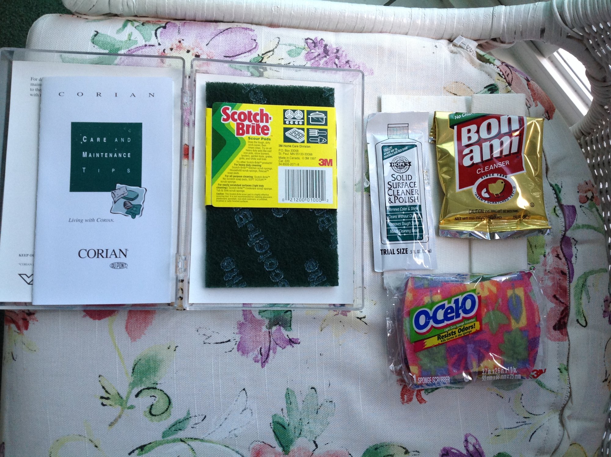

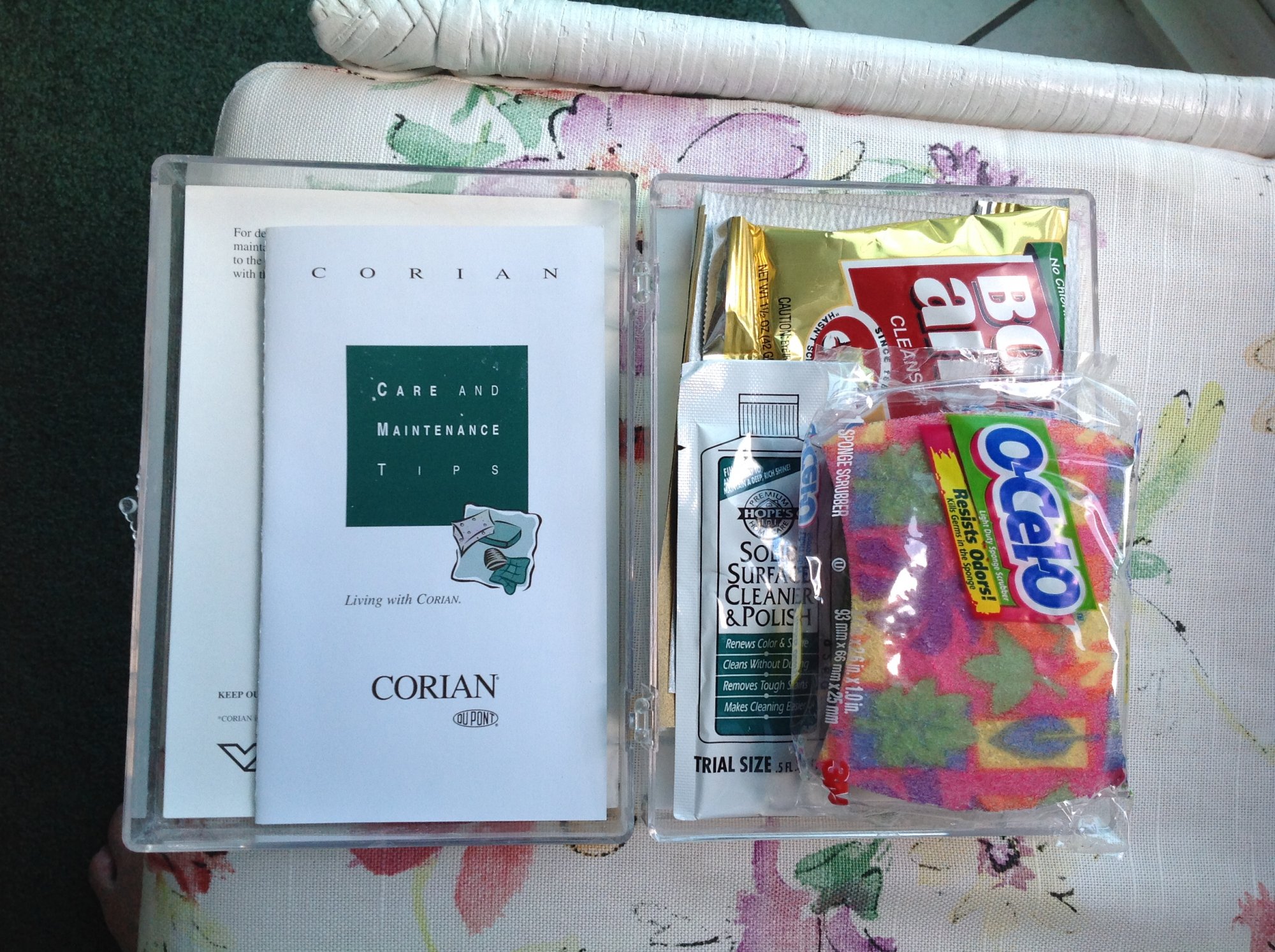

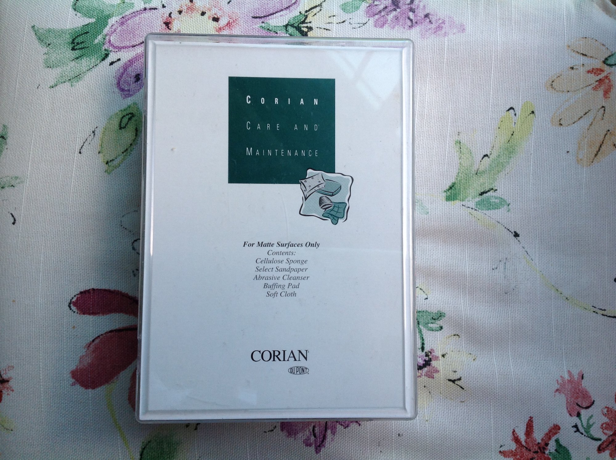

Yes, it was in the cabinet behind the toilet. It is also bigger than I remembered. And loaded with stuff. So I took photos of the instructions according to Corian and the stuff.
And lucky me…inside was a coupon for 25 cents off. It expired in 2001 and I’m left wondering how that got past us. All in all it’s not what I remembered but I did say we never used it in 22 years. But it will tell you how to care for your Corian tops.
This was fun to do and I hope it helps you out.

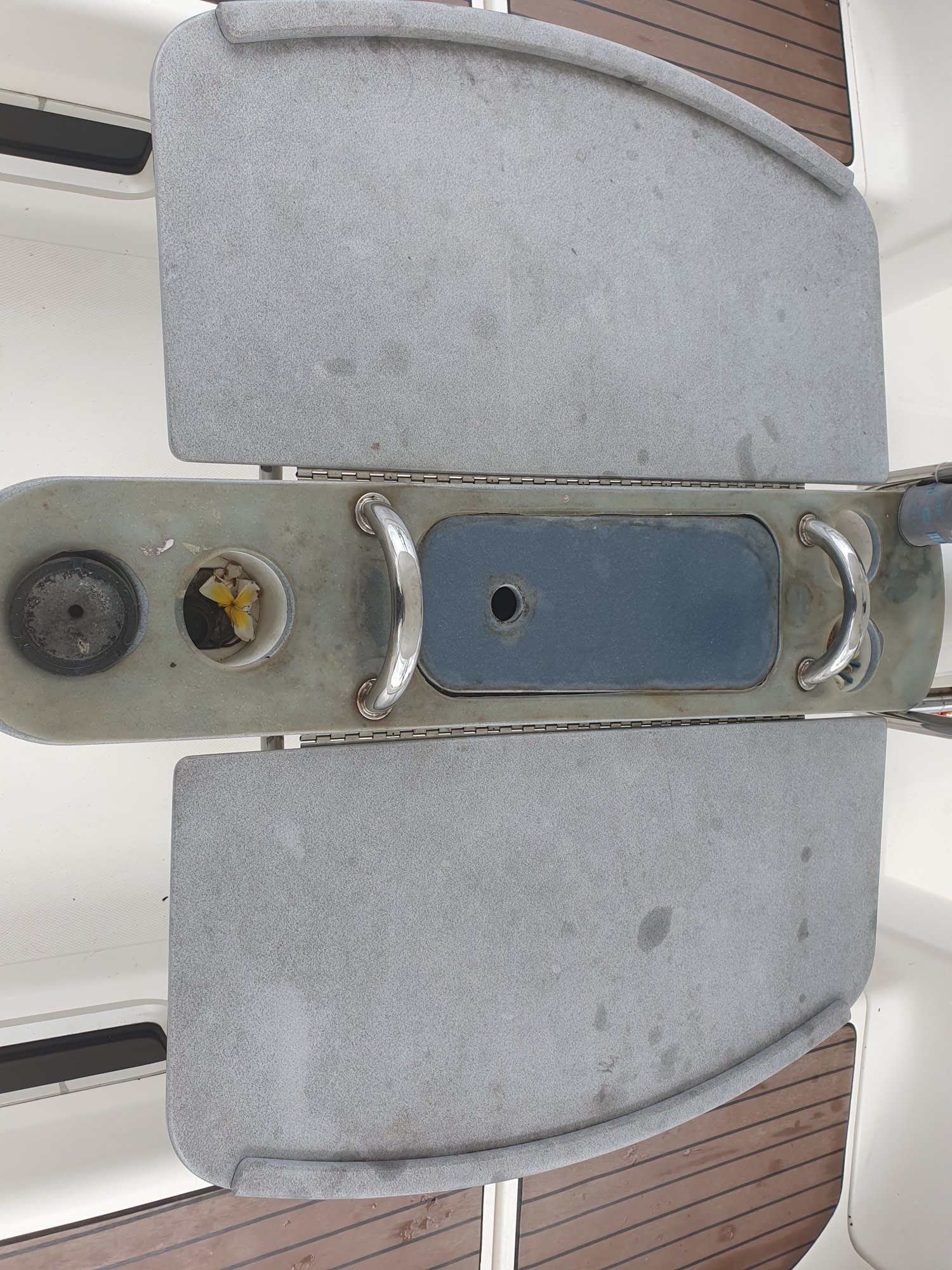

If anyone is still remembers any tricks I'm all ears.

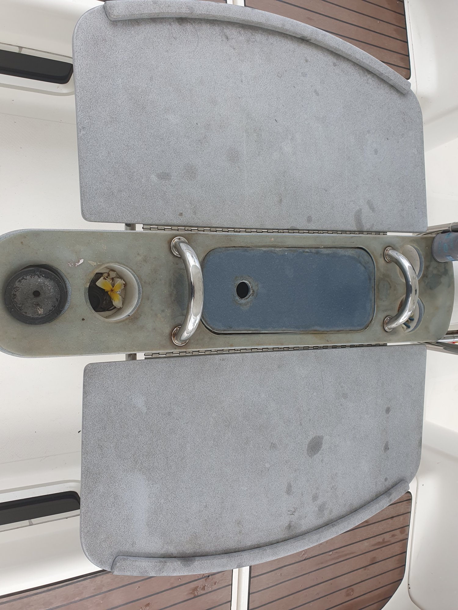

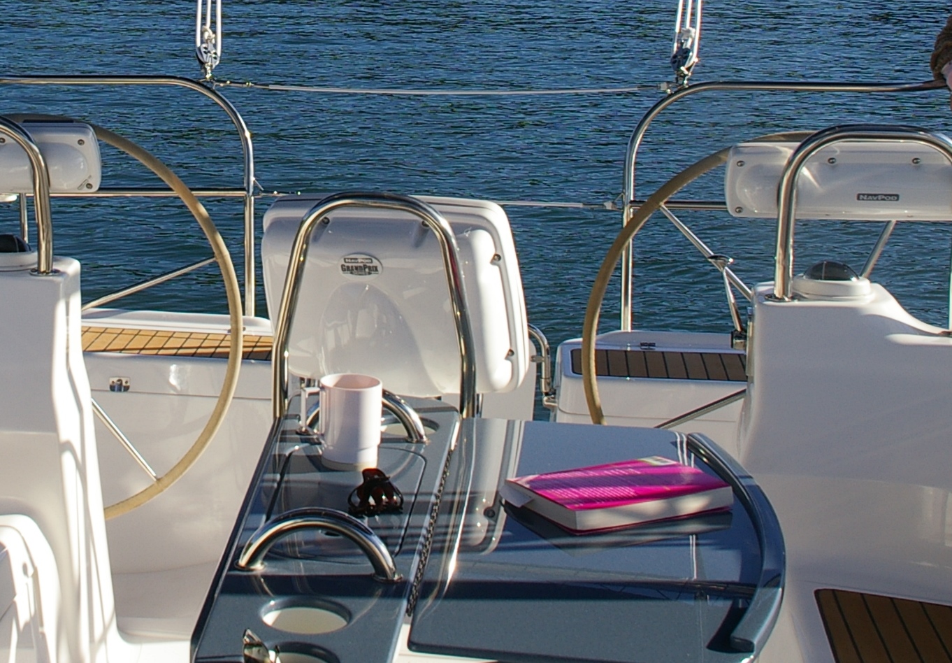

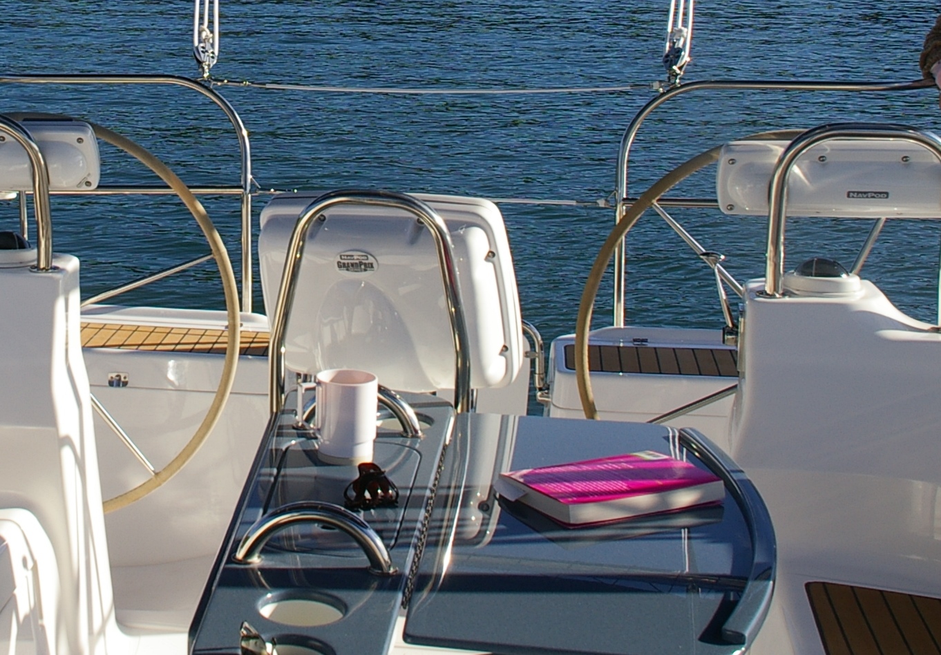

When Screensaver was delivered the outside Corian table looked perfect, as per the attached.
15 years on, it has no scratches but I assumed a good clean and sort of treatment would restore it to its former glory.
But now:
1) anything including water will leave a stain and will not wipe off. Its like it has become absorbent.
2) It has lost its lust and deep colouring turning to a more washed out grey colour
Im not sure I see how all the polishing (sanding options) I see on the internet are either going to stop it absorbing anything, nor how it will bring back its former lust.
It is as if has suffered damage from the sun, ie UV or something and has somehow sort of bleached it or depleted some imbedded protection.
The reason i suggest this is if you look at attachment Table 1 you ca see the grey color it has become, however where there has been clear plastic on top (ie in the center) that was there to protect against scratching, you still see the original colour.
Does the community think polishing with bring back the original lust and colour
How can such action stop it being absorbent.
Open to idea's

You can probably restore the Corian, but its gonna take some work. Here's a video that shows the process as part of an effort to repair a scratch, but you can see that the after sanding the surface of the Corian in the video is markedly changed from its original - similar to what's happened to your Corian over time (but weathering and use versus the sandpaper). I'm guessing that after a good sand with progressively less aggressive sandpaper, and then a polish, it would probably come back. You could try in one spot with an orbital polisher and see what happens.
Complete Corian® Countertop Repair in Under 8 Minutes - YouTube
Here's an article with some better detail on how to refinish:
How to Refinish Corian Countertops: A Step-by-Step Guideline - AdvicerHome
One thought though - maybe inquire at some places that sell Corian countertops as to who can refinish/repair them. They're very common in home construction. I bet they can recommend someone who would do it for you, and if its a non-marine vendor I bet the cost would be pretty reasonable.
