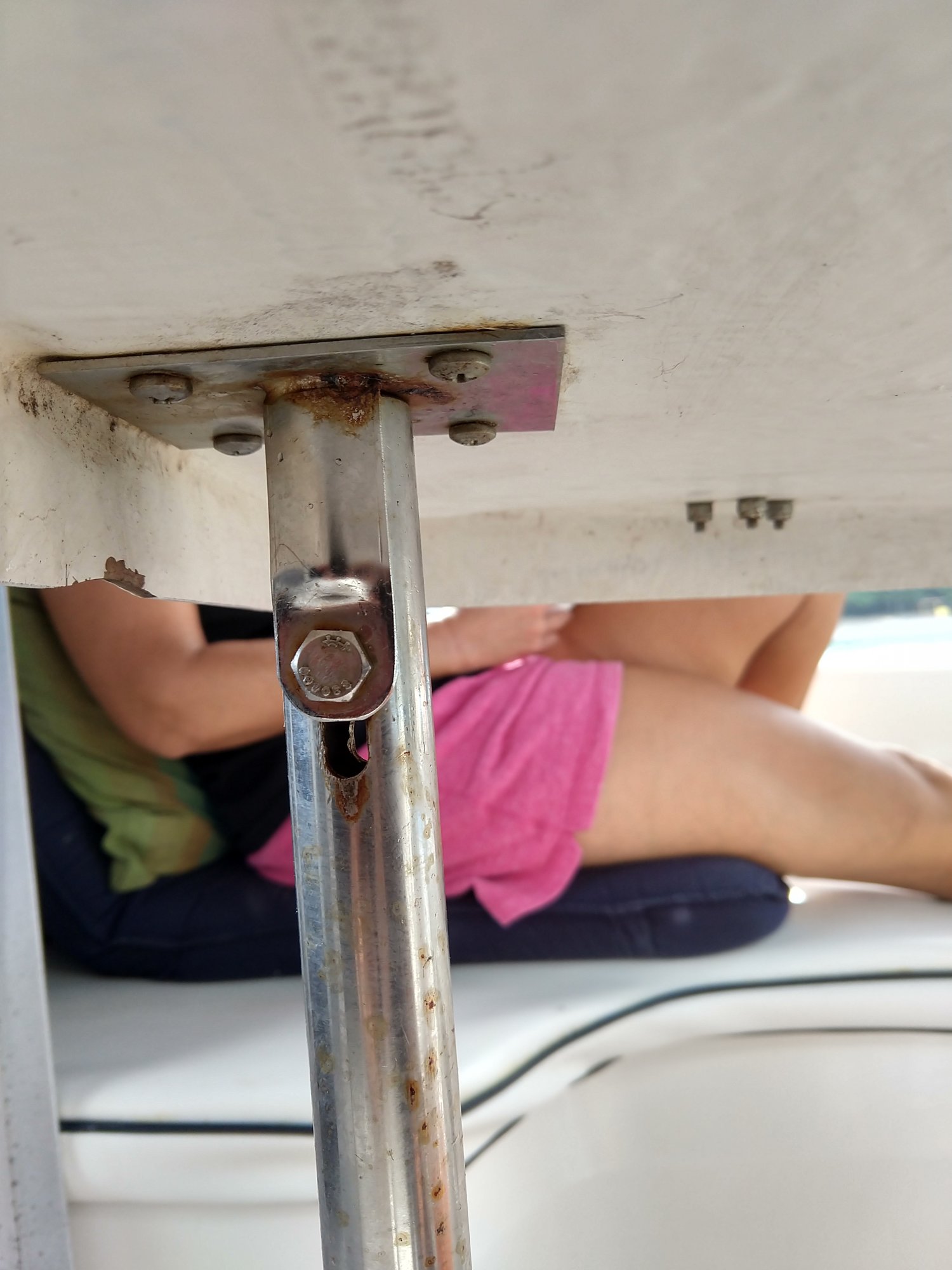

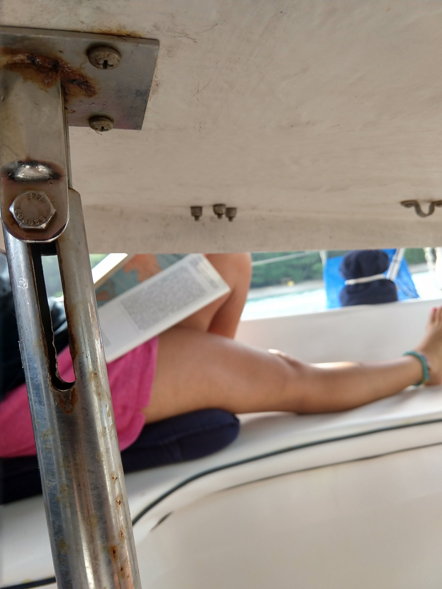

This is our factory leg.
The second pic I lifted the table to show the slot. When you fold up the table you move the leg down the slot so it has room to fold up under the cup holder.

Thanks @JK_Boston_Catalina310 , the leg has to angle under the cup holders for my table to go back flat for stowage. I thought maybe it would fit folded up inside the table lip but the leg seems too long.
