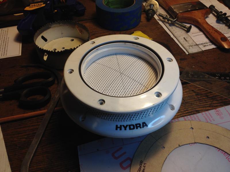

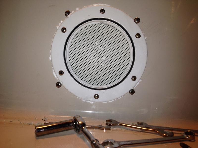

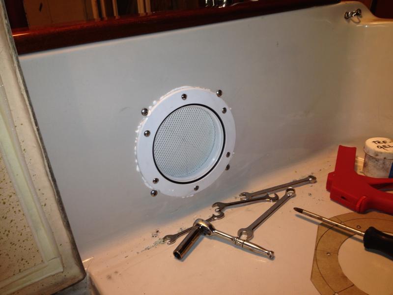

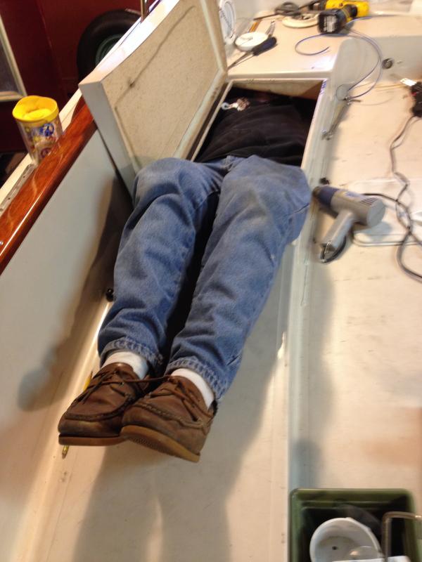

I had 2 access ports already installed for access to cleats and not wanting to cut any additional holes, I mounted speakers behind the ports.
The 4 outside holes were for the speaker mounts. Tighten these evenly and gently to avoid distorting or cracking the speakers. The inside is out of view, otherwise I'd have figured out some covers. I like the plastic bowl idea, if covers were needed
Nice to have water proof covers when not in use. I since have added ball chain to the port covers to avoid loosing them. Almost visible in the last photo.
Installation did require some "boat yoga".
robj
p.s. the squeeze-out was later trimmed.

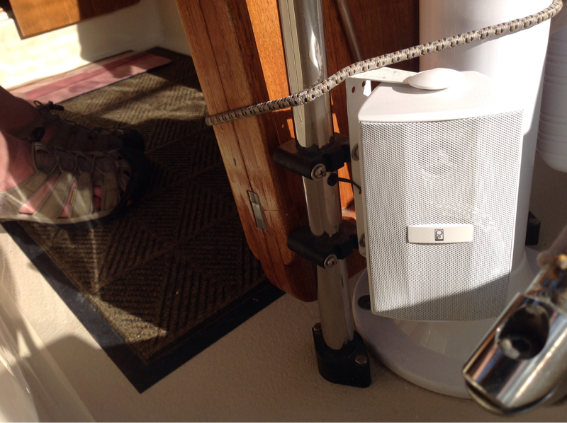

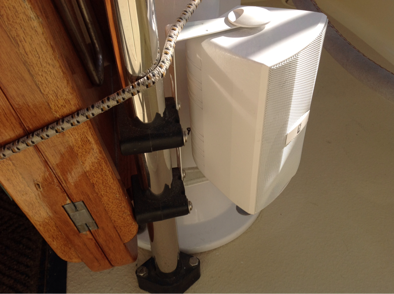

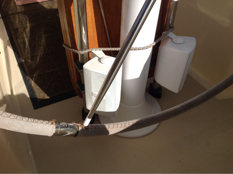

Take a look at my post earlier. I mounted box speakers to the pedestal guard. The only hole is for the speaker wire run down through the guard.
