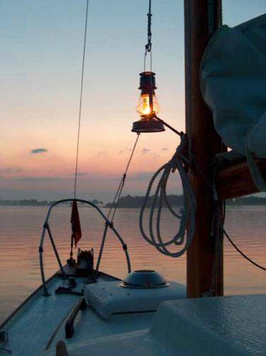

Mar 1, 2012
2,182
Used to use a kero lantern- worked fairly well, BUT means you need to carry a LOT of kero if cruising. Replaced it with a BRIGHT LED unit from the now defunct Bebi Electronics in Fiji. Been 8 years now and still working great. Got boarded on night -the officer wanted to know where it came from because it stood out better than any other. Bebi is defunct because the Fijan Government sot of forced them to leave- long story.
Here's the kero, in an anchorage in Bartaria,Louisiana
